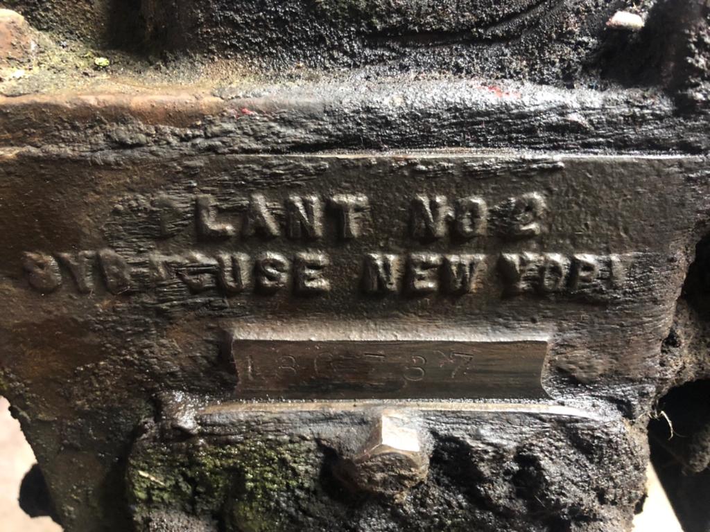

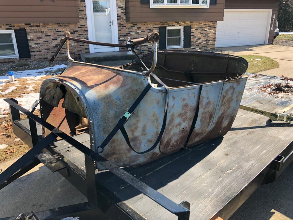

    Hey, long time lurker 1st time builder. Recently picked up a 1914ish dodge truck roadster body and this 1926 T doodle bug this past weekend. Currently removing the large truck rear end in hopes to swap to a car rear axle. Hoping to utilize the t power plant as my goal is pre WWII build. The motor vin checks out as April 1926. The divorced trans says “plant number 2 syrcuse new york vin #130737. It only shifts foreward and backwards like another low and overdrive? Prob will be removing that divorced trans as well and looking for more options to transmission possibilities. I know ill be asking a ton of questions along the way so please be patient with this noob. [​IMG][​IMG][​IMG][​IMG][​IMG][​IMG]

    Might actually be an Overland body

    Has the same windshield posts and rear side panels like this 1914 dodge some other fellas helped ID it on another post that i had. IMG_4529.JPG
    The id code on the fire wall lines up with sone early dodge numbers ive been looking up as well. But might be mistaken im no expert by any stretch of the imagination

    The number on the firewall has nothing to do with serial numbers or the year. It is indeed a Dodge Brothers TOURING car front half. It is later than 1914 because first of all there were only 250 built in 1914 so finding one is extremely rare. Also the early cars didn't have hood lacing slots on the cowls and yours for sure does. The teardrop speedo hole and the glovebox narrow it down as those changed a little later. Those doors were last used on 1919 DB tourings so that sets the date before 1920. DB quit having the glovebox in 1917 from serial number 159101 overlapping to 169913 which translates to 1st of June 1917 to about July 15th 1917. 1914-15 had a 3 gang lighting switch on the left upper side which had a square hole in the dash and I can't see it but I assume it has a slot for a sawblade like choke pull on the left side instead of a round hole for the later choke plunger so that makes it between Jan 1st 1916 and April 30th 1917 since it has the round lighting/ign switch hole. The diameter of the windshield post where it goes through the cowl could narrow it down a little more. They got bigger every year or two. I'm talking about the size of the threaded lower shaft that has a big nut at the bottom. This all narrows it down to most likely a late 1916 or early 1917.
    BTW, serial numbers were stamped on the right frame rail and on the toe board on passenger side.
    Hope this helps and isn't too much useless info!!

    The rest of the T is earlier than 1926 as evidenced by the front crossmember, spindles and cowl and the rear end is TT Truck all on a shortened frame. If ya use the T engine and trans you will also benefit from having the auxiliary transmission as the T trans is only 2 speeds. and ya have to hold the left pedal down for Low. With Aux. trans you can have the T trans in High and the Aux in Low for pulling steep hills and High for upper?? speeds! Assuming it is overdrive and a under gear. Some have 3 speeds, under, straight through, and over. Don't use the TT rear end. They are so low geared you can almost walk faster than that!

    Thanks everyone for the new insight on whats here. Im in the process of removing the TT truck rear axel. Under all the grime i found that the aux trans is a Warford. I might keep it? Depending on what it is. It there a way to tell what gears it has in it? Should i be sourcing a T rear end or can a model A rear end be put in the back so i can utilize better rear brakes.
