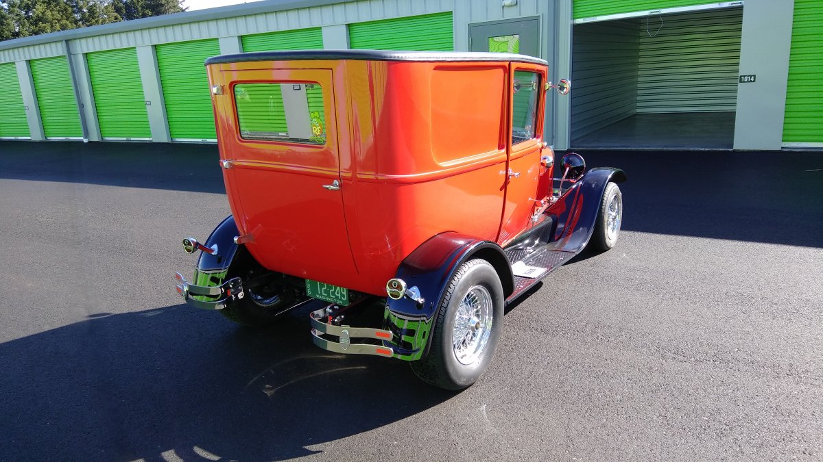

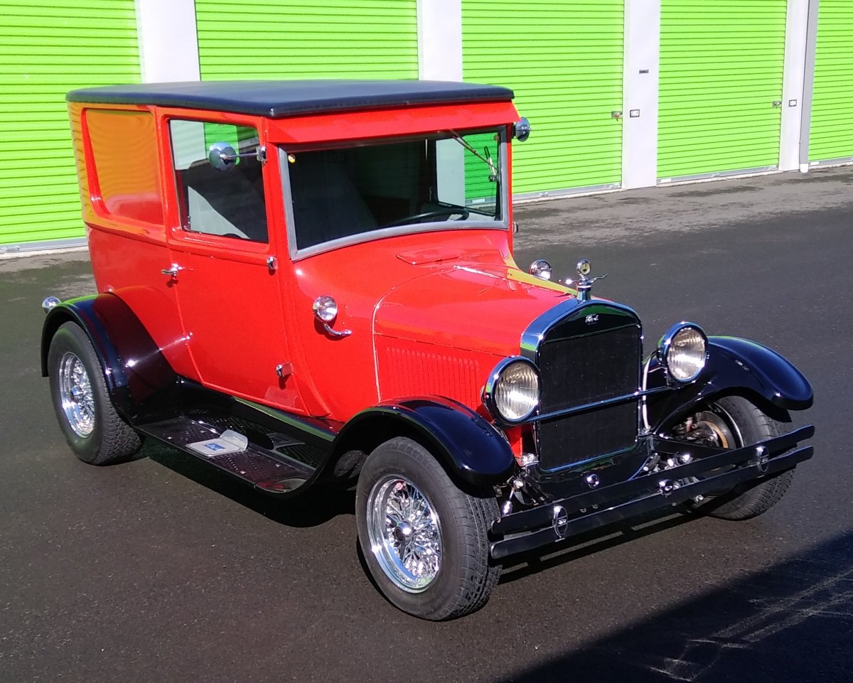

  4. Richard Jones
    Joined: Aug 30, 2015
    Posts: 9
    Richard Jones
    hfh, uncleandy 65, Deuces and 19 others like this.
  5. WOW! That's a good looking car. I'm no help on finding info on it, but it's sure nice. All steel?
    OahuEli, Deuces and brad2v like this.

  7. Richard Jones
    Posts: 9
    Richard Jones
    The body is all fiberglass as well as the doors and fenders. Only the hood is steel.
    Overall I'm pleased with the car. Just curious as to who made the body.
    It sits on a custom frame, 3 " dropped axle, 9" Ford and 4 wheel disc brakes. A Buick V6 (even fire 231 cu.in.) is mated to a 350 Turbo.
