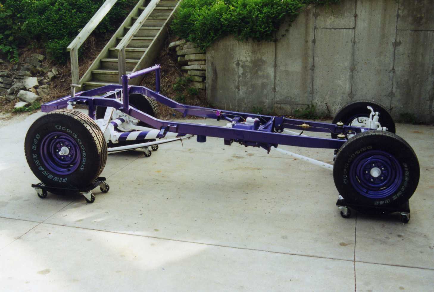

  11. This is the modified I built using 1919 Dodge framerails..
    Lil'Alb likes this.

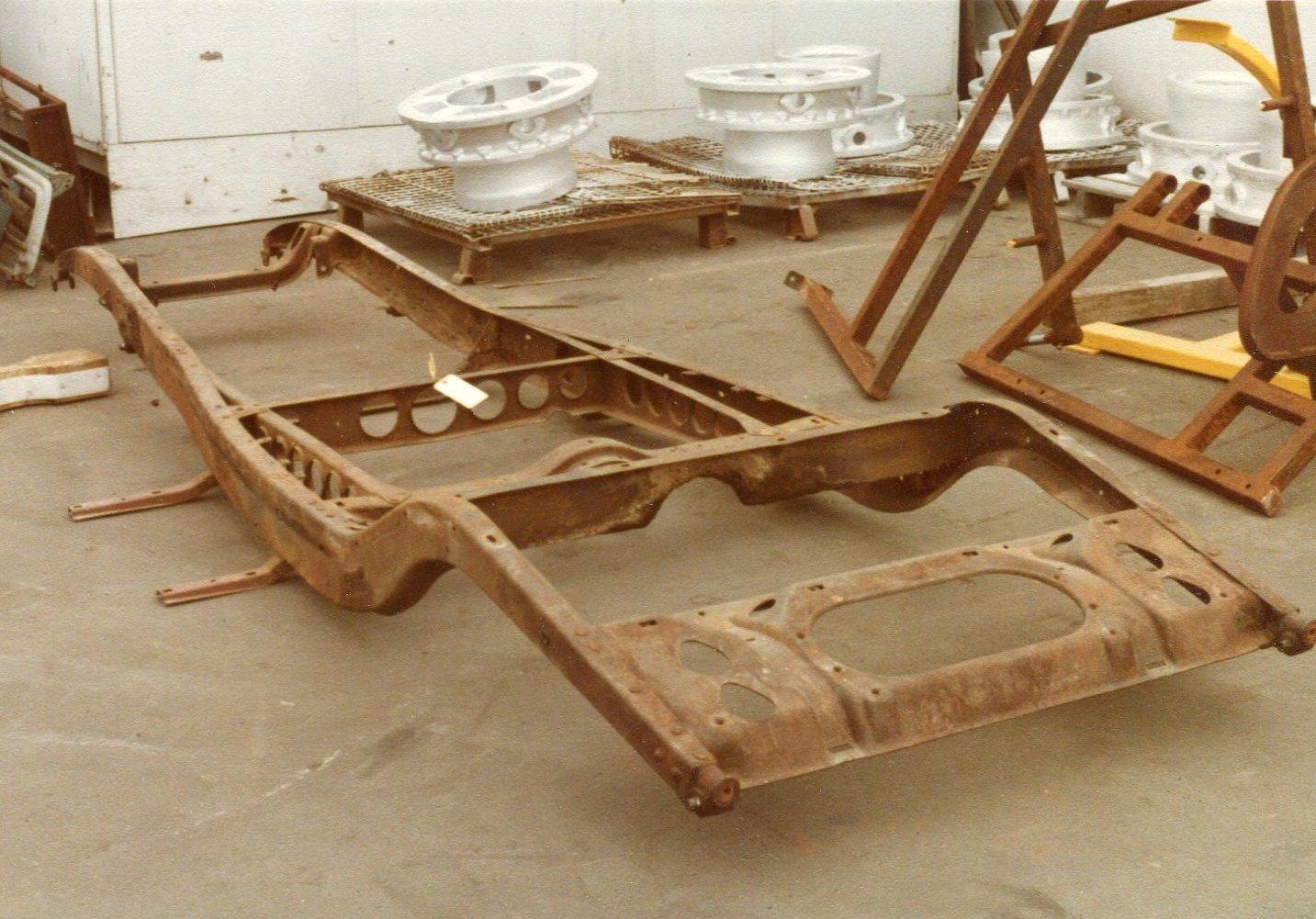

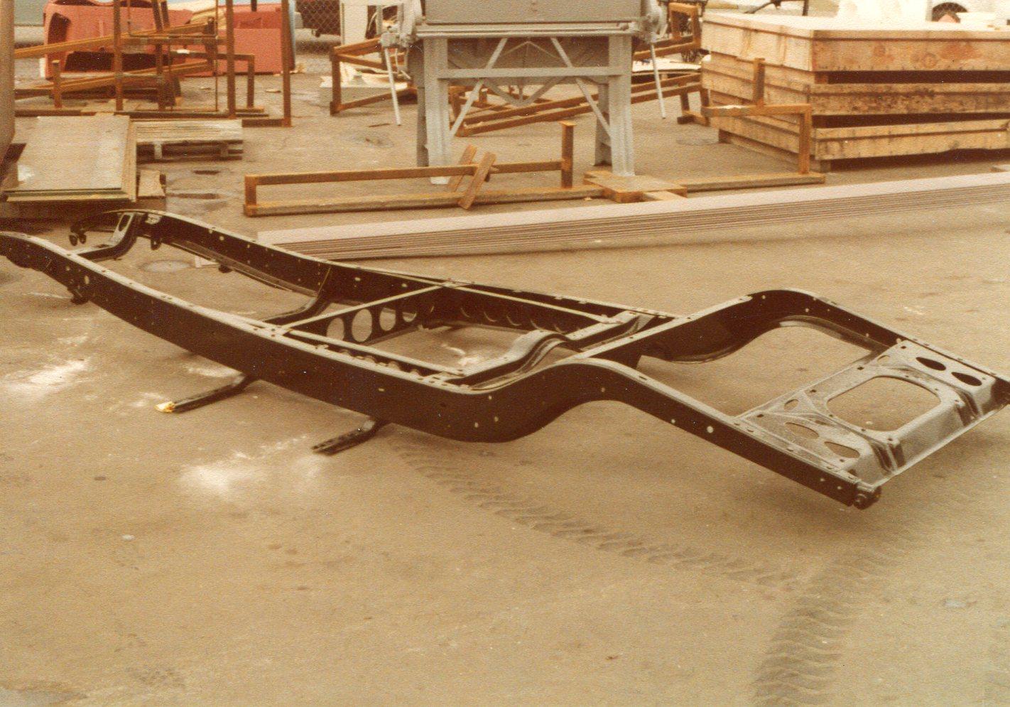

  22. I don't know if this helps, but I have a few photos of the '31 Dodge DH6 frame if needed.

    Man...thats a nicely shaped frame!

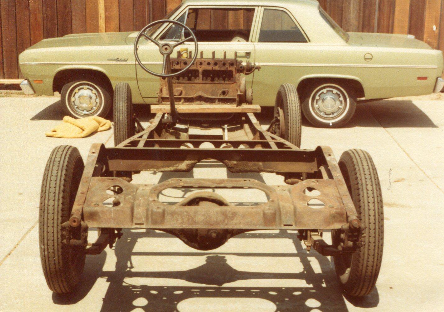

  25. I have a 24 dodge coupe and also have a 27 poliform body on a 25 dodge frame.
    The frame has been pie cut to fit the contour of the body, and it is pinched in the front to the width of the 27 firewall. the front of the frame was bobbed when I got it ,I added a pair of brookville 32 frame horns and 32 front crossmember, and the rear kicked about 4 inches...It is not like a truck frame it is 6.5 high and 2 inches wide and tapers down in the front to 2 inches to the horns,3/16 thick material. Rosette welding up all those holes (72 so far) is a pain.But it was pie cut by my Dad (ATWATER MIKE) and brother so thats not too much work for me.
    It will be a really good looking proportioned highboy when done. Its not that long either.Anyway it just gets trimmed off ,no fuss no muss.Will try to find a pick here or there to add on.Thanks for the boost
