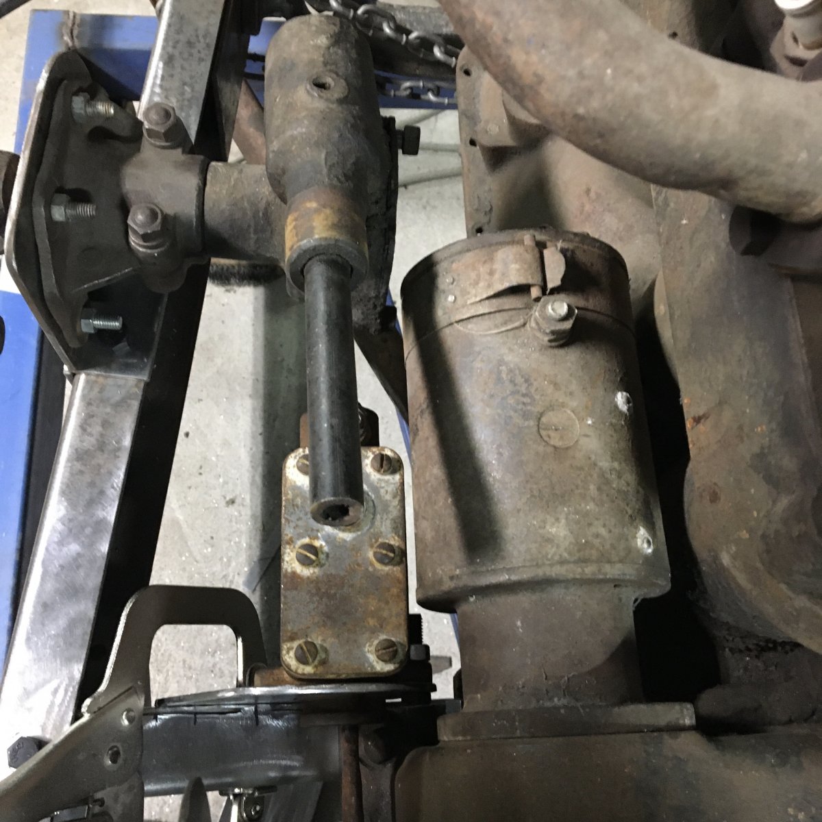

  4. So I jumped around to different parts, one reason was waiting for parts, second I wanted to make sure I wasn't locking things in just incase I needed to change something.
    So once I got the wishbones mount I moved to the steering. I purchased this '27 box 10 years ago from a HAMBer.
    I bolted the drag link up and positioned the box where the geometry was correct. I made a pattern and mimicked the wishbone mount shape (this will be an ongoing theme). I also lined the bolts up with wishbone mounts:rolleyes:

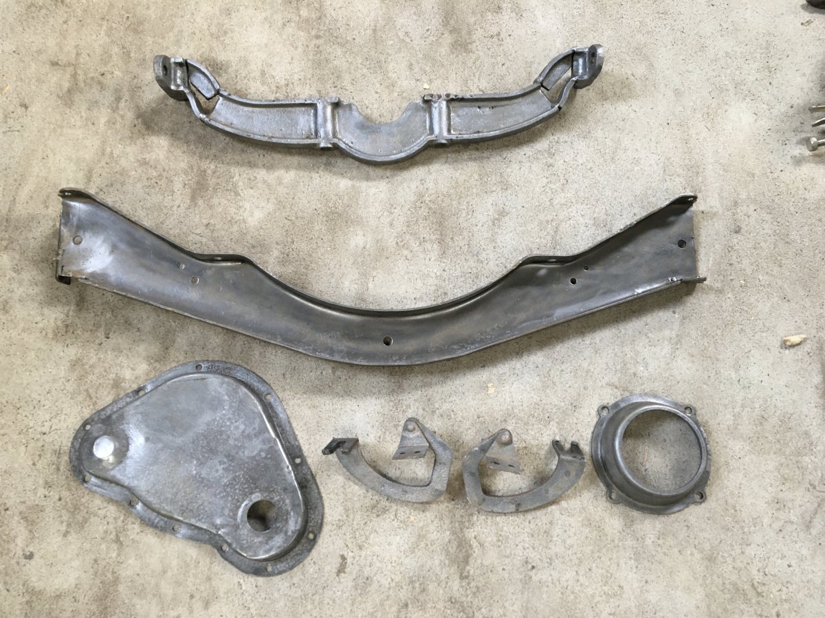

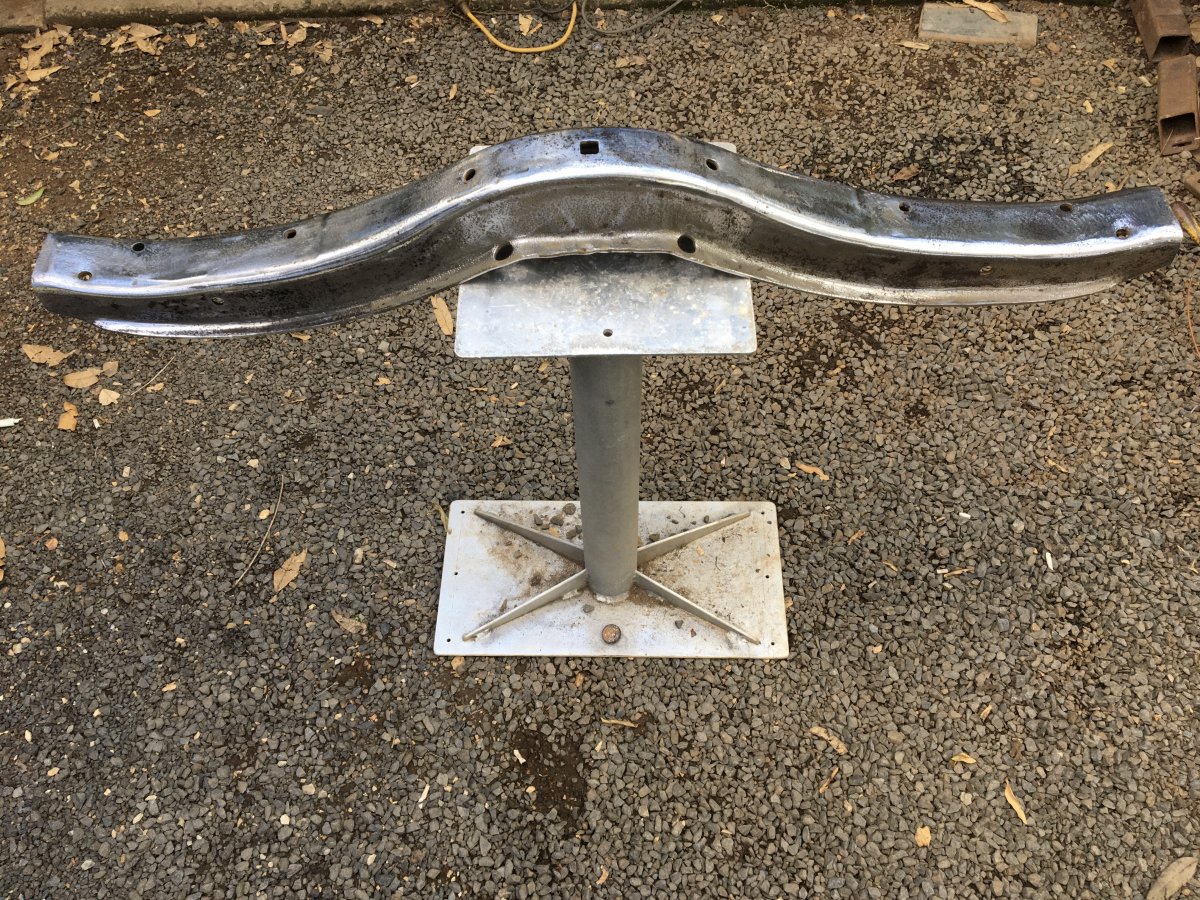

    I purchased this T crossmember from the US last year. Could not locate one here.
    I cleaned it up a bit before I put it in the critic acid
    magic
    Dunked the pedals, when I pull the parts out I hose off & than use water with baking soda which apparently neutralises the citric acid. So far this works and had no flash rust when part drys.
