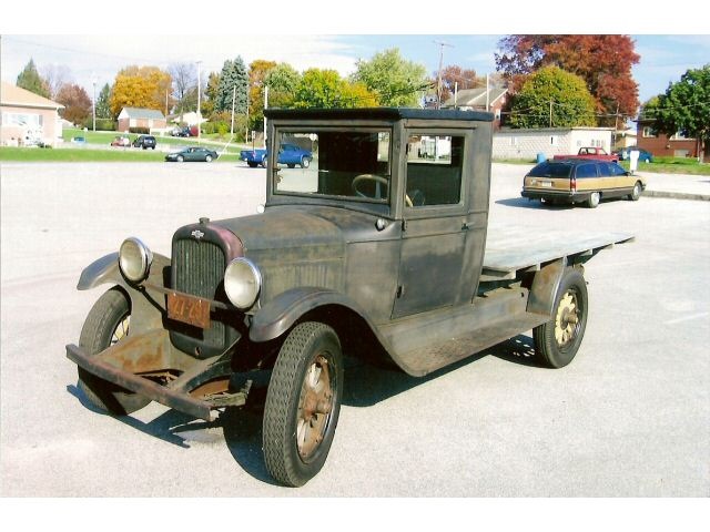

  29. Kume
    Joined: Jan 23, 2010
    Posts: 883
    Kume
    I love flatdecks - this is one of my favourite flat decks albeit largely unmodified - 1928 chev factory cab LP. I think the paint, or lack there of, and the 1930 headlamps make this truck.

  30. austinhunt
    Joined: Nov 26, 2011
    Posts: 533
    austinhunt
    Thanks redzula! I'm really struggling with welding the corners. I almost always burn the last 1/8".
    Kume that truck is really cool. I really like the early chev's. I'm think I'm going with a box. Supposedly there was a Graham Brothers pickup in '24 but there aren't any known survivors... Till now!
