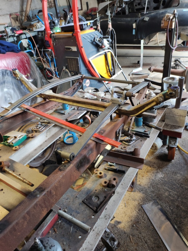

    So since I started my A RPU I decided that it was time to really start on the special also because why not?
    Some of you have seen pictures of a quick mock up for it before. Now it's taking space in the shop and I need the frame table for something else so instead of shoving it back under the work bench I decided against my best judgement to actualy build it, this build might be faster than the A.
    The plan is to build a race inspired car based on a '23 Zedel CI6 upside down chassis for that underslung look, 50's Chevy front springs, late 20's Citroën C4 I-beam, '33 Ford spindles, F1 steering box, 2.4L Jaguar engine maybe blown via a Constantin blower, LT77 5 speed from a Morgan I believe, a Matford banjo rear or something assembled from a E-83 Ford banjo, friction shocks, most likely '42/'48 juice brakes and a '28 Renault hood with probably a hand made body.
    First order is to modify that Citroën I-beam, I cut the boss and pivot for the mechanical brakes. On the first pictures I had round back spindles on there, they kinda fit, the steering arms clear the beam but I don't want a cross steer set up and don't want something too hot rod inspired, so I'm using some '33 ford spindles.
    The I-beam requiered some modification to fit those spindles with later type Ford bearings. I still need to machine a sleeve for the kingpins, because the Citroën ones were massive. I will need to bend the steering arms though.
    A quick mock up of the Citroën C2 friction shock, originally on the Citroën C4 the friction shocks were parallel to the frame had one arm only and bolted to the I-beam on that big fat bolt next to the kingpin. It looks too bulky so I place my shocks parallel to the frame with a C2 rear mount as my front lower mount and on top of the spring what I believe is a Peugeot 203 pick up rear end spring hanger as my upper mount. I'm thinking it could double as a headlight mount also.
    I need to fabricate the mount for the Jaguar spring shackles, then the front springs will be done. For the front I made a spreader bar threaded on the inside to act as the blower support and for the front of the spring bolt to bolt into.

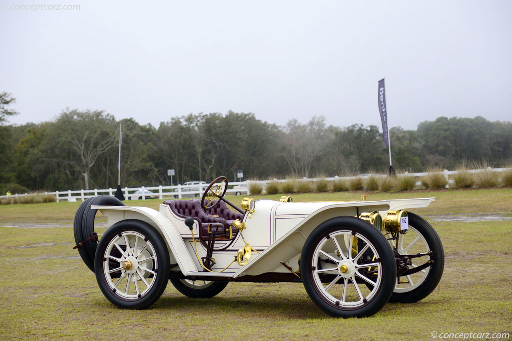

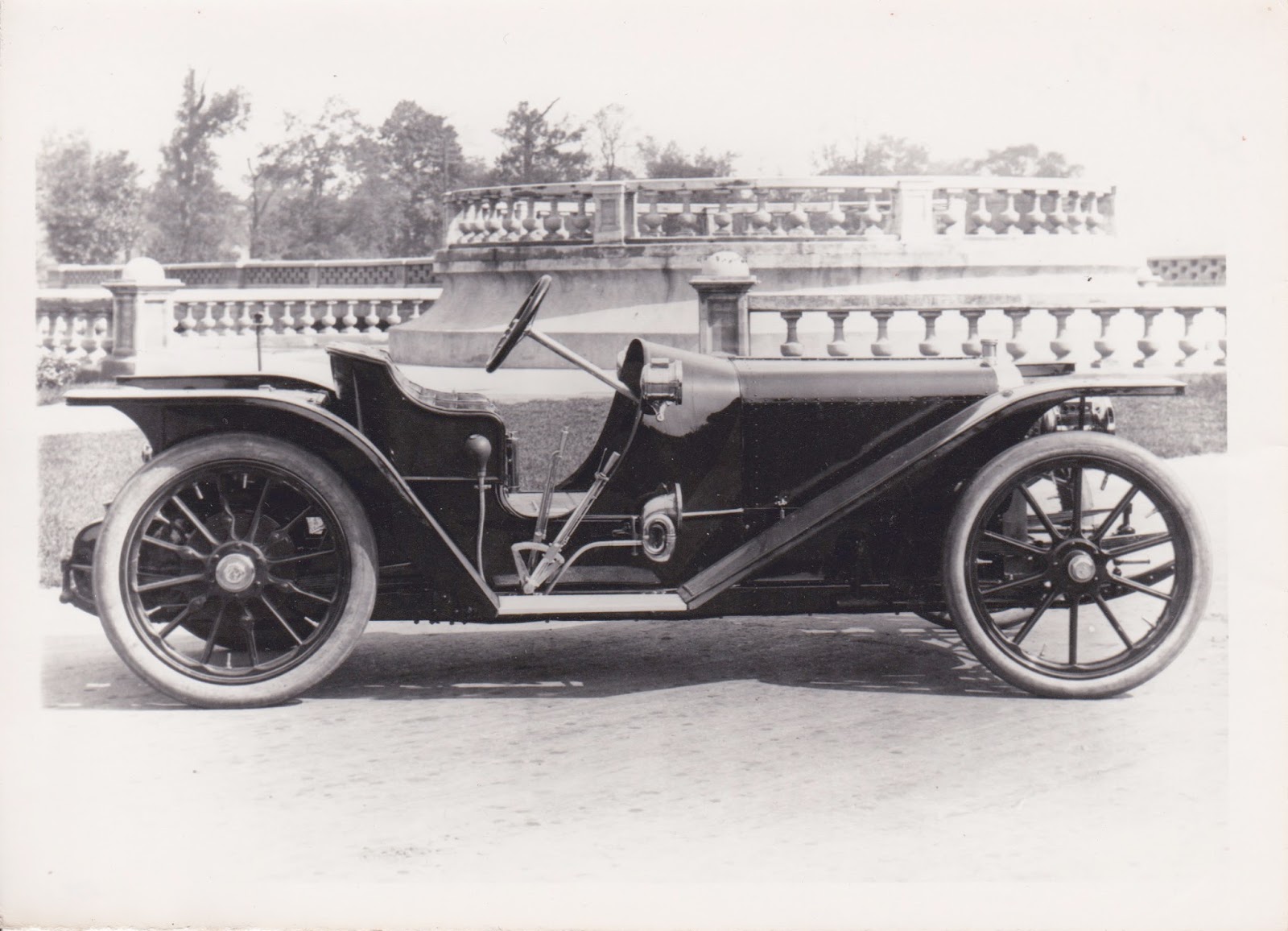

    The American Underslung Automobile was built from 1905 to 1914. I've got to agree that it takes a big diameter wheel to carry it off.
    The Chassis shot shows that they had what amounted to an upside down C notch in a pretty straight frame to carry itoff.
    Both the white and black cars are/were 1908 50 HP cars.

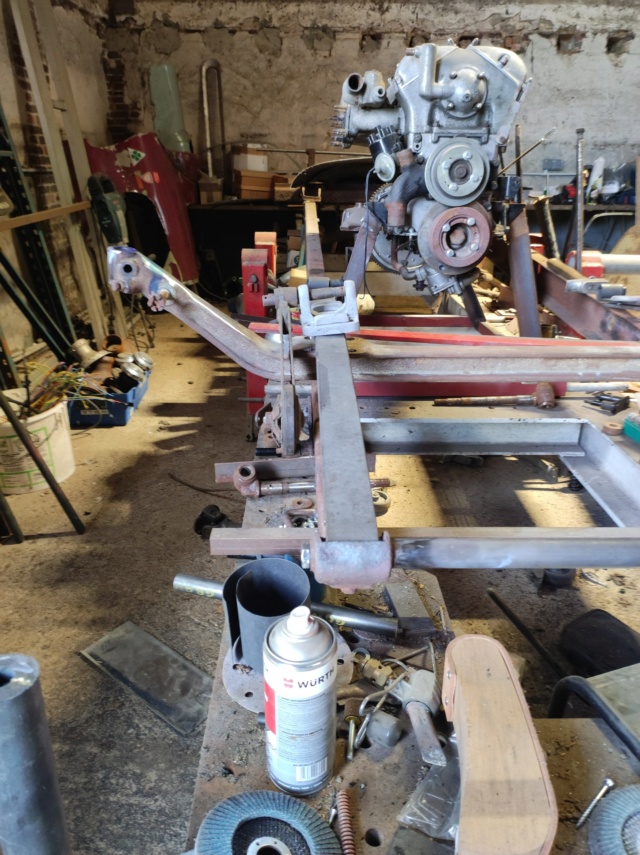

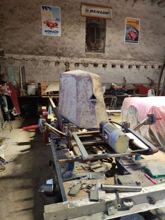

    Finally I'm done with the front crossmember, for now it's bolted in, will be riveted when the frame is done.
    It's a really tight fit but I wanted to be able to place the engine as much forward as possible which isn't that easy with that suspension and hood.
    Here's how it looks like with the hood

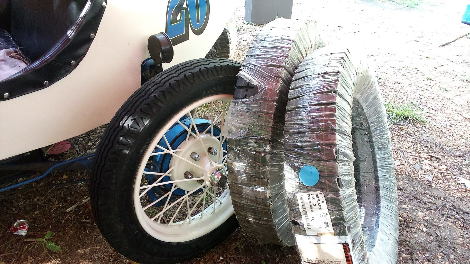

    And I found some 23" wheels. Not disc wheels but the next best thing.
    They're 5 lugs and I will need to redrill my drums for them to fit.

    What are those 23" wheels from?
    Stogy likes this.
  28. chrisp
    Joined: Jan 27, 2007
    Posts: 1,238
    chrisp
    I believe they are British accessory wheel. I don't remember the brand, but it's stamped on them.
    The older gentlemen I bought them from used to have a Vermorel but he never got to mount them on luckily for me.
    He didn't know exactly how to measure them but I took a gamble and bought them without seing them in person. Let's just say it was an excelent deal worth the risk compared to what they go for in the UK.
