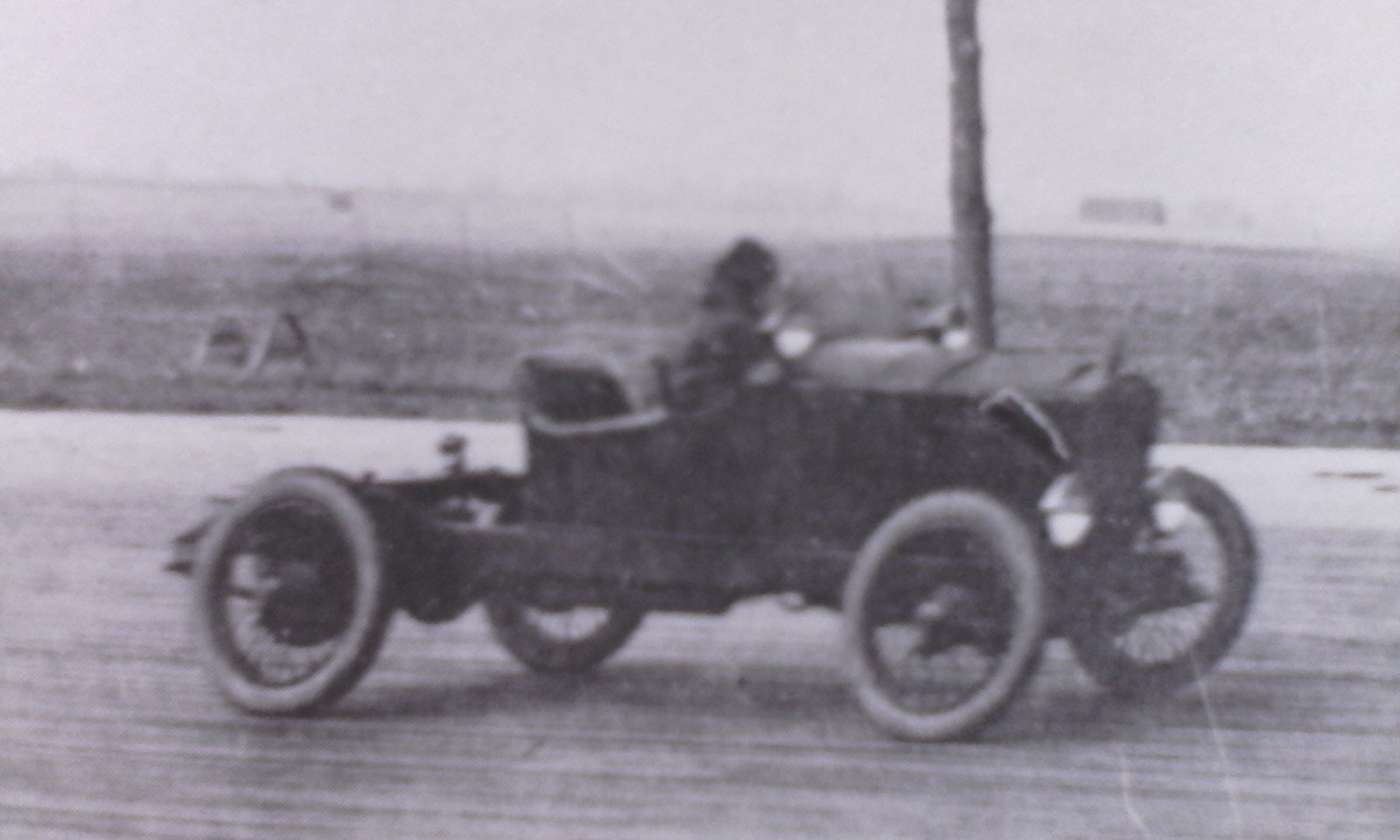

  24. IMG_20150122_171719.jpg 1919 Essex Racer at Cincinnati Speedway.
    Demonstrating the cars durability and performance, 93 hours was spent doing tests, during that time a distance of 5,870 miles were clocked up under AAA supervision.

    I had not heard of the 93 hour test only the 50 hour one of 3047 miles an 60.7 MPH. Your numbers would be a little over 63 MPH. And that would be over 10 Indy 500s back to back. These must have been some car for the time.
