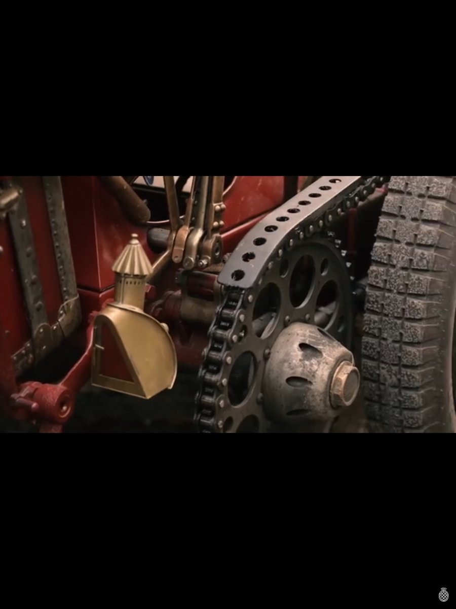

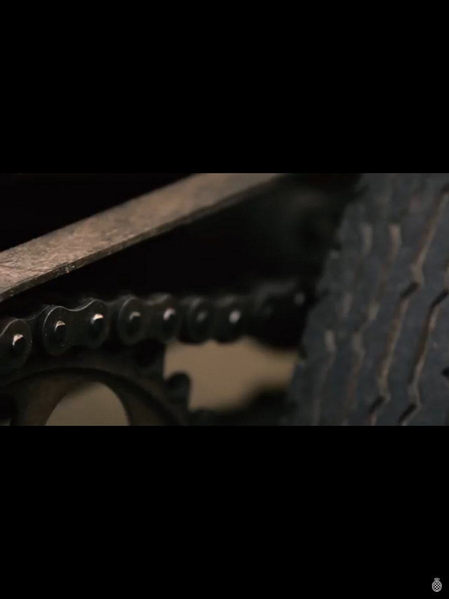

    Some snap shots off vids from Goodwood of their “chain guards”. Lol! These guys have balls of steel to race those machines.

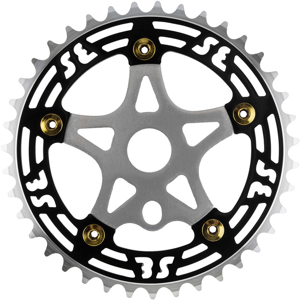

    A 40 tooth front sprocket would be doable. I planned on using idlers to set chain tension but now im thinking of making slots where the ubolts for the rear leaf springs go which would allow the axle to be adjusted fore and aft.
    Love the rigs at goodwood. I hope i can afford sprockets that look as cool as the lower one.

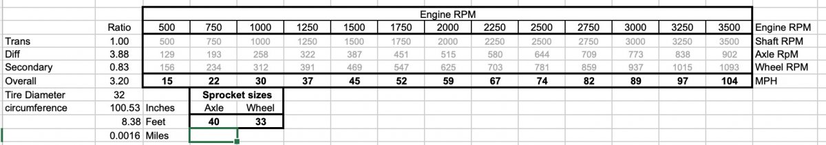

    Thor1 and RodStRace like this.
  8. RodStRace
    Joined: Dec 7, 2007
    Posts: 4,057
    RodStRace
    Those numbers look better!

    The front 40 tooth sprocket is available for $189 from usa roller chain. Ill still have to bore out the center and drill bolt holes but atleast its available.
    My rear sprocket will have to be the custom one.

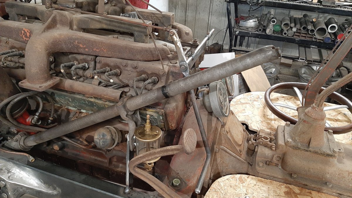

    Anyways I started getting the 20210103_163211.jpg 20210103_163226.jpg 20210103_163236.jpg cockpit together.
    The 28 plymouth Master cylinder im using needs a remote reservoir and I always thought an oiler would be perfect for it. So i scored one this weekend and it got me energized to figure out my steering column mount and gas pedal so I could see it in place.
    I toyed with a bunch of gas pedal designs in my head before I finally settled on this one and I love it. It's simple and comfy. I may put a slight bend in it but not much else.

    Got my steering column extended and the steering wheel mounted!

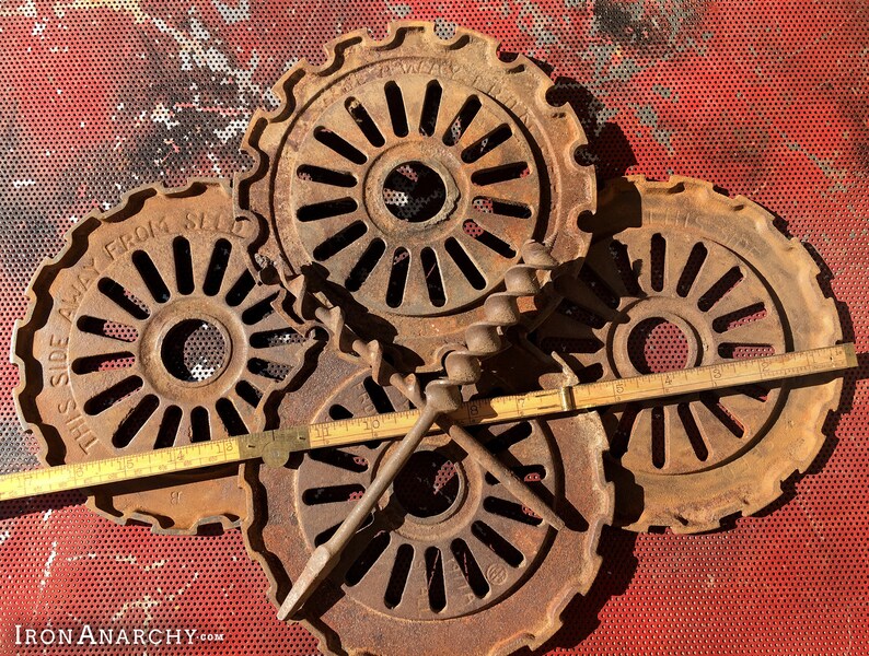

  16. In case it matters those cast pieces in the iron anarchy picture are seed plates from an old corn planter, you can read - this side away from seed- on the plate on the left. Newer one were made out of plastic. Not sure that is anything you want to incorporate into a drivetrain.

    Sumbitch, I knew I saw them before. They take a flat chain like a manure spreader too don't they?

    Seeder plates will definitely not be used on my rig

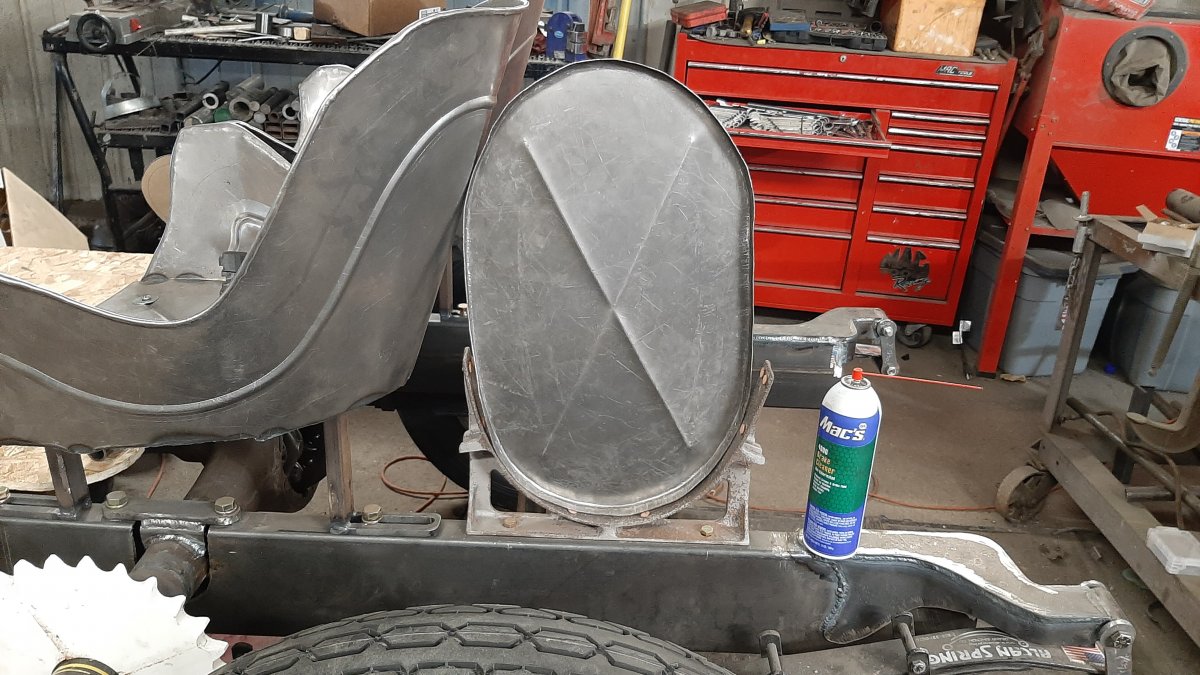

    Also started on the gas tank.

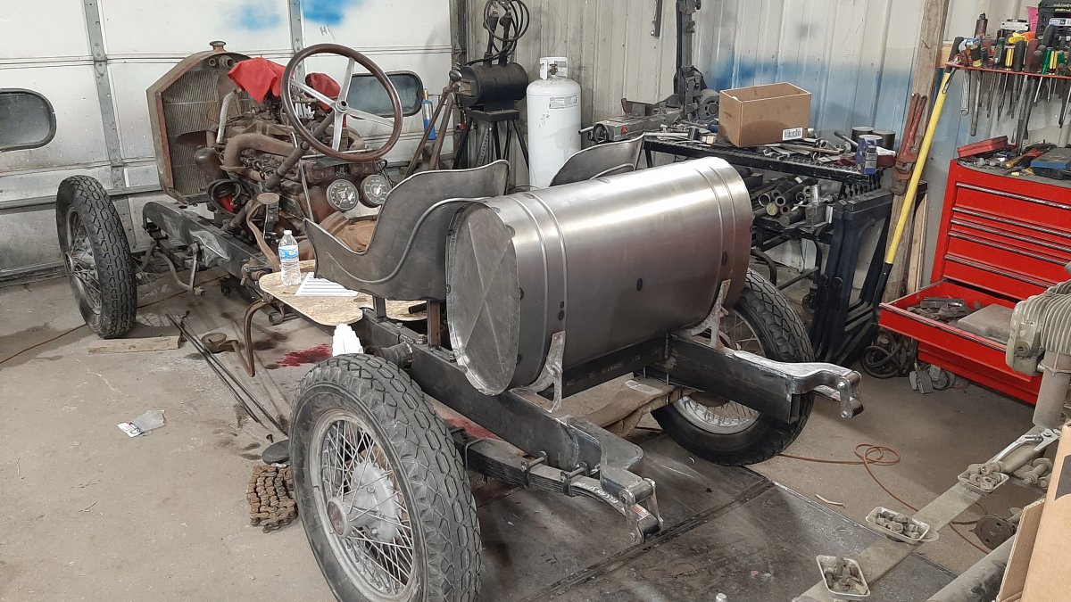

    Got the tank tacked together tonight.

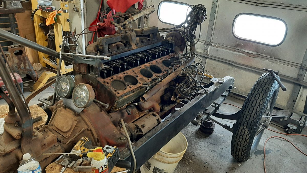

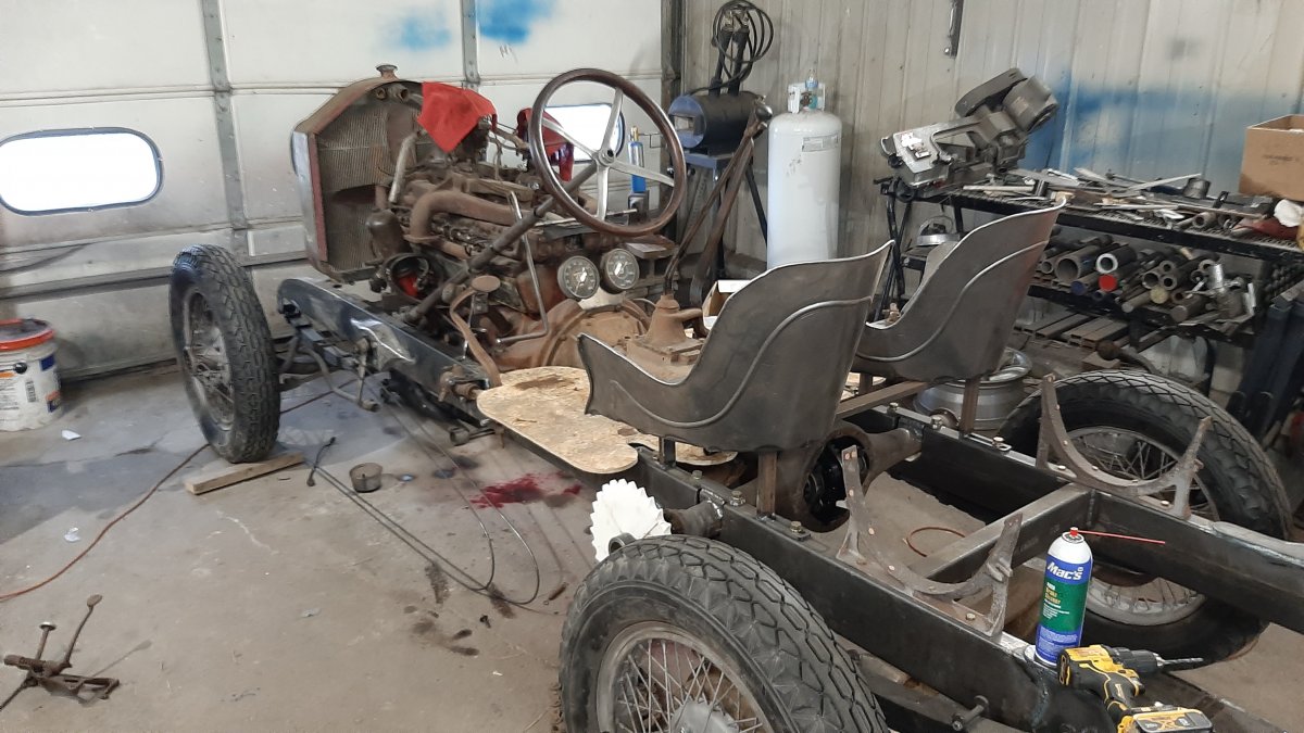

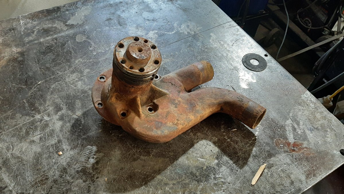

    I dug into the engine today and found a cracked piston. On the plus side of the day I blocked off the second outlet on the water pump.
    And really it is time to start teardown to complete welding 20210117_135355.jpg 20210117_134710.jpg 20210117_134455.jpg 20210117_145852.jpg and to get ready for paint. Ill keep the rear chassis together untill I figure out the chains

    Pulled both heads and found nothing else to be concerned about. The bearings miced out in spec and the cylinder walls look damn good so im just gonna hone the cylinders of the 2 pistons I removed and reassemble when I find my new piston. 20210119_133006.jpg 20210119_133006.jpg
