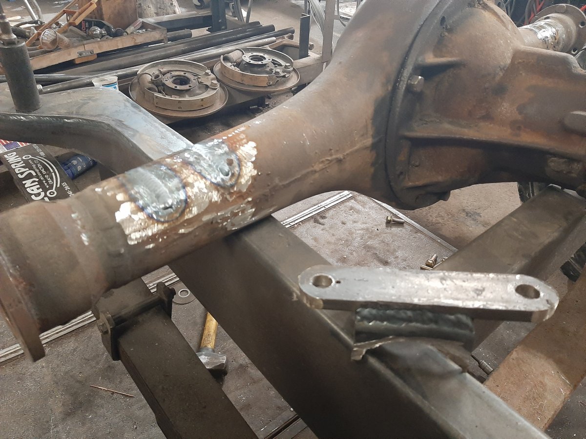

    Got my u bolts today so I'm able to start on my spring mounts. 20201125_171755.jpg

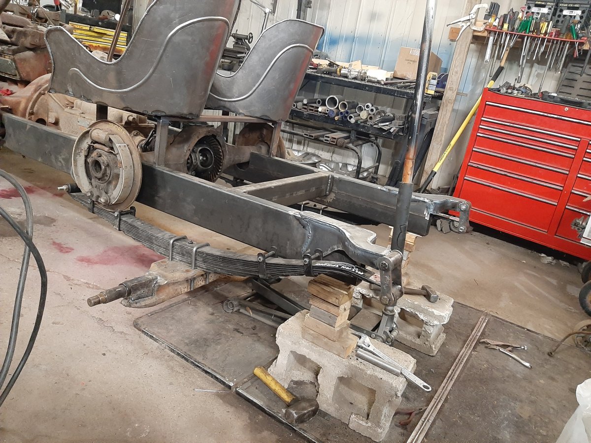

    REAR SPRING MOUNTS ARE FULLY MOCKED UP AND THE BEAST OF THE VALLEY IS SUPPORTING IT'S OWN WEIGHT FOR THE FIRST TIME EVER!!!!
    It's like seeing your child stand for the first time LOL.

    Today I got the chain drive mount brackets hashed out.

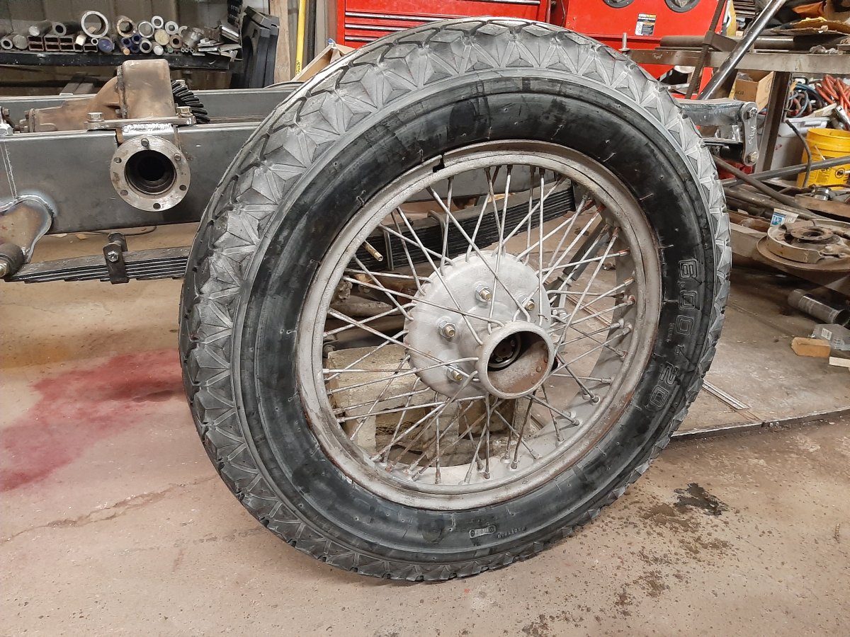

  16. Stogy
    Joined: Feb 10, 2007
    Posts: 26,348
    Stogy
    @animal8324 as a matter of concern those cinder blocks are worrisome as supports, even 6x6s, 4x4s or 2x4s solidly tied together with no hollow spots in approx 10"x 10" or more to eliminate tipping would be safer...adding the fact this is a weighty beast. I want you to enjoy the fruits of your craftsmanship which is like so many here...darned awesome...thanks for sharing your interesting journey in go fast...;)
    There is a very good Thread on homemade stands...I will see if I can find it and post a link...
    Update...I did a search and what I was thinking of is called cribbing which seems more a tires on support rather than a jack stand which is actually not what you require. You could still use them under the frame shimmed with additional added wood to suit but good robust jackstands may be the best answer...

  17. 64 DODGE 440
    Joined: Sep 2, 2006
    Posts: 4,422
    64 DODGE 440
    from so cal
    Also before you get too locked in, the pinion is usually below center of the axle so that may need attention.
    41 GMC K-18, seb fontana and loudbang like this.
  18. animal8324
    Joined: Sep 28, 2012
    Posts: 136
    animal8324
    from nj
    I could always just run it in reverse lol.

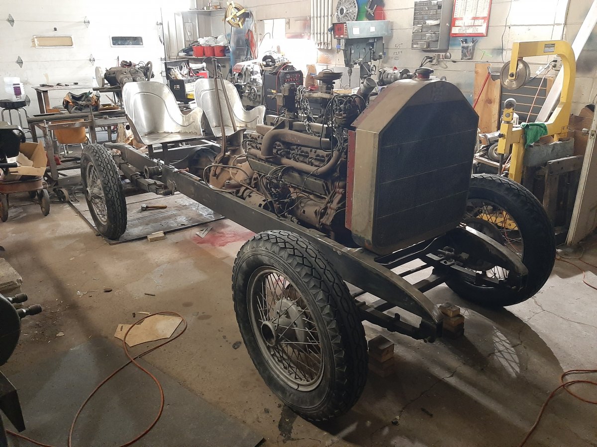

  30. animal8324
    Posts: 136
    animal8324
    from nj
    Back to progress.
    Wheels are on.
    Seat bracket is coming together
