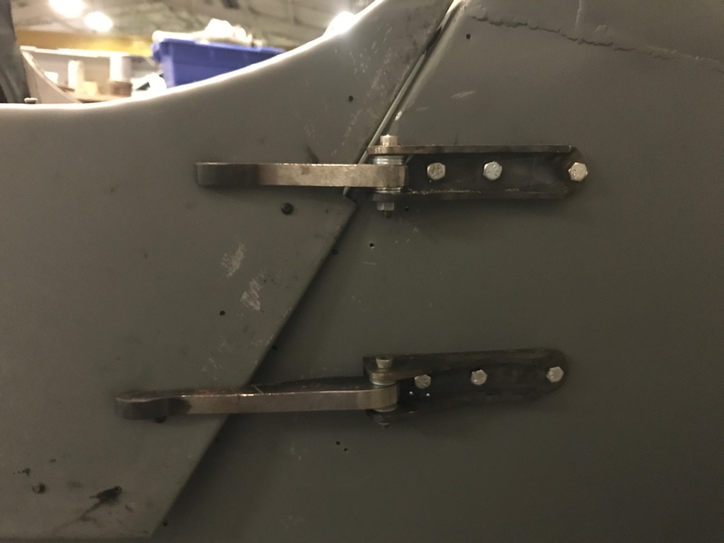

    Small progress again. I just wasn't happy with my door hinges. Took me a little while to come up with an idea that I was happy with. May get the doors fitted up to the body today with sheet metal... May be the key word!

    And a good day making. Got the other hinges fitted up. Made the metal door frame for the door skin and managed to get the door skins made.
    I think the hardest thing was not installing the metal parts on the wood frame. But I want this thing to last longer than it has taken to build it, so I put all the parts into epoxy primer first.

    Well. A lot of things have happened since my last post. Don't know how long I can stay on it this time, but I'd now have the doors hung were I am happy with them. Latches are mounted. Very little work left before body work can start. [​IMG][​IMG][​IMG][​IMG][​IMG]
