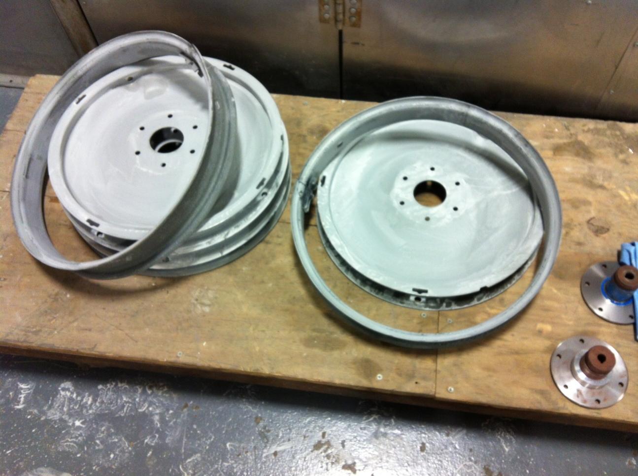

    Some more progress tonight. Blocked my wheels again and ready for the third coat of primer then on to paint. The rims needed a little work. One of the rim locks was broken when I received it. Made the missing piece and welded up some holes. Got two of the rims blocked.
    I also machine my hubs to have a very small step in them so that the disc wheels will center on the hubs and not the bolts. I didn't want to take off very much...Just enough to seat the wheel.

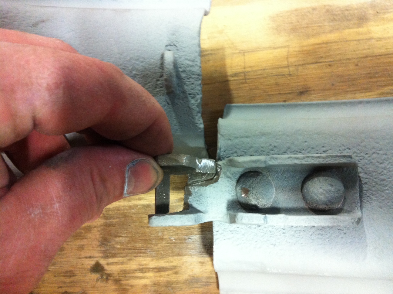

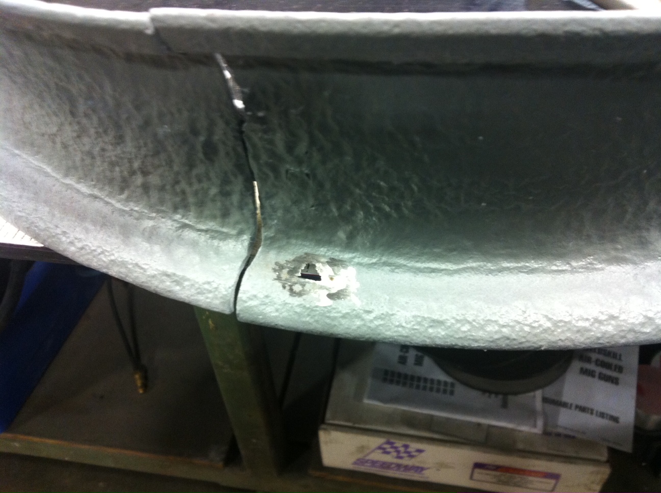

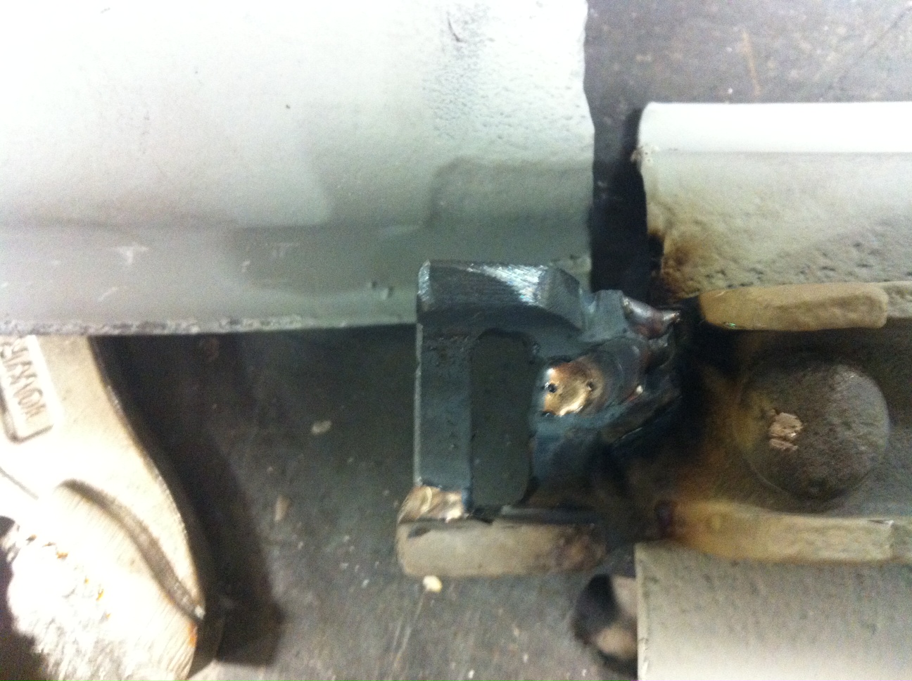

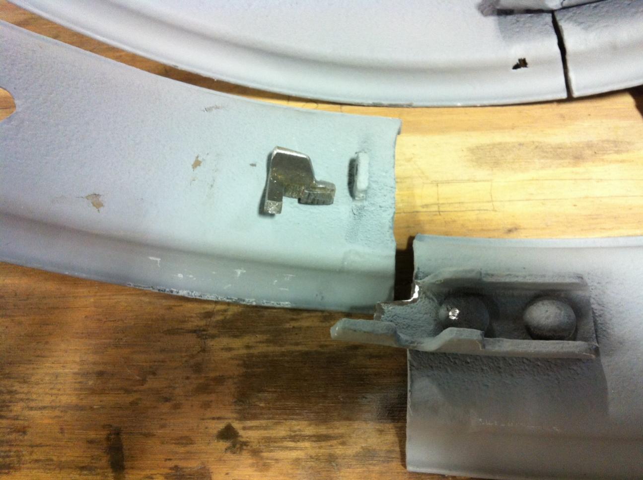

    Got the wheels final sanded tonight. The rims in the final coat of primer. Holes drilled for mounting the wheels to the T hubs. Should be able to sand the rims tomorrow night and get paint on everything.
    Gotta keep up the progress or this thing will take me another 20+ years....

    Got the wheels, rims and hubs painted. Tires mounted. Tires balanced (one of them took 8 ounces of weight.) Went in to the shop today to work on a customers project and didn't have everything I needed so I worked some more on the T.
