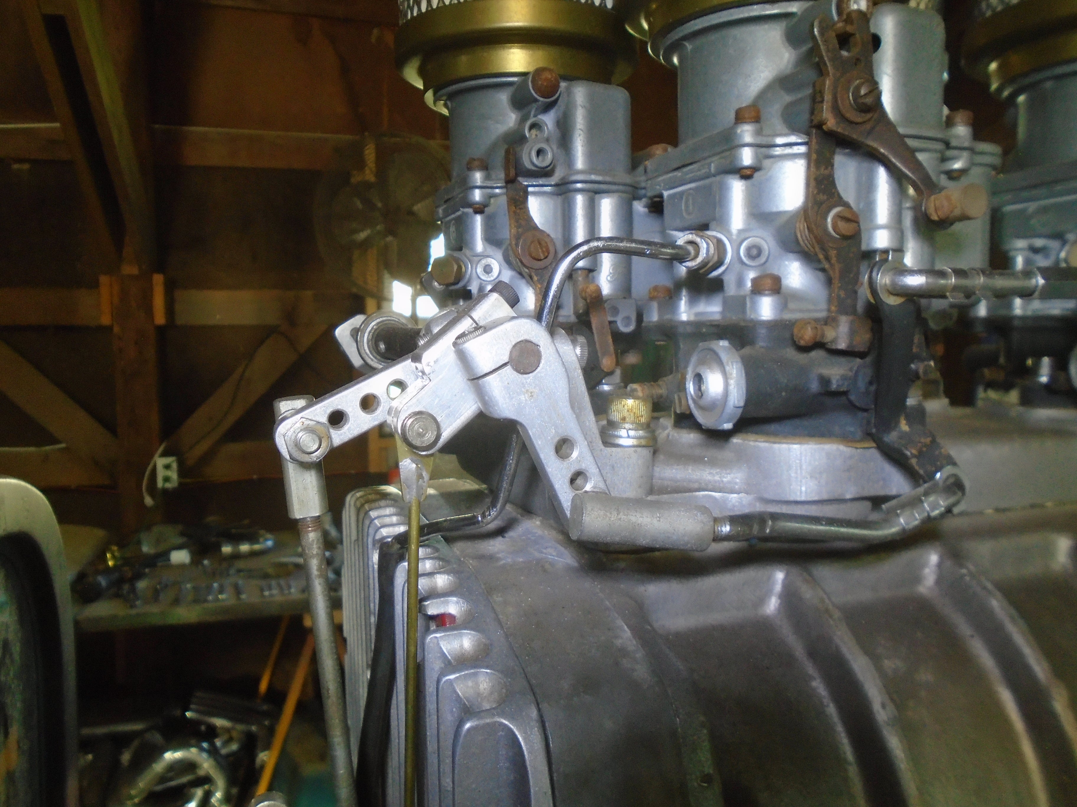

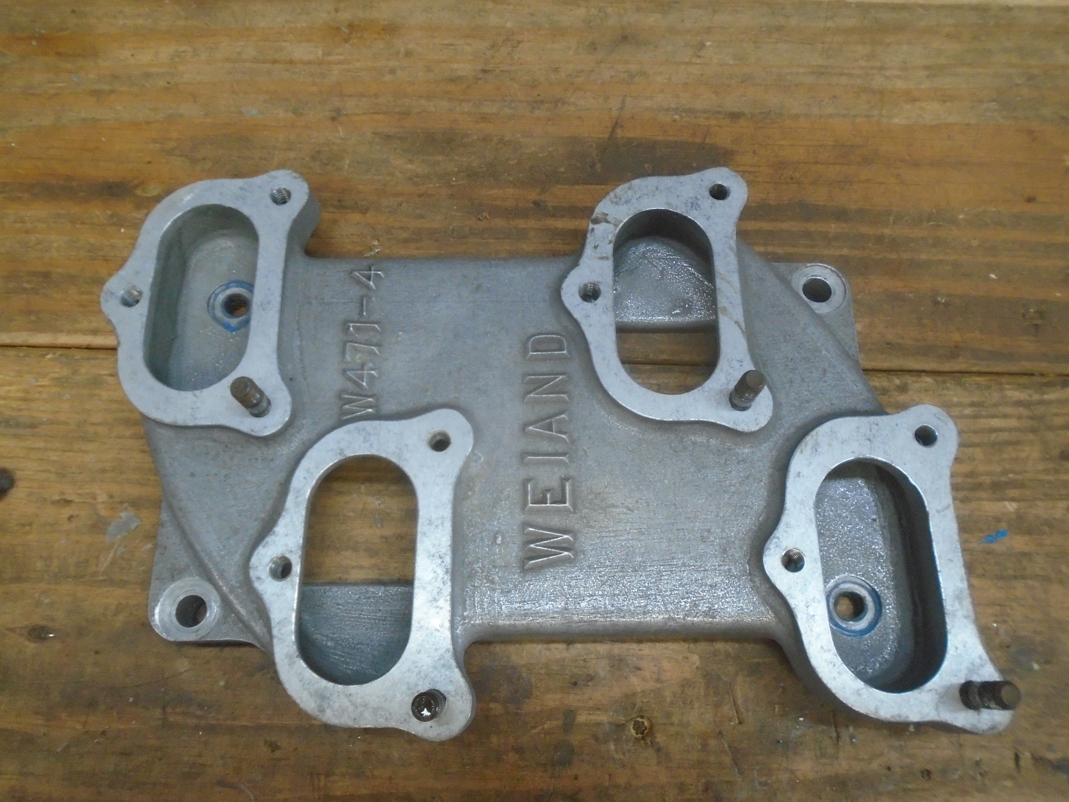

    There are four, Ford model-94 carburetors on top of this 471 blower and each one is rated at 162 CFM.
    These are 2-barrel carbs and this model was manufactured between 1938 and 1957.
    The two carbs on the right side of the manifold are linked together so they open and close at the same time and the two carbs on the left side are linked together so they open and close at the same time.
    This engine has 280 HP stock and for the most part, driving it on the street, just using the two carbs on the right side will be plenty of power to move it down the road with out any assistance from the blower.
    The carb linkage is adjustable for the two carbs on the left side. There is a little chrome clip that goes thru a hole in the red linkage rod. With it in the hole at the end of the rod like this ....
    The throttle can be pulled all the way back and it will not open these two carbs.
    With the clip in the second hole in the red rod like this ....
    Then when the throttle is pulled back, these two carbs open so that all four carbs are all the way open at full throttle.
    When this happens, I would strongly suggest that make sure your seat belt is fastened securely and hang on tight .... cause we be going for a ride !

    I have a power brake unit mounted under the body and when I went to hook up the vacuum line, I realized there isn't a place to hook it up to.
    The small vacuum line for the distributor comes off the port on the carburetor but there isn't a large vacuum port in the Weiand intake manifold on top of the blower.
    You would think I would have realized that before I bolted it on top of the blower and fastened the carbs, linkage and fuel lines all up ... but obviously I didn't.
    So .. it's time to pull the intake manifold back off so I can drill and tap it for a vacuum port.
    The Weiand manifold is bolted onto the blower with four bolts. The left rear carb and the right front carb have a hidden mounting bolt under each of them but I can't get to all of the carb mounting bolts on those two carbs unless I remove the right rear carb first.
    With that carb off, I then have room to use the allen wrench to remove the back center bolt on the right front carb.
    Then I can reach the front inside nuts on the two left carbs.
    Technically, with the left rear carb removed, I can now reach both of the hidden bolts so the manifold could be removed without removing the left front carb from it.
    However, because I'm going to be working on this manifold, I went ahead and removed the last carb.
    Here is what the bare Weiand manifold looks like.
    And a look at the bottom side.
    The manifold is clamped in the drill press to drill and tap the hole in the back side.
    The manifold is re-mounted on the blower and the carbs are bolted back on in the reverse order that they were removed.
    I'm using a chrome plated copper line, that is used for plumbing sink faucets in houses, for the vacuum line.
    Here the first bend is being formed in it.
    The line runs down the back of the blower and over between the oil dipstick and the distributor in the lower right corner of the photo.
    loudbang, Thor1 and brEad like this.
