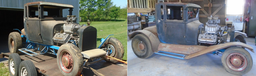

Projects 1915 Ford street rod
Discussion in 'Traditional Hot Rods' started by Retired, Jun 20, 2020.
  1. I like it.........especially with the T fenders and tall roof, even has the correct engine.........will be a great hot rod........andyd
    Thor1 and Retired like this.
  2. F-ONE
    Joined: Mar 27, 2008
    Posts: 2,257
    F-ONE
    from Alabama
    First I like the car....
    Jnaki,
    I believe what’s bugging you, that you quite can’t put your finger on is the same thing that’s bugging me.
    It’s the quarter window.
    We are used to seeing Tall Ts with stock bodies. That body is not stock it’s been made up probably from a Tudor or a combination of Tudor, maybe Fordor and Coupe parts. It looks to me to be....1920-25.
    Again it’s a neat car.
    Thor1, Retired, jnaki and 3 others like this.

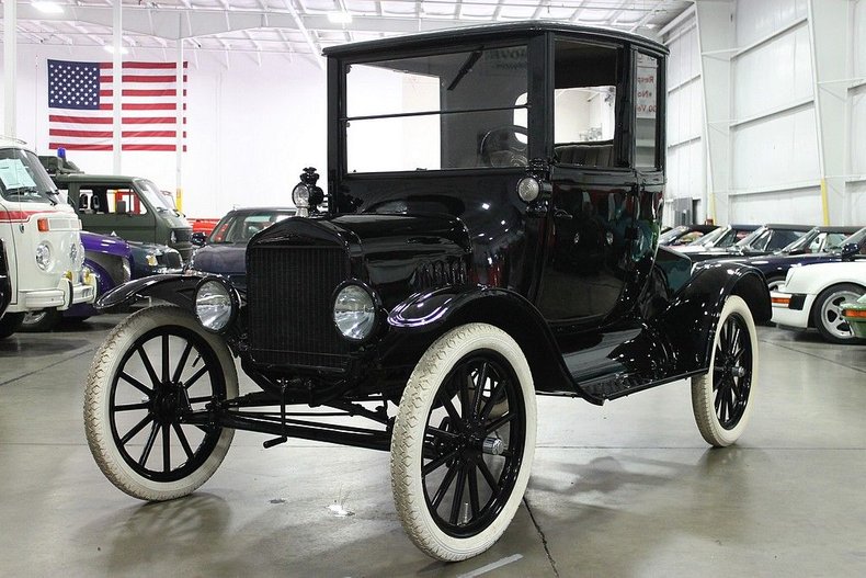

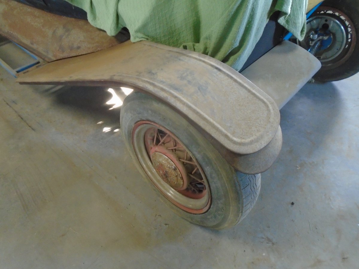

  3. Closest I can find to 1915 are these 1919 models. I'd say the fenders on the car in question are 1915 and possibly the original frame?
  4. F-ONE
    Posts: 2,257
    F-ONE
    from Alabama
    From 1909 to 1927 there’s 3 main groups of Ts. Early Ts (brass era 1909-1915) Mid Ts ( black radiator 1916-1925) Late T’s ( 1926-1927)
    The OP’s car is a Mid T body. I don’t think Ford made that style Coupe in 1915. There was a 1915 Couplet with similar lines but it had a fabric roof like the later Model A Sports Coupe.
    Good catch on the fenders as they do look like early T fenders.
    Many T’s are tagged or registered by the engine. There were many running changes to the bodies through those years but the engines remained basically the same from 1909 to 1927. The only big change was electric start about 1917.
    The engine was the only numbered part on most Ts. A later car could have been “tagged” by the earlier engine which was quite common.

    Keep the fenders, and that's a hot rod, not a street rod. Great car.

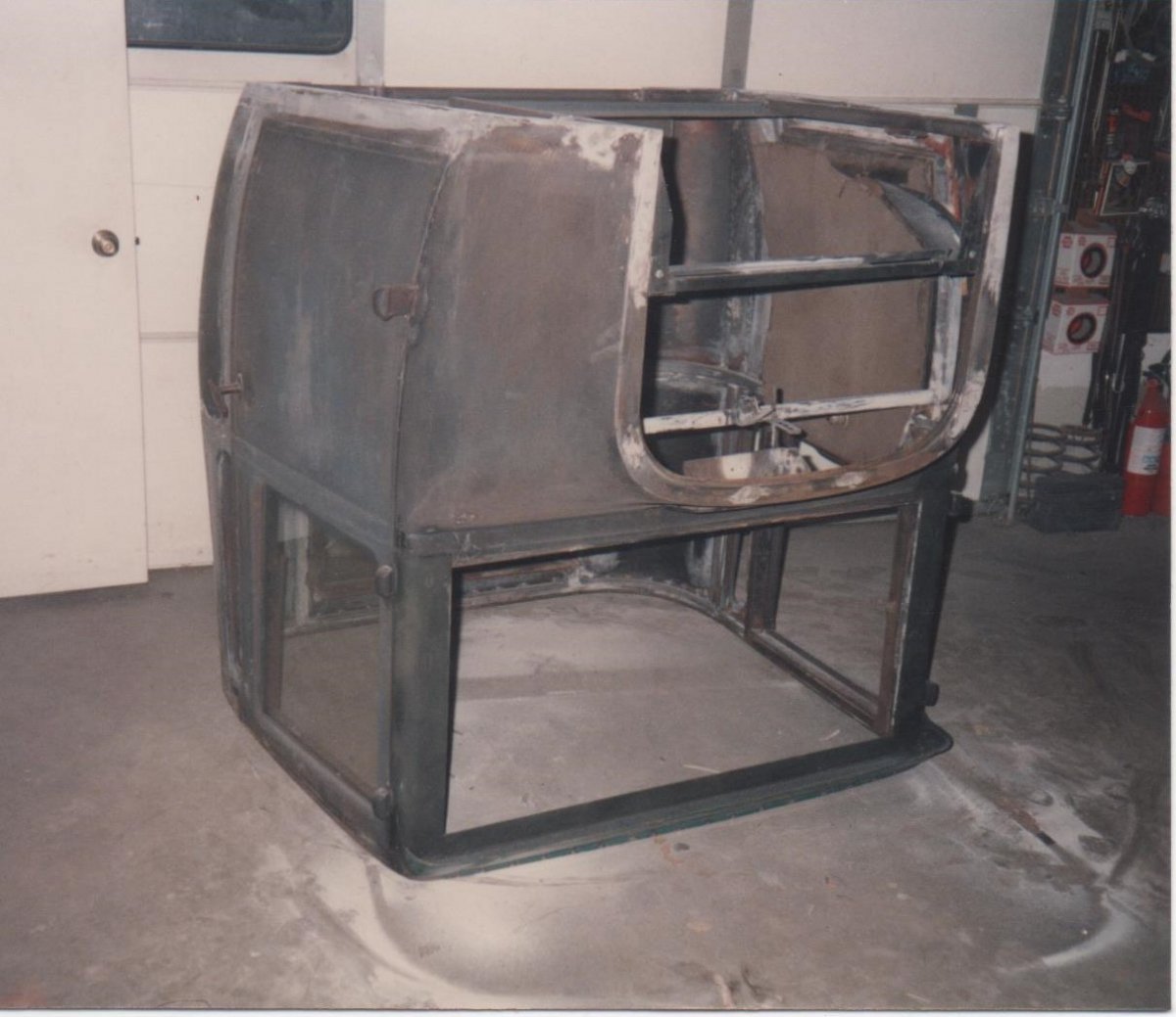

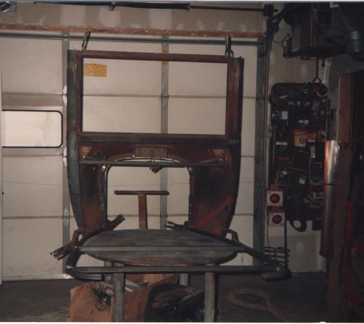

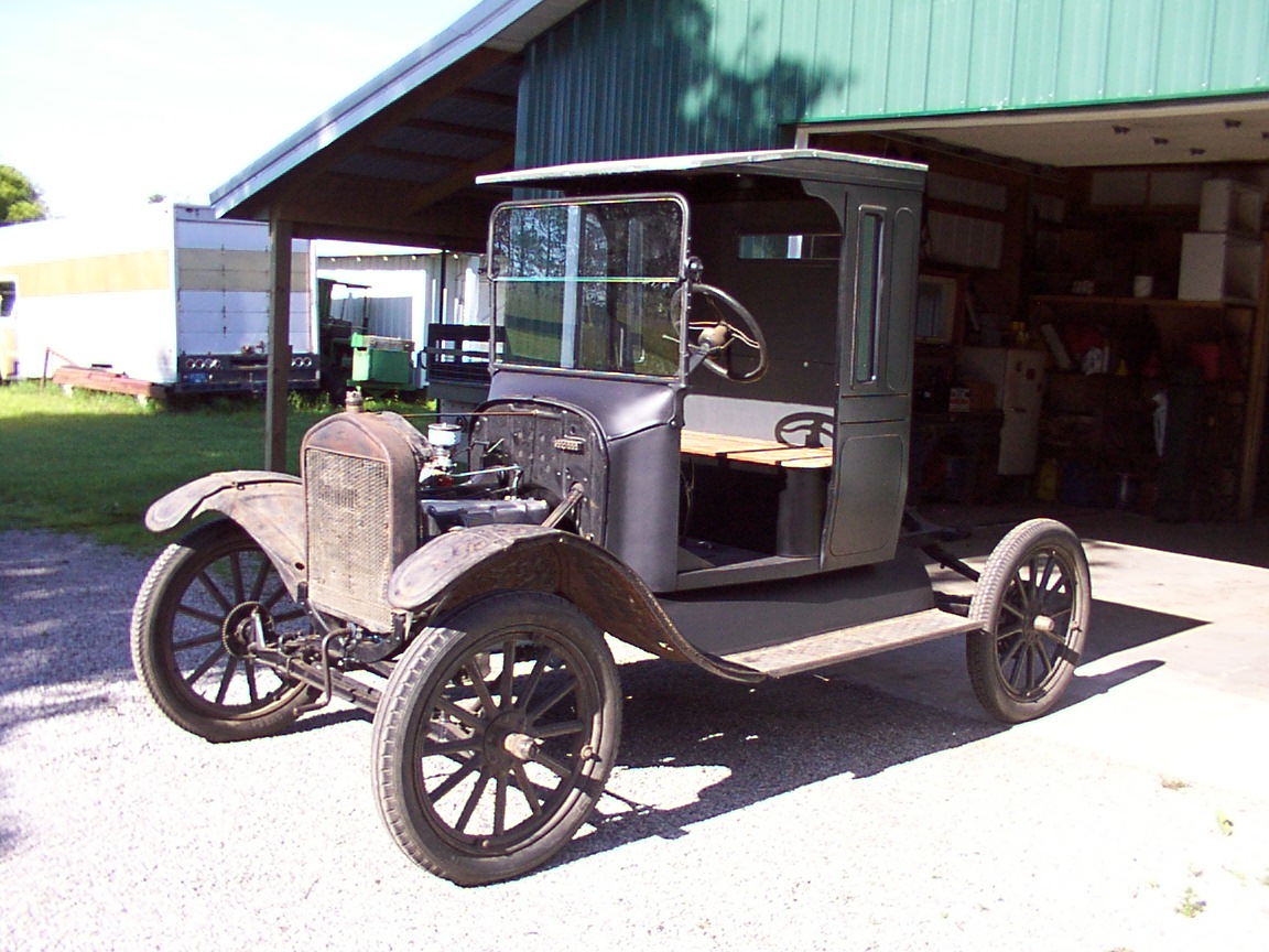

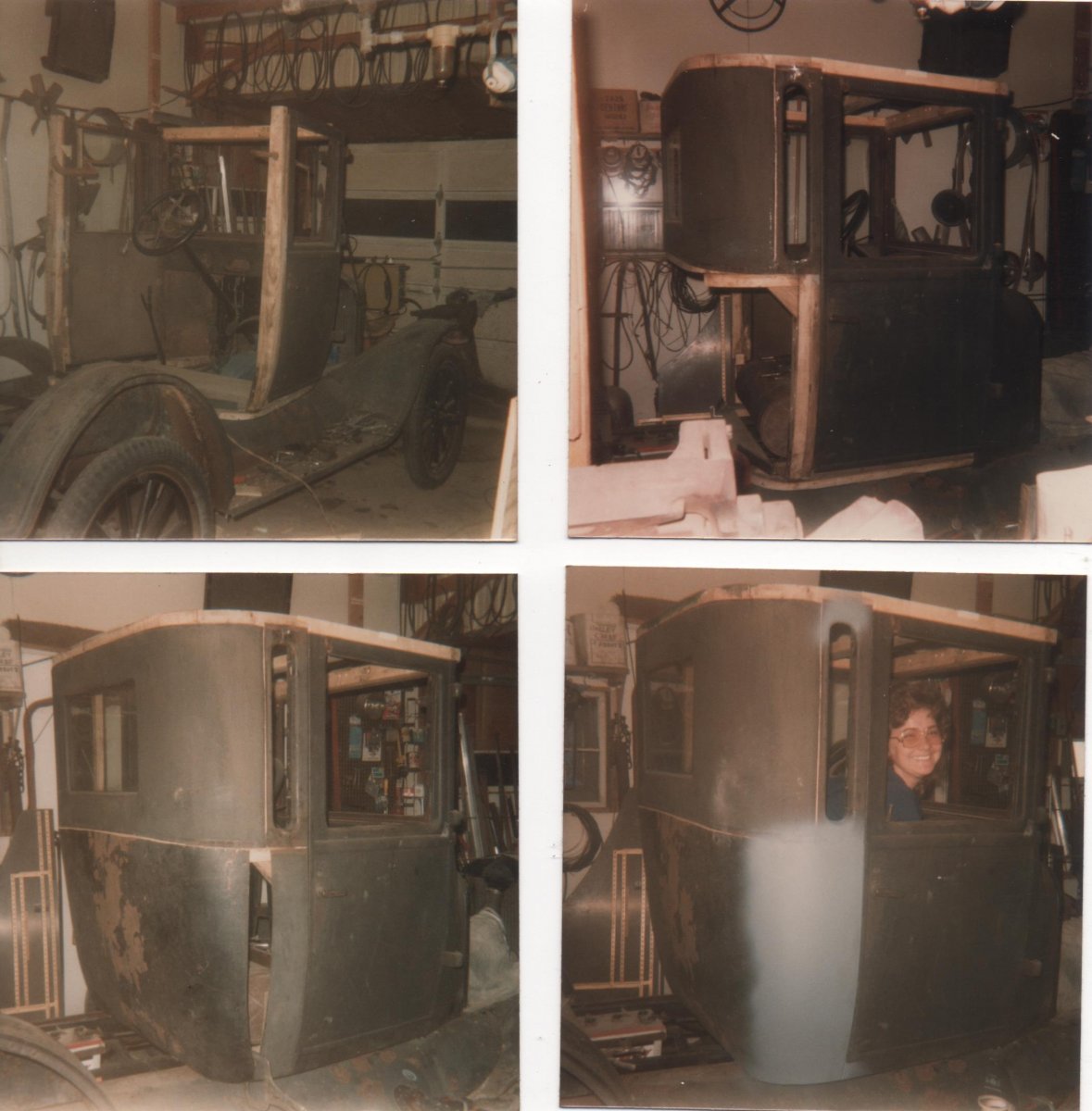

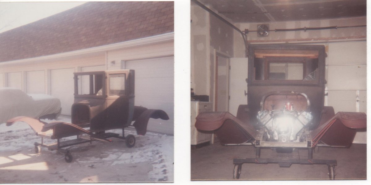

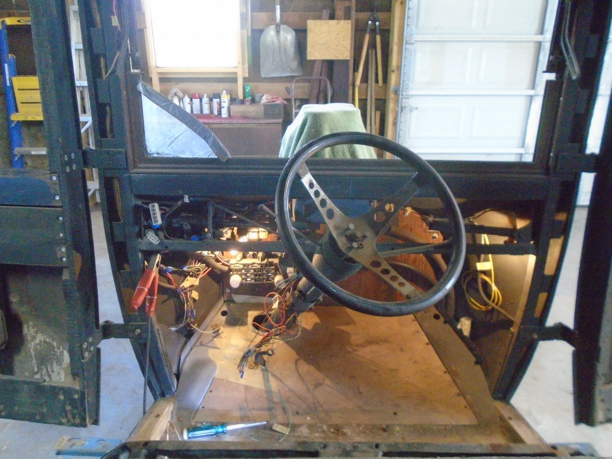

    Unfortunately I didn't take many photos when I first started building this car and I've had to do some digging to find the ones that I did take.
    Here are some of the body under construction and as you can see it was made up of pieces and parts.
    Starting with a cowl and doors, then putting on a rear window panel and making up the narrow quarter windows from pieces.
    The metal panel under the rear window is the front section of a roof from a 48 Plymouth car.

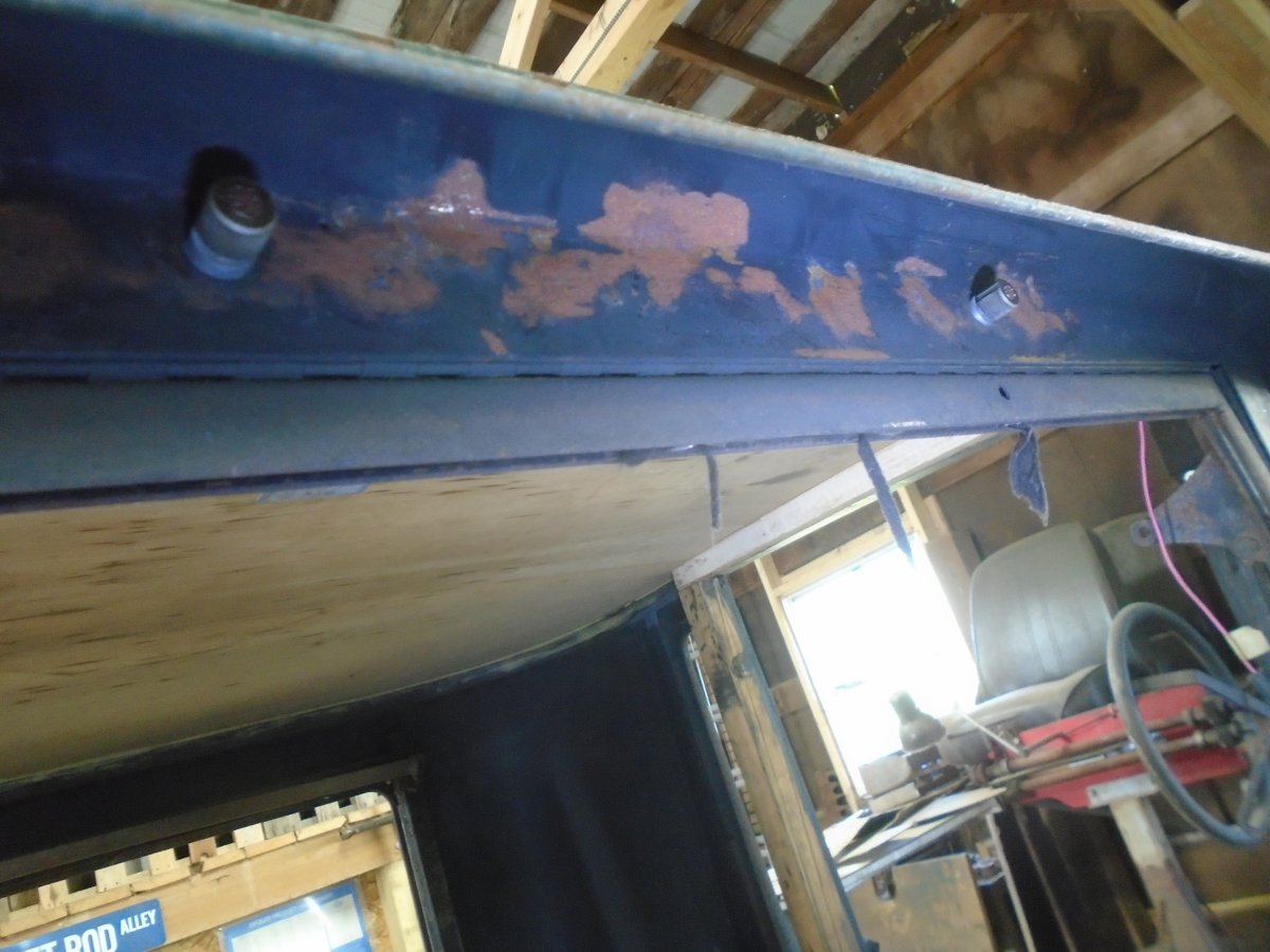

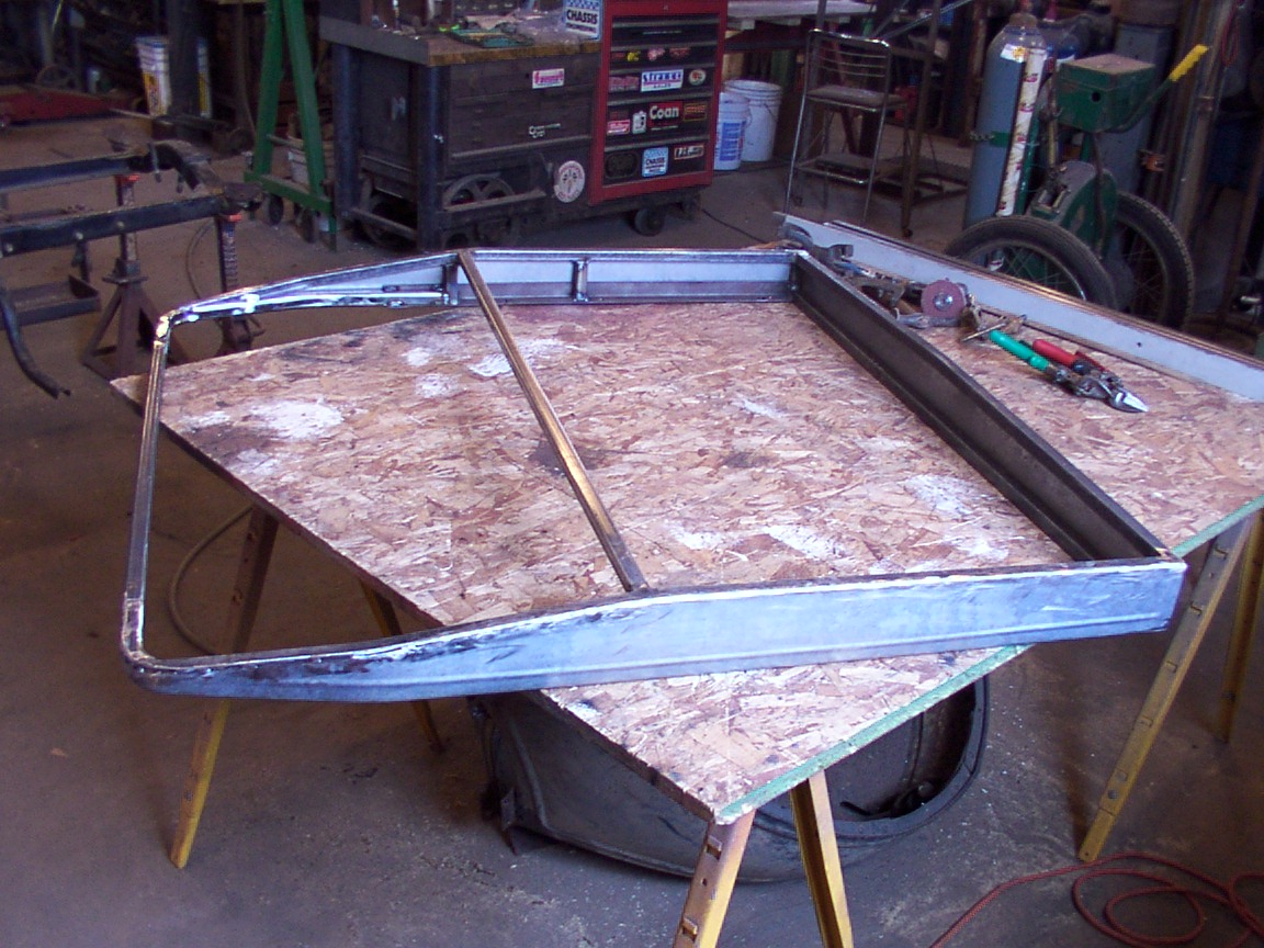

    I first built the body with a wood framework with the metal panels nailed to the wood like Ford originally built them.
    Later I decided that I wanted a stronger framework so I took it all apart and started over using 1 inch square steel tubing for the frame work with the body panels welded to it.
    The body is sitting upside down so I can weld the bottom of the panels to the framework.

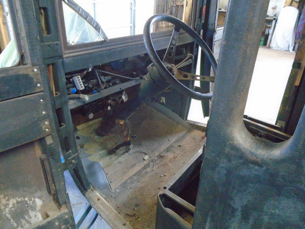

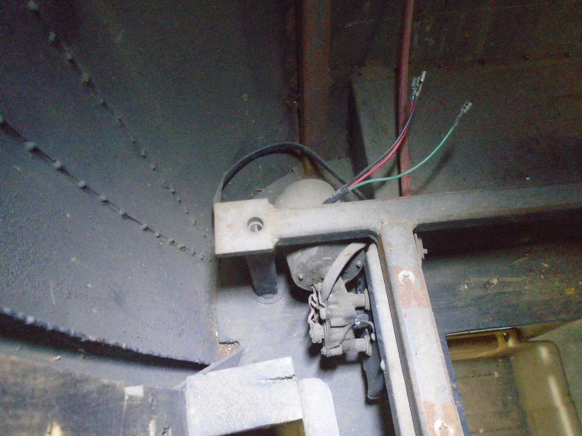

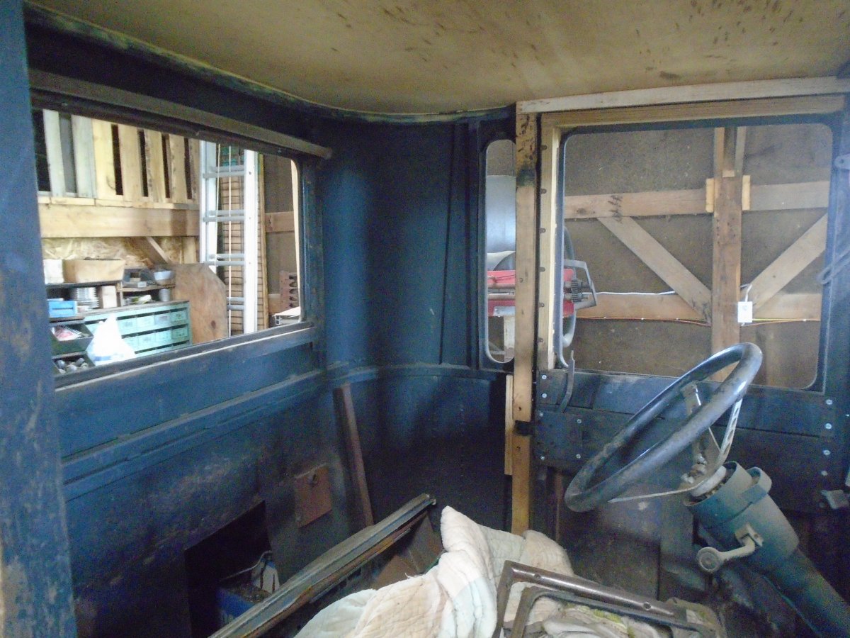

    I just took this photo of the inside this morning so you can get a better look at the square steel framework with the wood being added just as a filler.
    The top of the body has a flat sheet steel roof welded onto it with 1/2 inch plywood on the inside to support the roof metal and keep it from oil-canning.

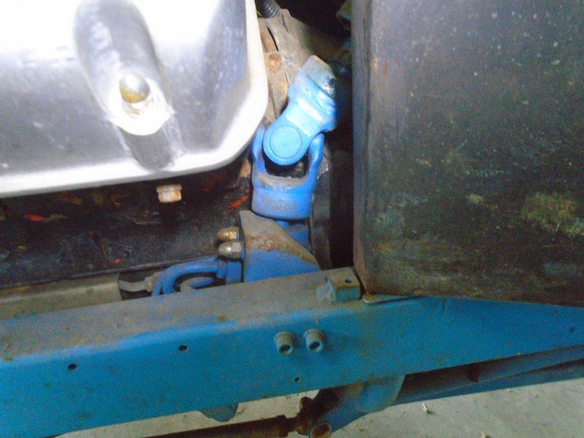

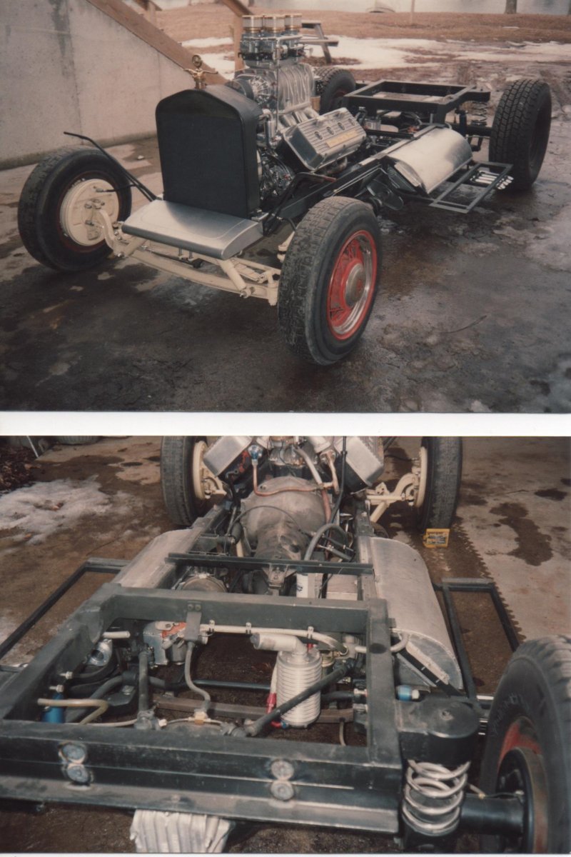

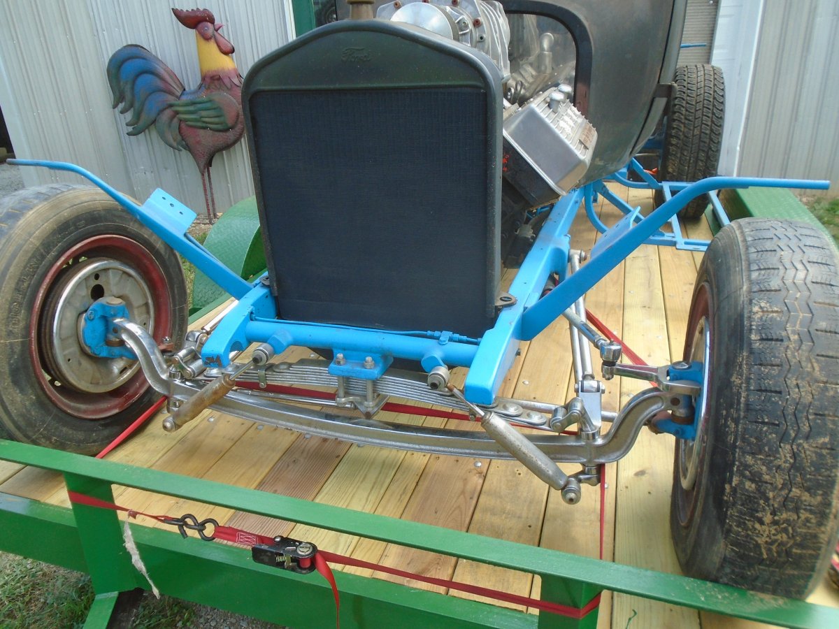

    Here are some photos of the frame being built and the engine being set in place.
    A couple of photos of the finished frame.

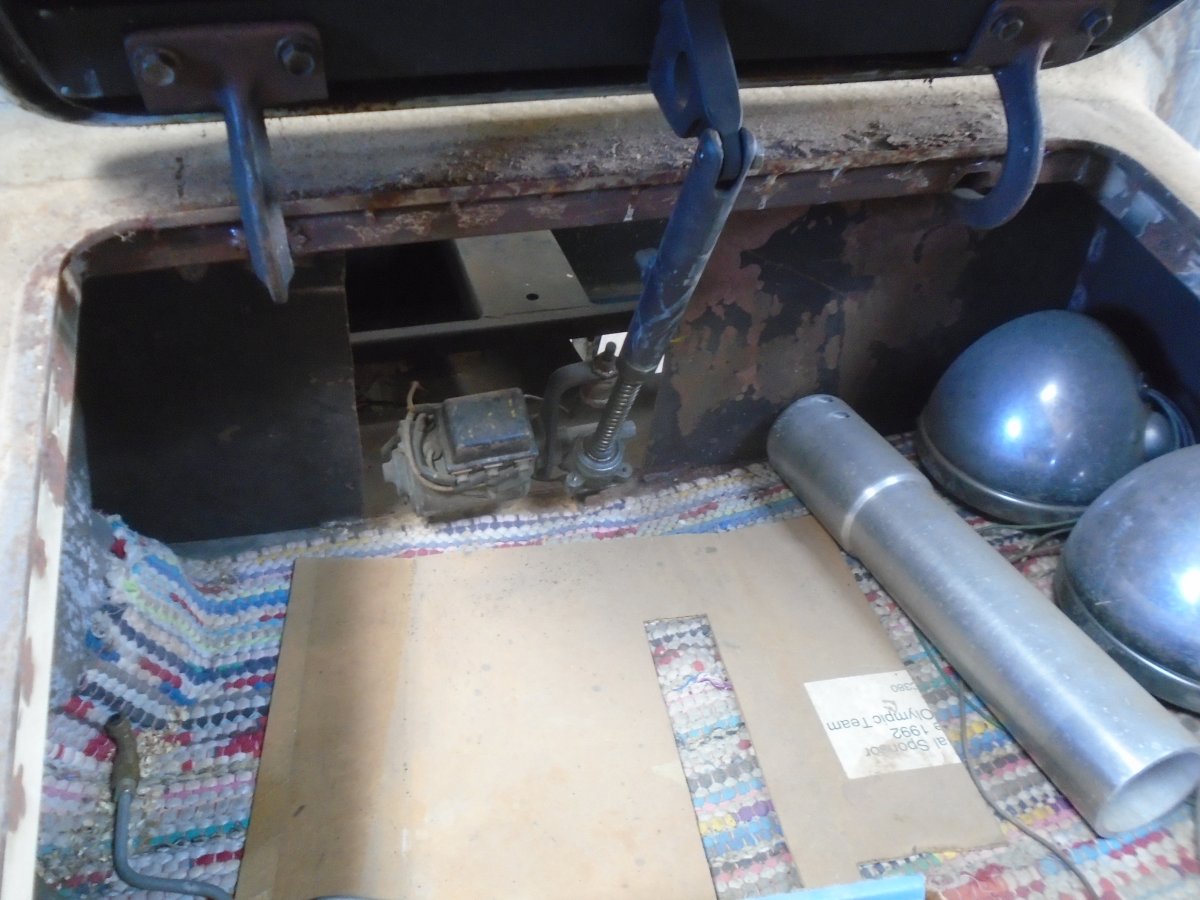

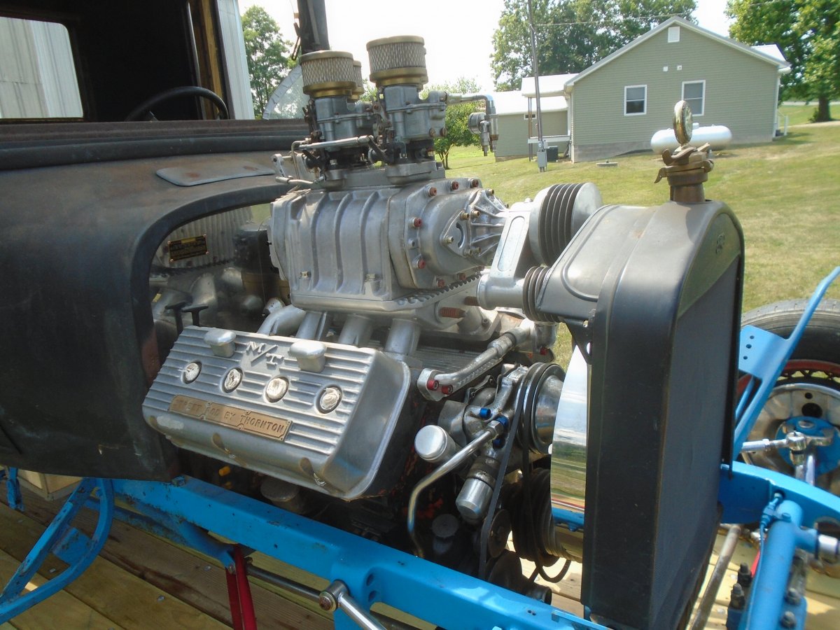

    What is the silver ribbed tank on the right rear for?

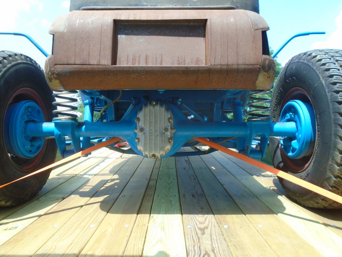

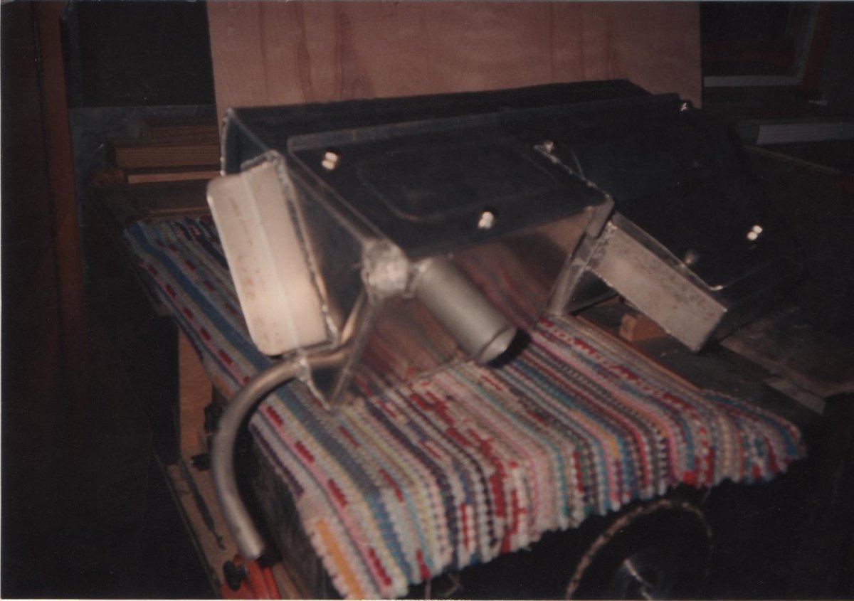

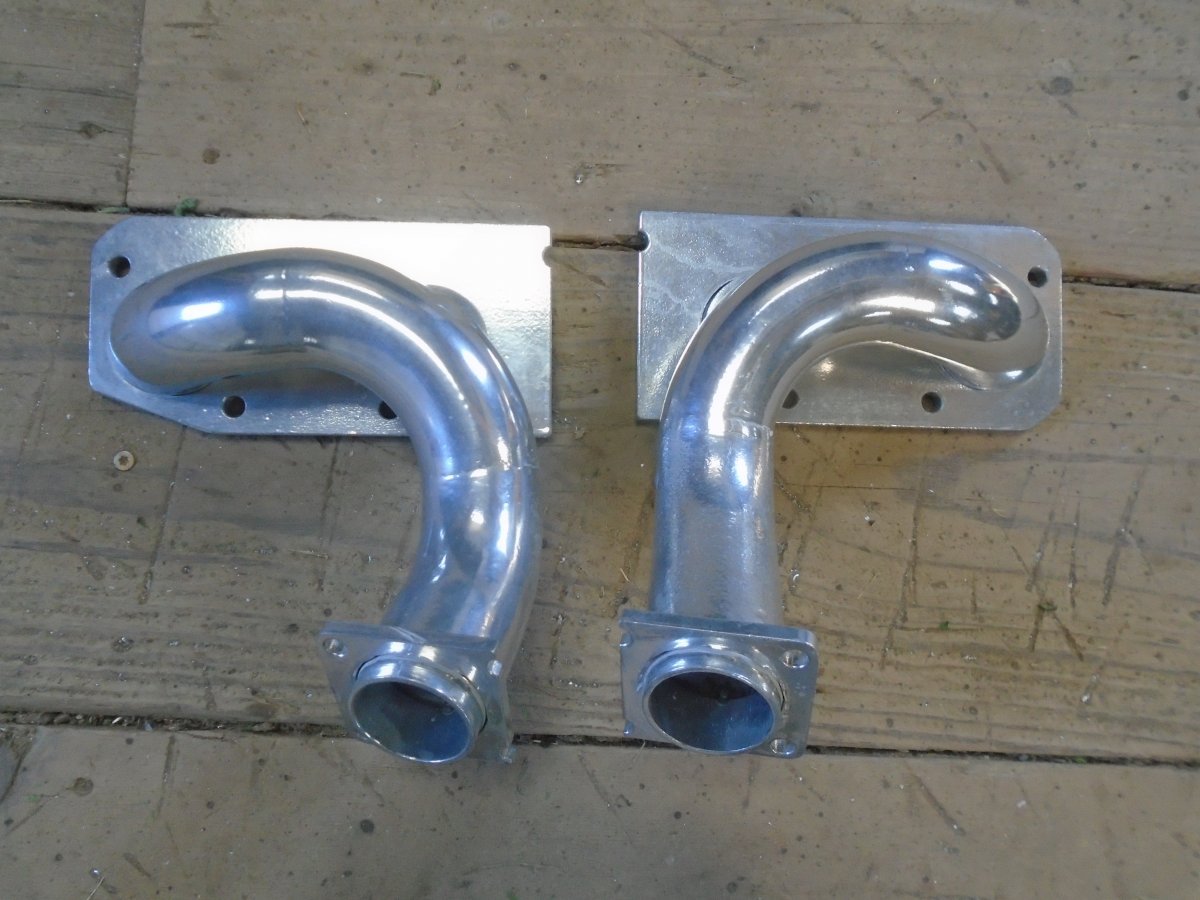

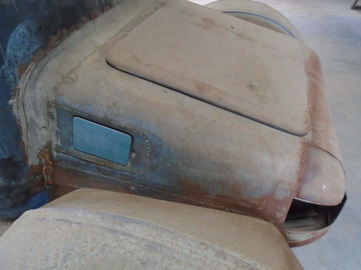

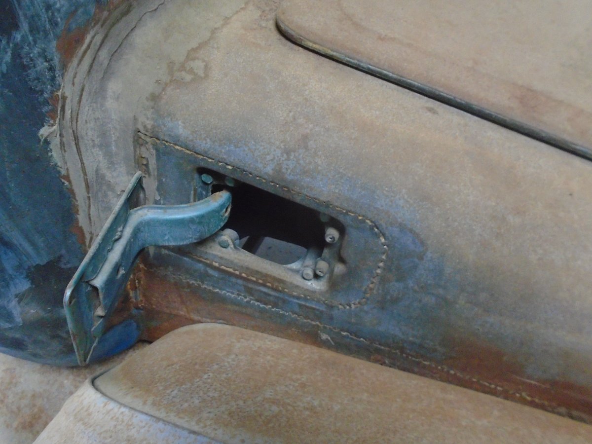

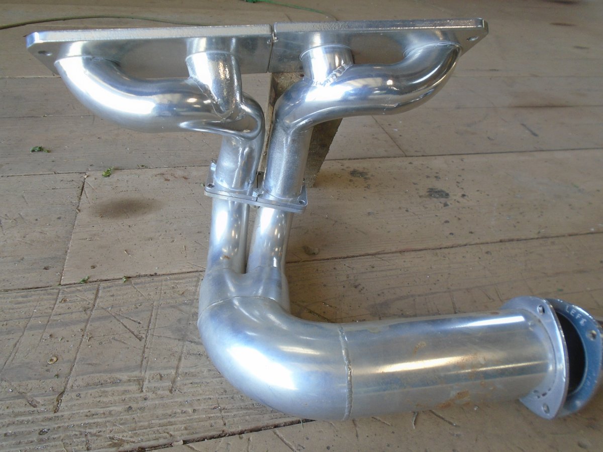

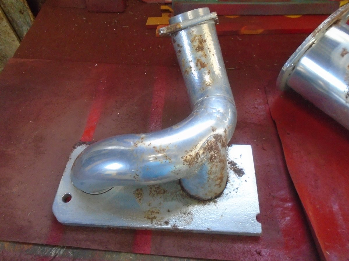

    That is a fuel divider.
    There is a fuel fill door on the left side of the turtle deck.
    From there the fuel flows into the top of that ribbed tank and then it is evenly dispersed to the two saddle tanks.
    There is an aluminum saddle tank inside the running board on each side.
    Here is one being built that shows the baffles in it.
    This is a view of the underside of one of the tanks showing the attached aluminum heat shield with the air space between it and the tank.
    One of the tanks shown mounted on the chassis.
    There is about 4 or 5 inch clearance between the top of the exhaust and the underside of the heat shield on the tanks.
    You can also see part of the ribbed tank with the inlet tube coming into the top and the outlet tube going out the bottom to the two tanks.
    Each tank has a tube at the top for the air to escape out of.
    The ribbed tank is the lowest point in the system and the electric fuel pump draws off the bottom of it.
    I figure this will give me about 25 gallons which is a lot more then most of " T " street rods / hot rods.

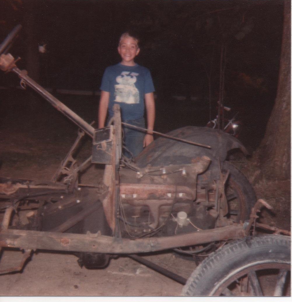

    This is the original frame and engine from the Model-T.
    It had been in an accident and you can see that the frame is bent and the engine is leaning to the passengers side.

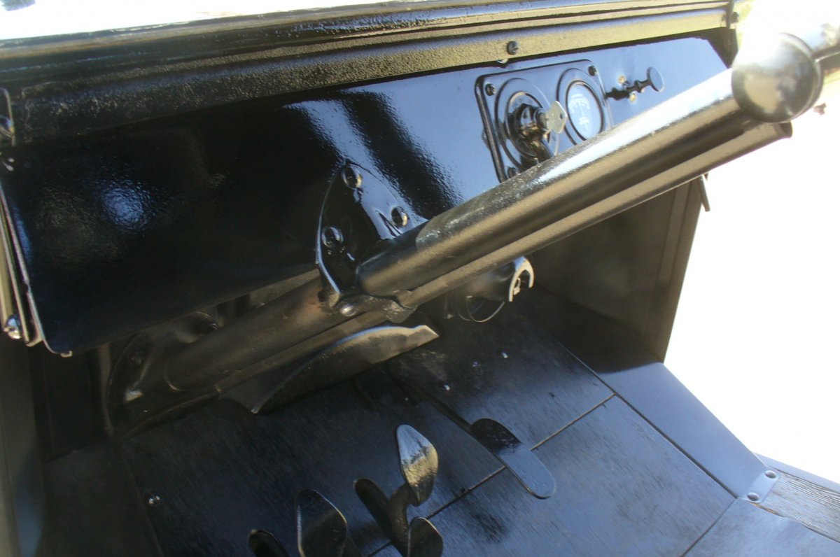

    My son has always liked to help me with my projects and he is working on cleaning up the frame after I had gotten it straightened out.
    He did a good job and we got it all painted up.
    I don't remember just when these photos were taken but that little boy in them is 48 years old now and stands 7 inches taller then me .... so it has been awhile.

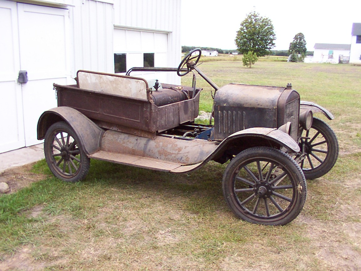

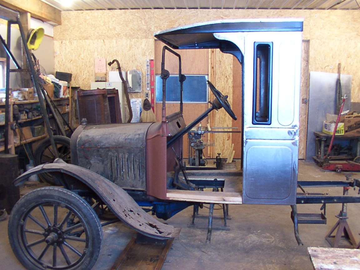

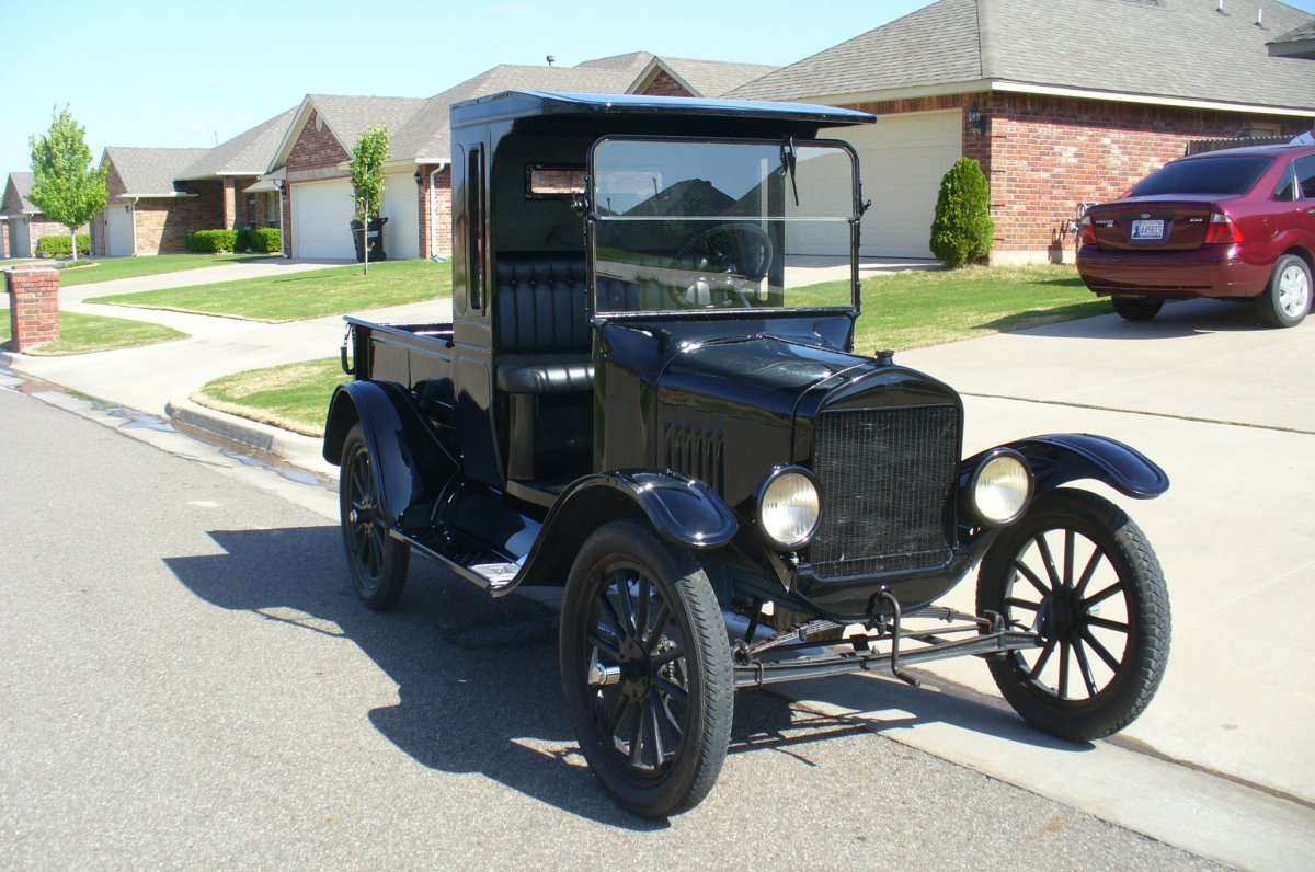

    Somewhere along the line, I had picked up fenders, running boards, pickup box and windshield from a 1917 model-T roadster pickup.
    The guy was building a period correct circle track race car and kept the the frame, engine, body, hood and radiator for it.
    For a little extra money, he let me have the clear 1917 title to go with the discarded body parts.
    Taking into consideration what restored model-T's are selling for now, it is sometimes hard to believe that they weren't worth very much back in the 60's and 70's.
    I got a radiator and hood at a swapmeet so ... with my frame and engine and the other T sheet metal, I had a good start to build an original T.
    This bunch of T parts also sat in storage until about 11 years ago when I got it out and started working on it.

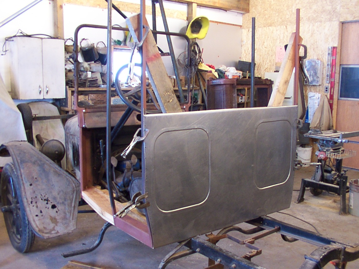

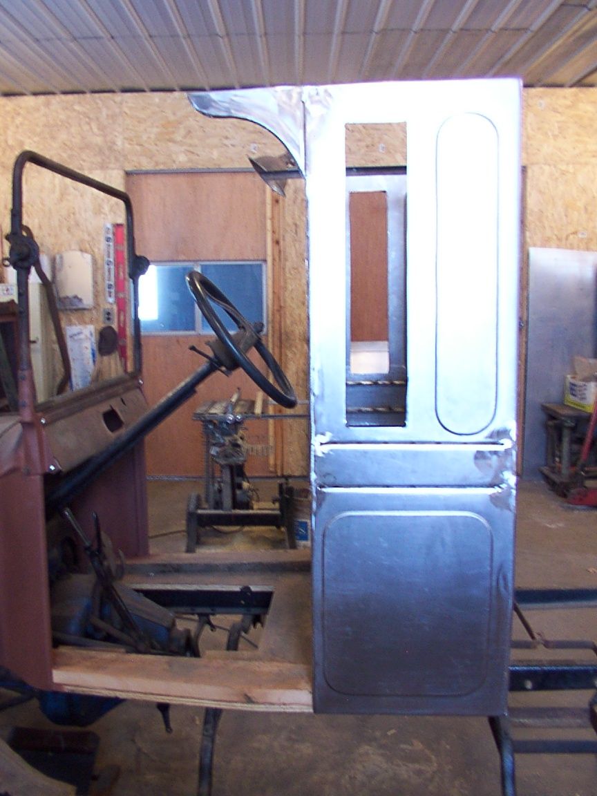

    With a cowl and a dashboard that I got off ebay, I started building an open truck body for the T
    I used 1 inch square steel tubing to form the main framework for the cab and I formed the panels out of sheet metal.
    Here the lower back panel is ready to be welded to the framework.
    The frame is made up for the roof and the metal is welded to the sides.
    Then the top panel is fastened onto it.
    And it is test fitted to the cab framework.
    Here I'm forming the upper panel for the back of the cab.
    And it is welded in place.
    The side panels are made up and welded onto the cab frame.
    The quarter windows and top section are fastened in place.

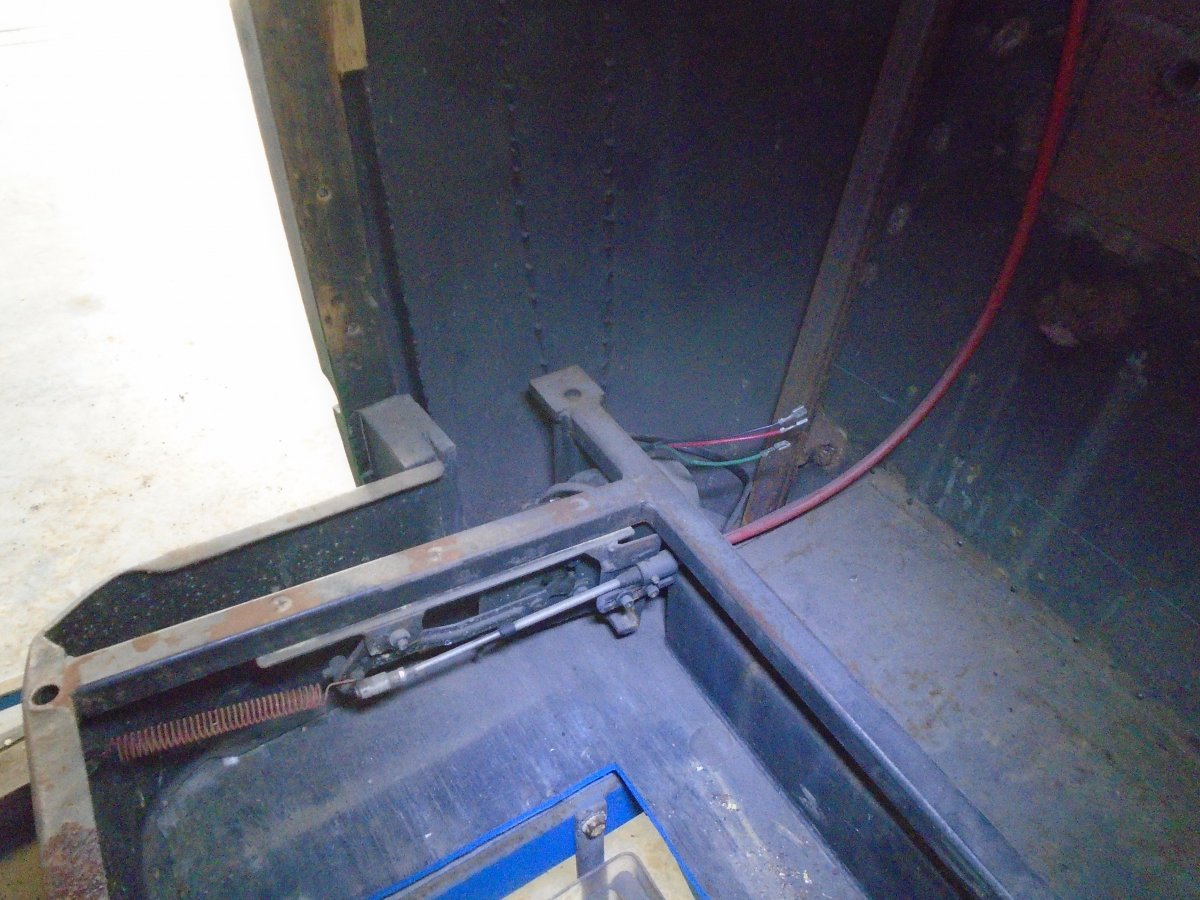

    The engine was completely rebuilt and hopped up a little with an aluminum high compression head, 2-barrel carburetor.
    It had a distributor with a single coil and a timing tab mounted over the crankshaft pulley with a top dead center mark on the pulley.
    It also had a water pump added and a larger outside oil line to feed oil to the front of the engine.
    It has an aluminum oil pan to hold more oil and a dipstick added for more accurately checking the oil level.
    ...... The original model-T had two small brass spigots on the bell housing for checking the oil level.
    You had to get under the car to check them.
    If oil flowed out of the top one, it was too full ... if no oil flowed out of the bottom one, it was too low. .......

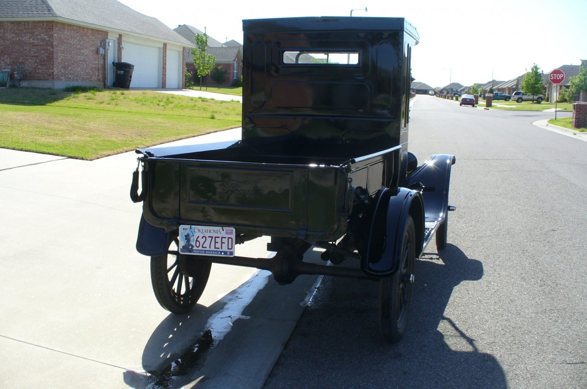

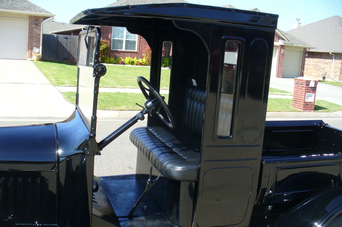

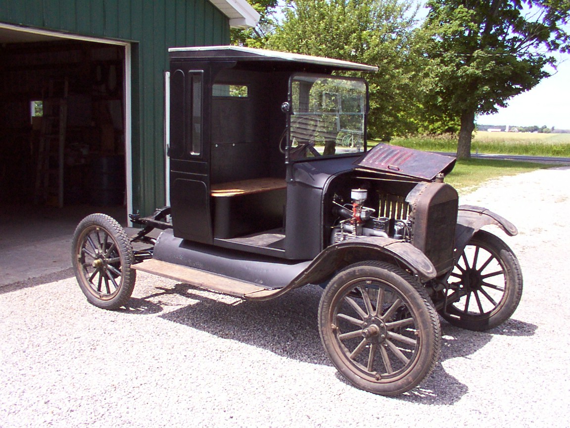

    This is what the T looked like when I sold it.
    The new owner sent me these photos after he had finished it.

    I agree with you on the narrow fenders.
    They seam to work alright on the original T's with the narrow wheels but they sure don't cover today's wider tires and wheels.
    Rootlieb makes new T fenders and sells them thru the old car restoration catalogs.
    I called them and they made up a new set of fenders for me that are 3 inches wider then the stock T fenders so they cover the tires on my car.

    I have finished the project that I was working on and I'm ready to start on the T.

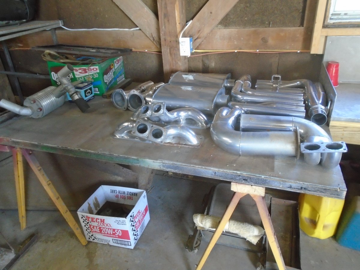

    First thing was to empty it out.
    This is all the stuff that was stored inside the car.
    The silver parts are the special exhaust system that I made up for it.
    These parts have a silver coating on them and I was told that the coating would be scratch, heat and rust resistant.
    Well .... I hope it is at least heat resistant because it certainly isn't rust resistant.
    The exhaust manifolds are built in two pieces for each side so I can get them on and off without having to lift the engine up.
    Once they are mounted on the engine, then the lower pipe bolts onto them.
    This is how the exhaust pipes fit together.
    The four outlet pipes at the back come out from under the running board just in front of the rear fenders and they will have chrome turned down tips on them.

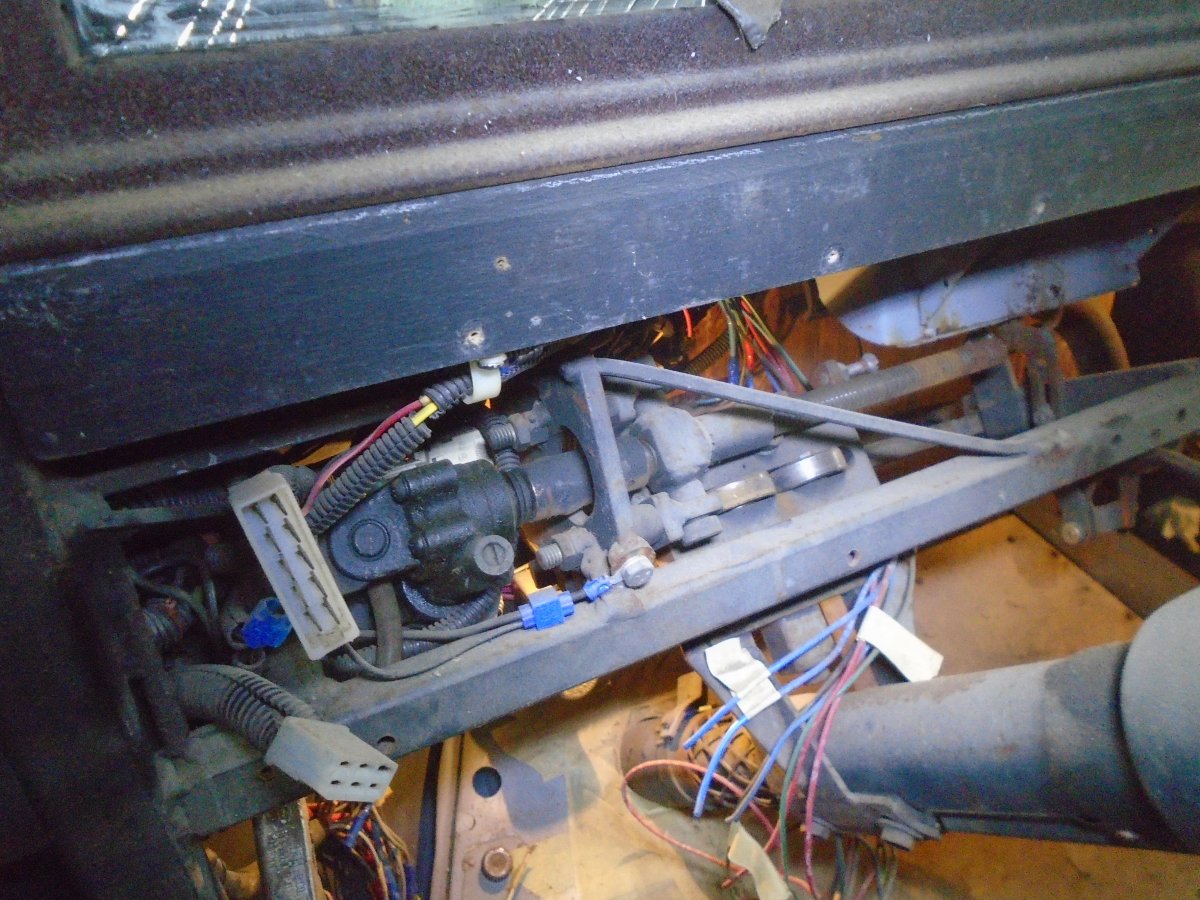

    I copied an idea for the steering that was used on the Ford T-Birds in the early 60's
    The upper part of the steering column is mounted with ball bearings to a curved piece of solid square steel.
    Behind the dash, there is an electric powered Acme screw rod that is attached to the steering column.
    When you flip a switch to the right, the electric motor turns the threaded rod and the steering column slides over toward the center of the car to allow more room for getting in and out.
    When you flip the switch to the left, it brings the steering column back to the driving position.
    The steering shaft is connected to the steering box with a universal joint so the column can move over no matter where the tires are positioned.
    I also have one of these screw motors in the back for a power trunk lid.

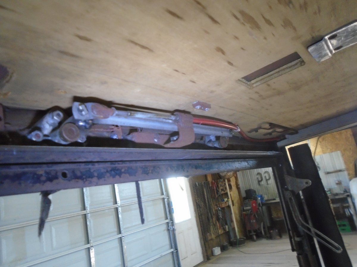

    There are two windshield wiper post up under the visor.
    They are connected together on the inside and have a cable attached to them.
    The other end of this cable runs back over the passenger door and connects to an operating bracket under the seat.
    This bracket is operated by a 2-speed electric wiper motor with intermittent pulse settings.

    I took it down to the carwash and it cleaned up a lot better then I had thought it would.
    This has rack&pinion power steering and power brakes.
    The 57 Hemi engine has a Chevy water pump, starter and 700R-4 automatic transmission adapted to it.
