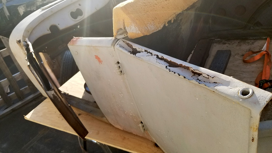

    So, I've posted about this car over on my main build thread, "MODIFIED LAKESTER BUILD (THUNDERCASKET)" so far but it is time it gets its own thread. I had been urging @justa170 to build a traditionally styled hot rod for some years now and onde day he found this 27 touring car "rat rod project" for sale at a price I said was reasonable and told him to go grab it.

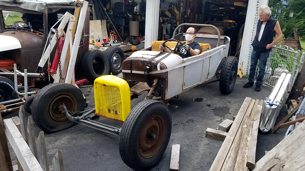

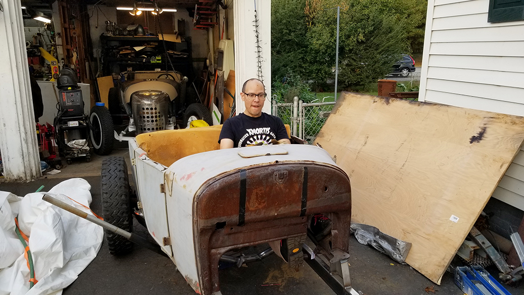

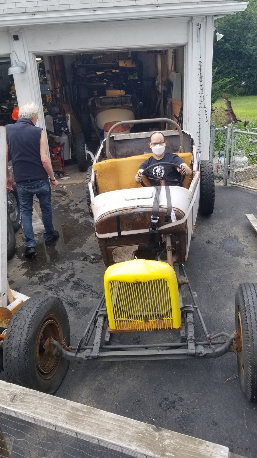

    First thing I wanted to do was mock it up and sit him in it.

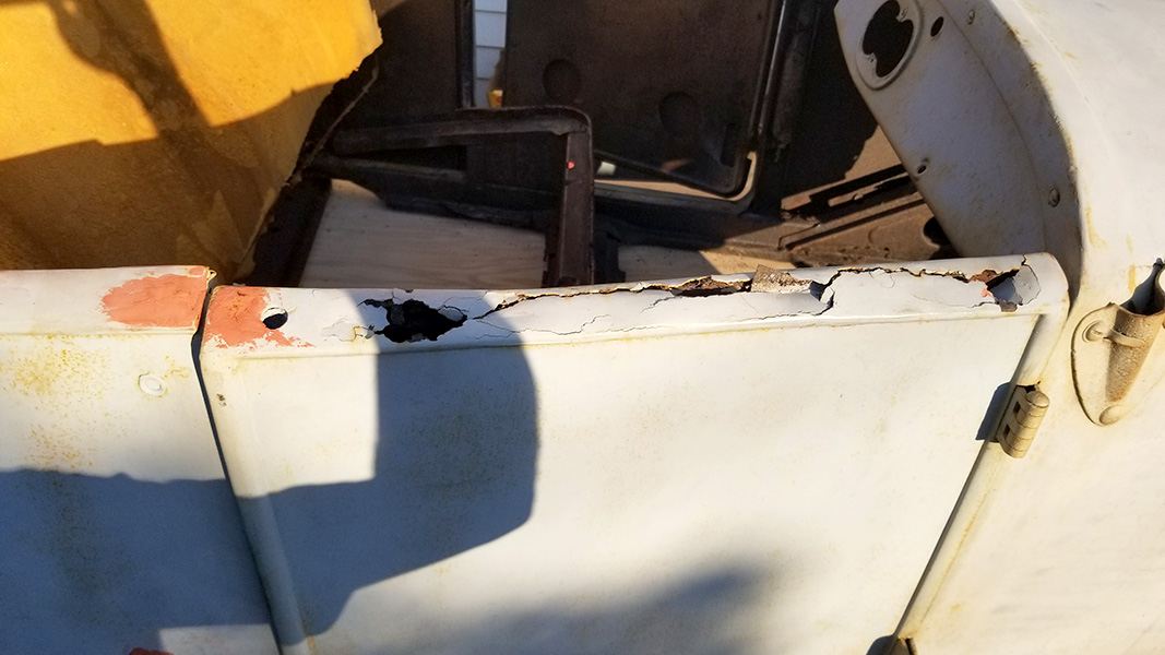

    As is almost always the case, it was worse than the pictures told but I expected that. We ended up shelving the frame and punted the front end entirely (it looks VERY underbuilt and under-engineered).
    This is all welded up and made of steel that seems to be like 0.10 or something.

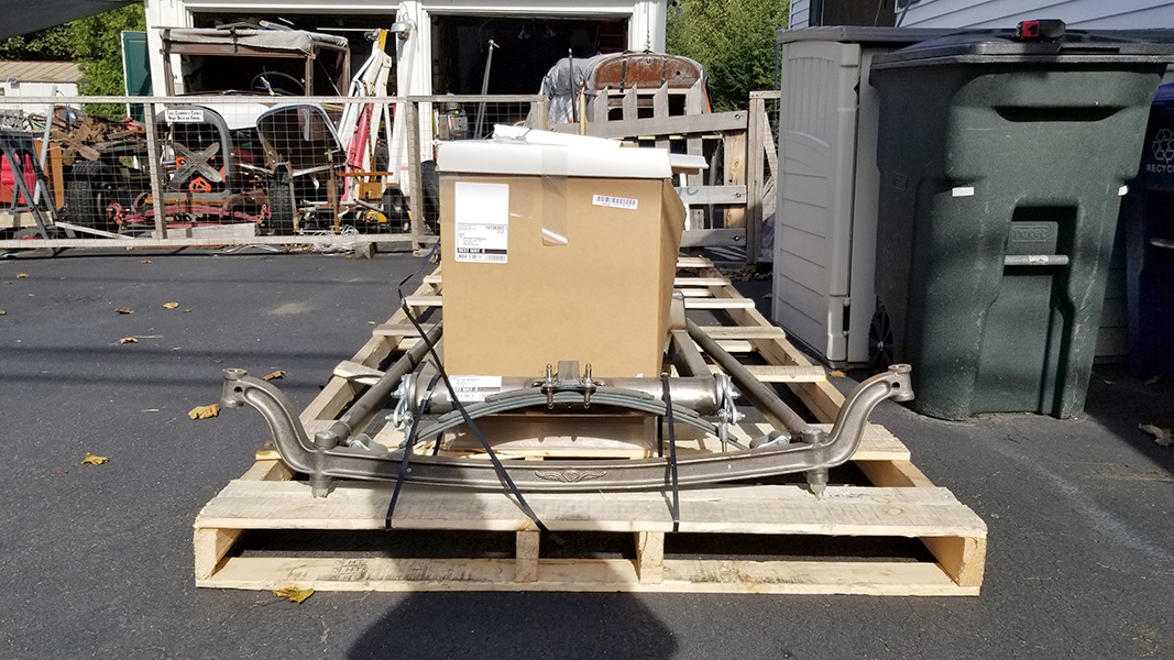

    We made the decision to throw money at the chassis and time at the body so we ordered the Speedway Tribute T chassis kit which took a while to arrive but is a really nice kit (it came mostly assembled).

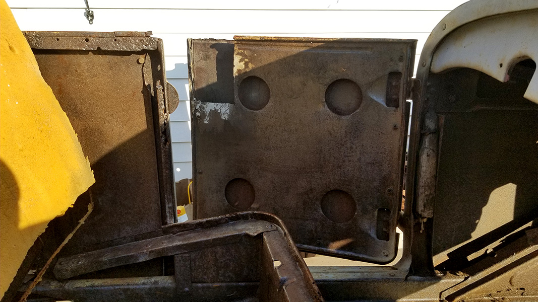

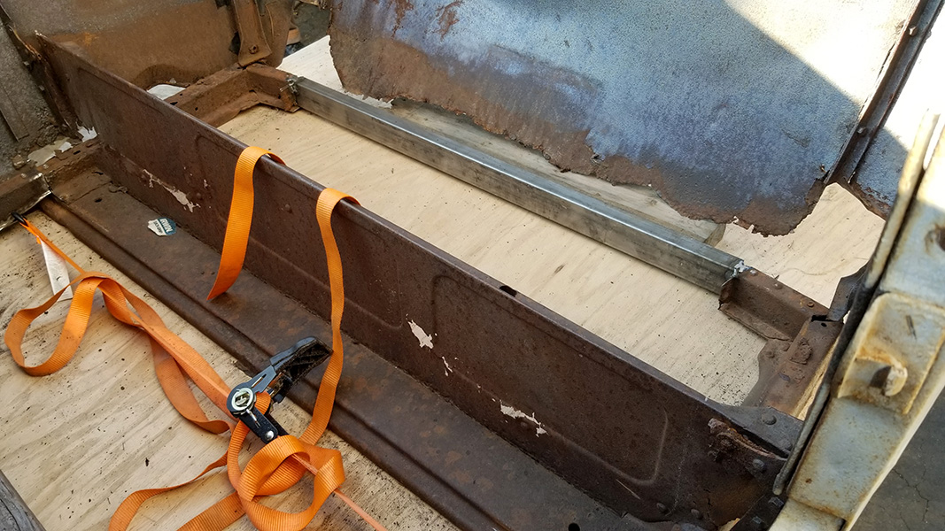

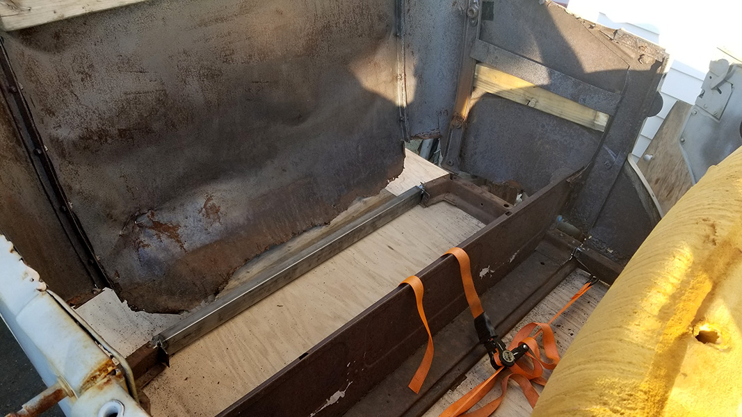

    Oh, and the body has A LOT of mudwork where metalwork was called for, like the door tops made of tape, cardboard, and Bondo for instance:
    Once that finally arrived (it was backordered for weeks and we are still waiting on some things from the order), we determined the body wasn't going to jive with the chassis quite how we hoped BUT that wasn't really that big of an issue because I have DEFINITELY shortened a touring car before ;) and this car was DEFINITELY not too nice to cut up.

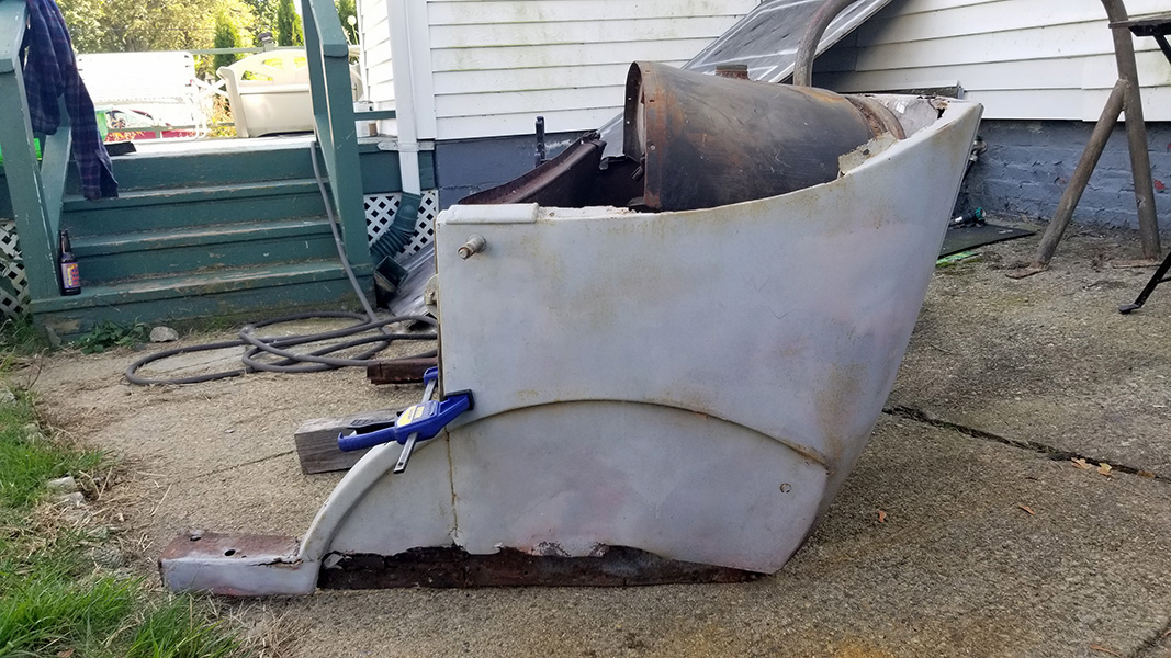

    So, we cut the back half off (the subframe had been butchered by previous owners long before we got it anyway) and this is what we got.
    SO, the plan now is actually an idea that I WISH I had used on the Thundercasket body; we are going to mount/merge the rear quarters D pillar to the C pillar (where the front seat frame attaches) and section the front and rear doors together to make a long-door shortened touring tub. Since the body sits so low due to the kick up, we will move the back of the tub up until we clear but the C pillar location looks to put us in the ballpark.

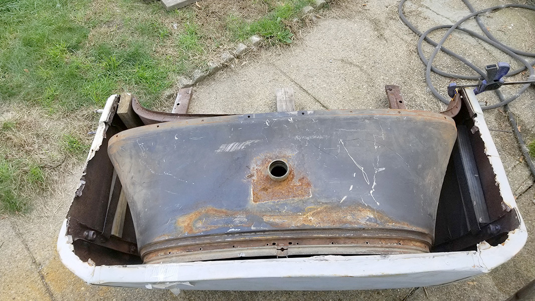

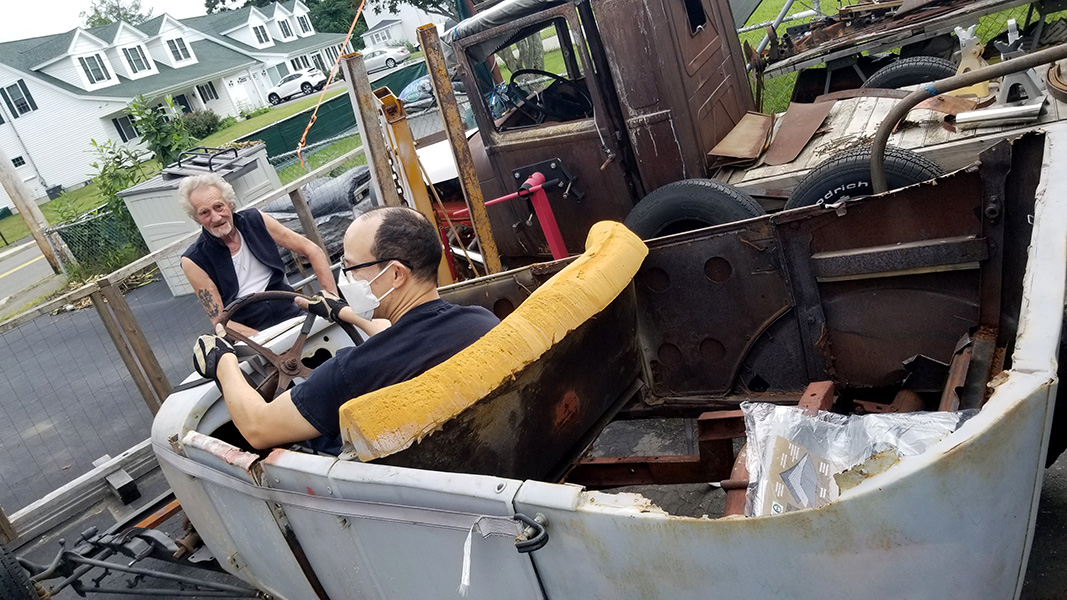

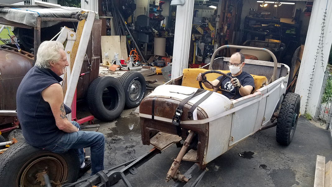

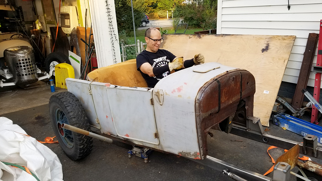

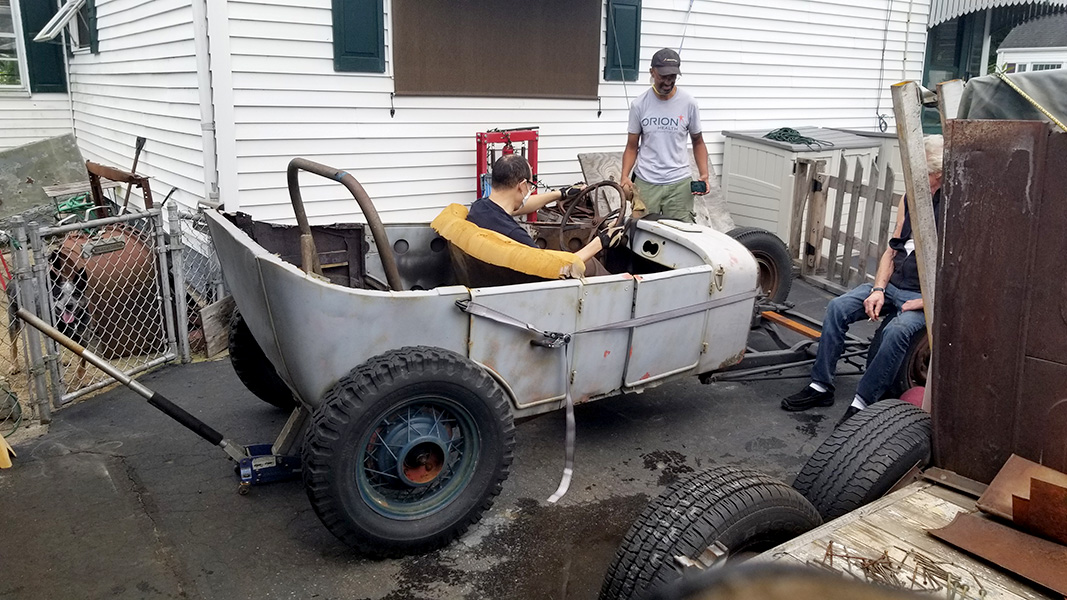

    This is after we cut the back off and wrestled the body down on to the frame for the first time. This is obviously not where the body goes. We decided that we should get the steering box mount and firewall as close together as we can (which seems to be the intent were we to be using the glass body from SW).
    I try to get pictures when he is making only the worst faces.
    My predictions for where the wheels were going to end up wanting to be were pretty near dead on.
    Here is the back half as we were playing with ideas before cutting the subframe back out of it (that I spent part of a day putting in a couple weeks before). We clamped the front seat frame in to get an idea how much the D pillars were going to have to come in (about a 2x4's narrow side) and fiddled around with an idea I had years ago to run a Model A gas tank flipped around but not sure this car will get that.

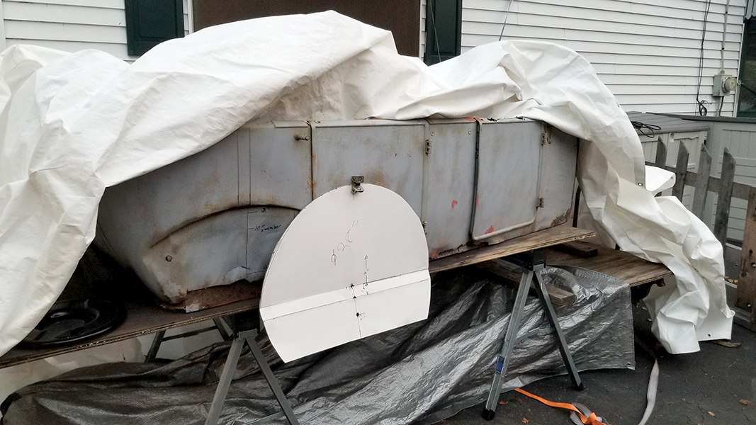

    That is the current plan, yeah. Using the front half of the front doors and backs of the rear doors +/- makes for less modification and I think it will be an interesting look. Since the rear will be offset back a bit in relation to the wheel well, I may make some bolt in filler panels but that is not a priority at this stage. If we get this mocked up like this and decide we hate it, we will stretch the front doors and hack up the rear quarters more to make that work but honestly, I would REALLY prefer to not do that to this car. The front/back sectioned together door path looks a lot easier to do with what we have to work with and our near-future goals for the car.

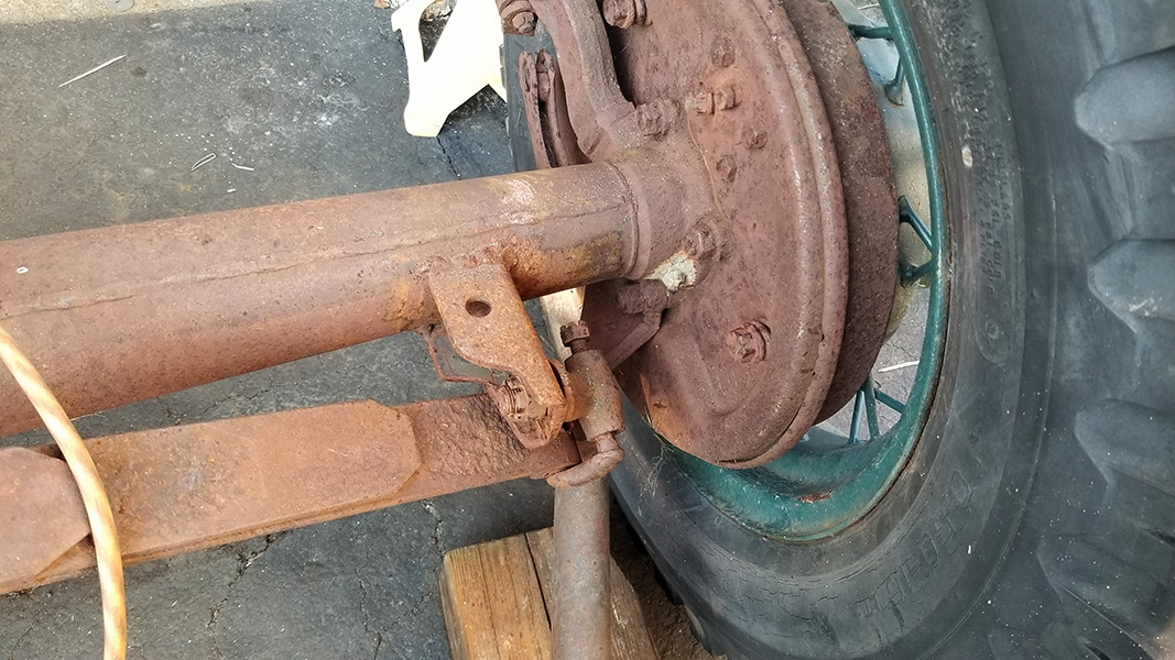

    The front axle itself looks OK. Not sure what it came off and I am not familiar with the spindles. I haven't inspected the wheels/hubs to see what they actually are either. Frankly I just want it gone because I do not think it is suitable for more than yard art or a very mild yard driver. The "batwings" are made of like 0.10 plate and welded on to the axle with the hairpins welded on as well. I would not feel safe on the road with this setup. All the welds look to have been hit with Bondo so I did not trust them. The welds I saw inside the body on the subframe were boogers and I broke them free by hand. Also, the J bolts for the quarter springs were welded in and the odd sleeve bolts that hold the eyes on are a mess. The way it was set up on the original frame, it looked to me that you could damn-near end up leap frogging your axle and going ass-over-teakettle. It is yard art.
    I believe he has dual 2bbls of some variety I have forgotten but he was very specific about. He had the cam custom ground so I think this thing is going to run like a scalded cat from a cherry bombed trash can. I would not be shocked if he bests 1:1 hp.

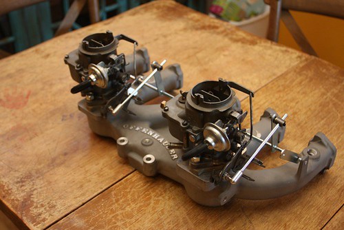

    Intake: Offenhauser 5041 with a pair of Carter BBS 7044s.
    (Not my photo, and not my stuff, but that's the idea.)

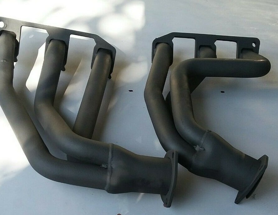

    Exhaust: Clifford shorties. Can't find the P/N. We'll see whether/how much they need to be altered.

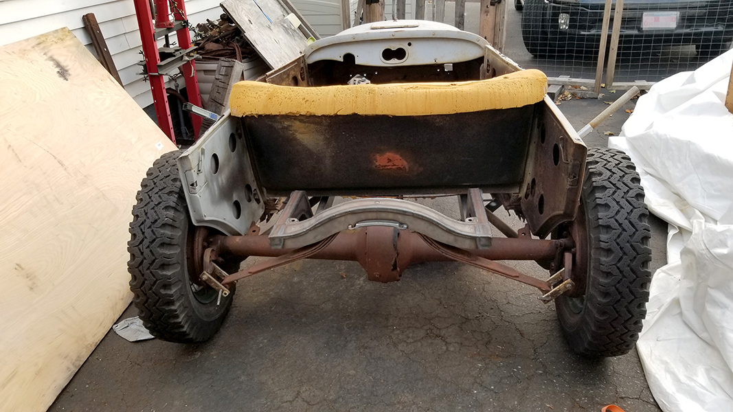

    A lot of our time these past few weeks was spent erecting 'the hut' and giving it some creature comforts like a floor, soft sides, and an insulated ceiling to work on the "BASURATI" project and starting to finally clean up my driveway now that my shoulder is getting a little stronger. It is actually surprisingly comfortable in there.
    That being mostly done, we managed to get the car slapped together and rolled in there. We had to roll it back out to get the mockup engine dropped in now that we have a nice T5 with goodies to mount up. The adapter plate went on the bell just fine and we got the whole rig dropped in using a spring pack as a temporary cradle.
    I was astonished to find that the engine mounts lined up just about perfect considering none of this is what the frame was designed for (a Flathead!).
    The body will come forward at least another 3" once I get the subframe reinforced and relieved. At the moment the transmission interferes a bit but this is the only remaining crossmember so I need to do other work before I make a cut.

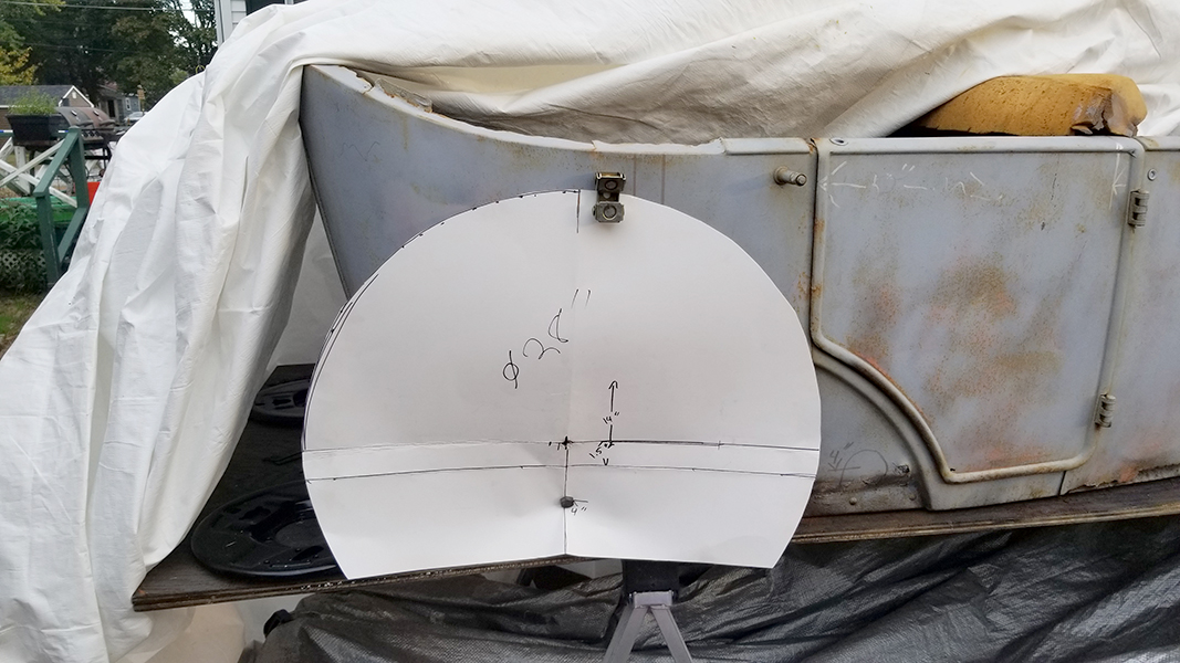

    We have been hitting our heads on this thing a bit lately. Currently, the main roadblocks are finding the right wheel and tire combination and figuring out the rear suspension.
    Wheels & Tires:
    I think we can get away with a 26" tire up front and 32" tires out back; we have it mocked up that way now using my wheels off the Thundercasket build and some blocks up front. The major issue we are having is finding new wheels with the right offset so the wheel doesn't look like it's sitting on top of the finned drum that are narrow enough to work with the tires @justa170 wants to run, bias look Stahl Sport Radials. We keep finding wheels with 2.375" to 2.75" offsets which seems too shallow to me vs. stock Ford 16's. We are looking at 17" & 18" wheel combos too but it's been a bit maddening trying to figure this out without stuff to actually try and look at. Anybody got 2.75" backspace wheels with Buick drums we can see?

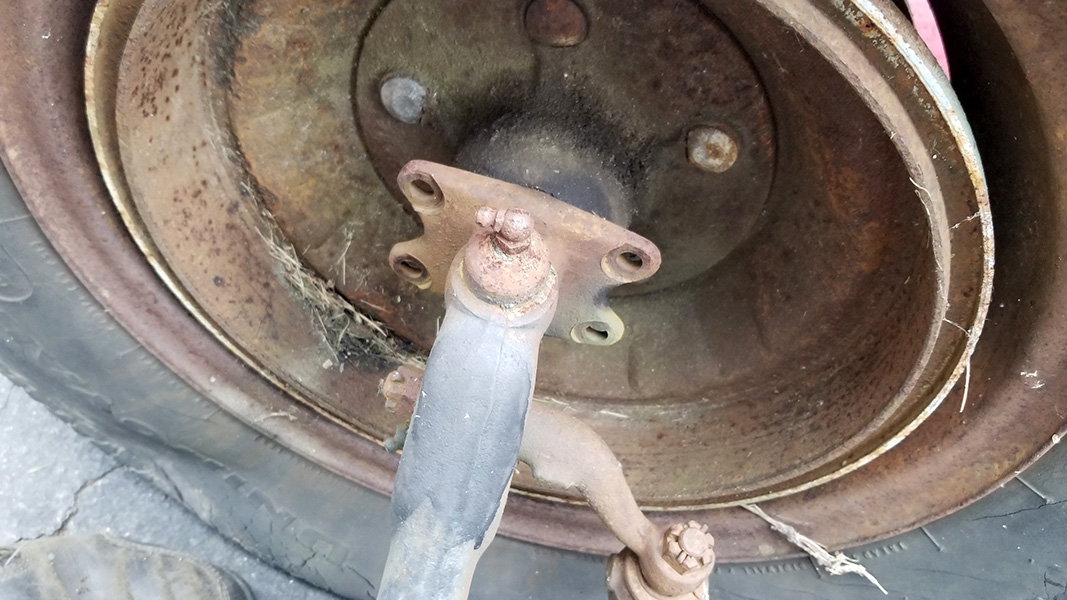

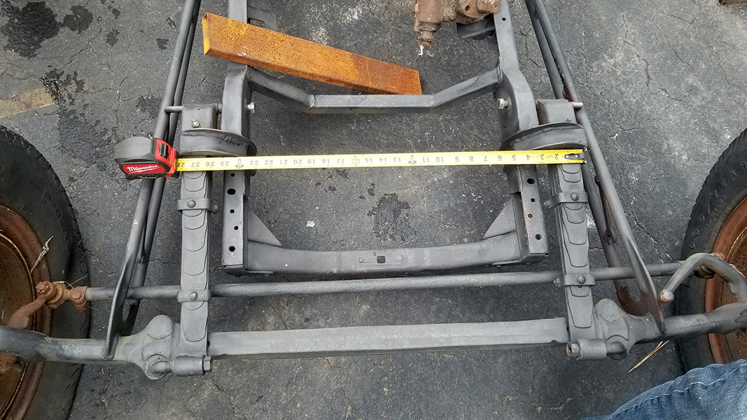

    So, since we are using this Tribute T chassis in a way other than it was intended, we have some things to figure out on our own in regards to things like body & engine mounting and the rear suspension. We want to have pretty stout nerf bars mounted to the frame on the sides without coming up into the body with them but this makes running the rear rods outside the frame a bit tight.
    The rear end kit and the mounts for it put the rods all the way up by the transmission crossmember. With a T5 this puts that pivot point about a foot too far forward of the U joint. Moving that mount back to be in line within the tailshaft/U-joint area would solve that issue but still appears to leave potential for scissoring into where we want the nerf bar to be.
    This kit DOES NOT seem to want to work with old Ford rear rods. We have a set on there now, it was a chore, and the pinion is nose-down a few degrees. We could pie-cut them, but we would still have the potential interference with the nerf bar and the body itself potentially. I though about moving them inboard but that would mean mounting short rods much closer to the rear center or using rods shaped like hockey sticks, neither of which seems ideal. A 4 bar setup would sound like an option but the top bar could want to come up your butt crack if you hit a pothole.
    The kit setup uses a 4 link setup I'm unfamiliar with. It uses race car style single rods on the sides, tied to dropped mounts on the axle tubes with short, angled links to the center from the crossmember.
    7151809_L_bace1f88-8843-46a6-bd2e-fd8237b5d4a9.jpg 7151801_L_467eb6c6-50c1-4eec-9550-bb89c35c86ac.jpg
    I am somewhat inclined to reverse a set of old Ford rods (point them down) and pie cut/gusset them so they're dropped down to scrub and pointed at where they need to go on the frame. This seems like it would clear what it needs to clear and control what it needs to control.
