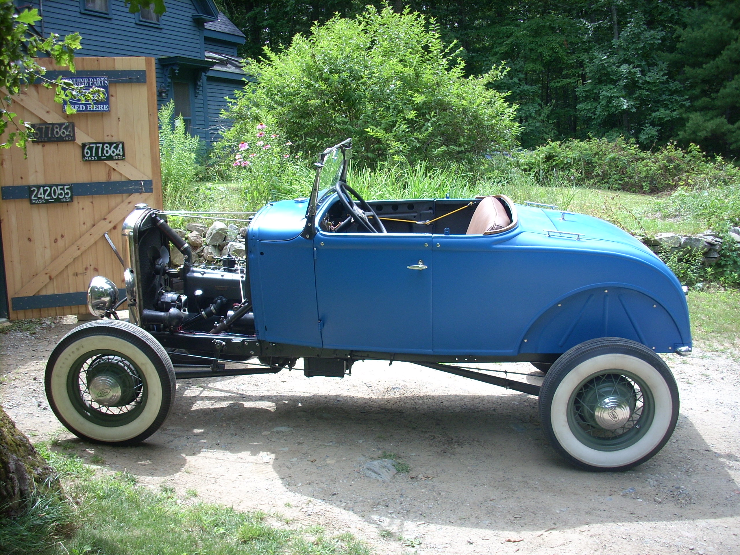

    Thanks for all the support guys! More pictures to come, the car isn't at my house. Mom forbid it. Right now I'm working on getting an engine and tranny. Once I have that, I'll take everything off the frame, spray some rust oleum on it, then install a drop axle and reverse eye rear spring. Hopefully I can figure out how to get the front tires to not stick out so far like they do now. Then the engine and transmission will go in once it's a rolling chassis.

    As long as the frame you've got is straight and sturdy, there's no reason not to use it.
    Buy the Tardell/Bishop book everyone's suggesting. Read it. Also look at Practical Fabrication and Assembly Techniques by Wayne Scraba.
    Are there transverse spring mounts on the rear end already? That rear is open drive, so you can put whatever you can fit in there and afford to get it moving. Inline 6's (Falcon 6, Big 6, Flat 6, Chevy 250) tend to be cheap but are a bit long and could be tough to fit in your build. A GM 350 isn't a bad suggestion for a low-buck, mileage minded build. They can be dressed up to look vintage with some nice valve covers. I just saw 3 350 blocks, two with 4 bolt mains, go to the scrapper recently after nobody would pay $200 for the lot of them... so they can be found cheap for sure. You can run a T5 behind one for overdrive mileage. No, it's not a 3 spd behind a flathead but it will fit your needs until you can afford to build that.
    It looks like you have a stock Model A front end. You are going to want 37-48 spindles (new or original) to run juice brakes. F1 spindles and brakes are another option (cheaper usually but more work in some ways). There are juice conversion kits for the mechanical brakes, but I'd say you're better off just saving up and buying different spindles & brakes. Your rear end looks to have brakes, drums, and hubs, so you're best off rebuilding those and finding wheels to fit the 5 on 4-1/2" bolt pattern for the back (which should be fairly easy and inexpensive because everybody usually wants the 5 on 5-1/2" stuff).
    To get LOW, you'll want a reverse eye front spring and consider using spring behind or in front mounts for the front axle. This can be done to get way low with or without a dropped axle.
