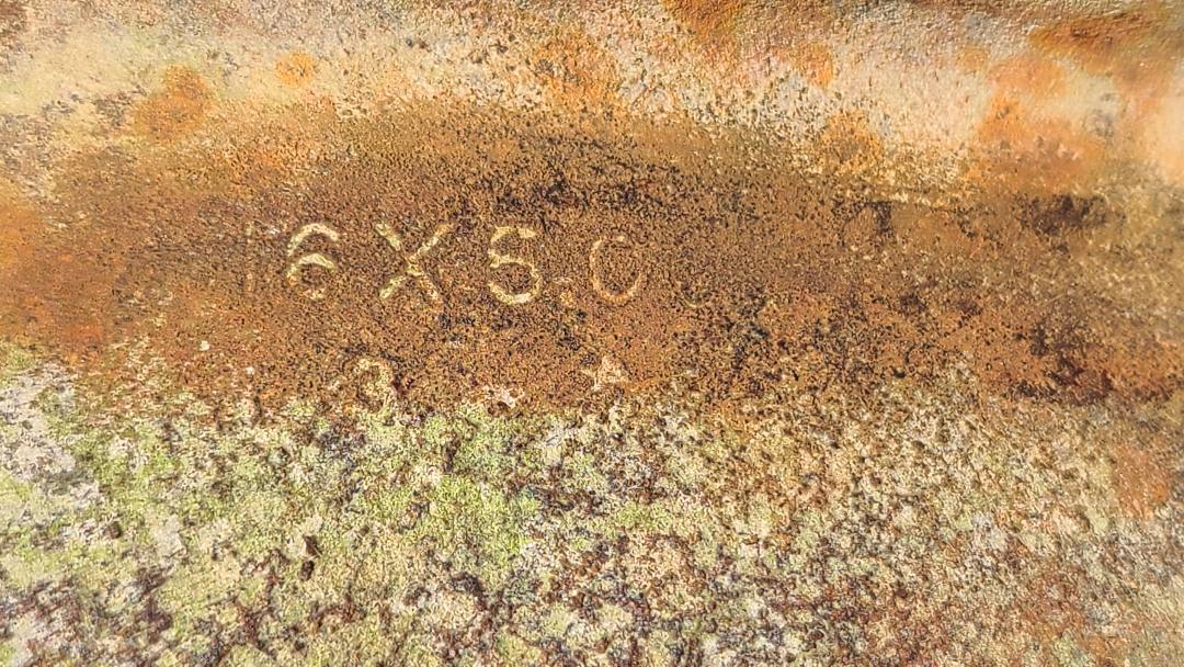

    Hi....If you cant find Buick early 1940's ..look for some Cadillac 75 Fleetwood from 1941 to 1949 pretty sure there 16" also same same bolt pattern....Doug

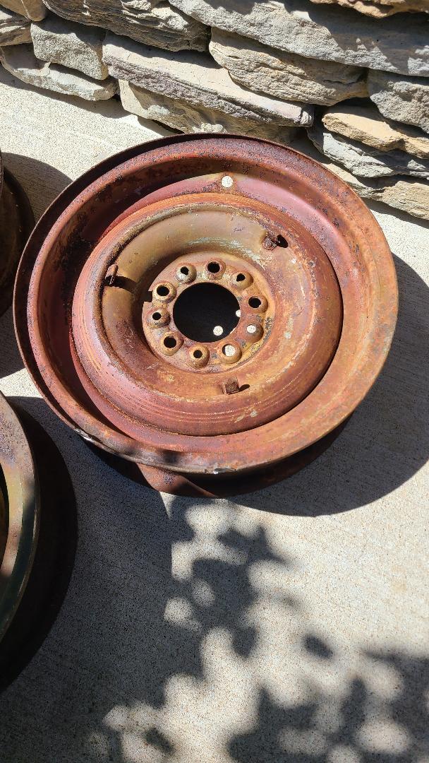

  3. Do those have the same locating pins like the buick drums? theres 12 holes in the stock buick rims for the locating pins and the lug bolts..

    Hey ... I have a set of 1941 Buick rims 16" they do have the locating holes as you have described.....Doug

    Hi ... Had a look at the 16" 1941 Buick wheels behind the shed....they do have locating holes .......Doug
