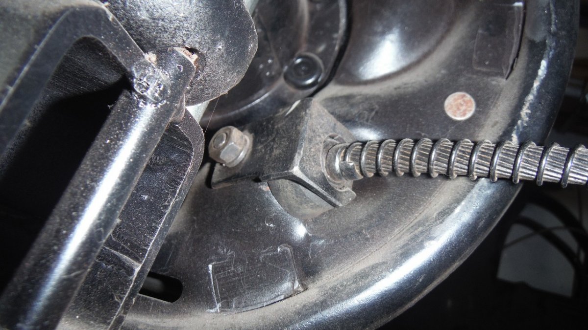

    This is the LEFT side, before it was cleaned up.
    gatz

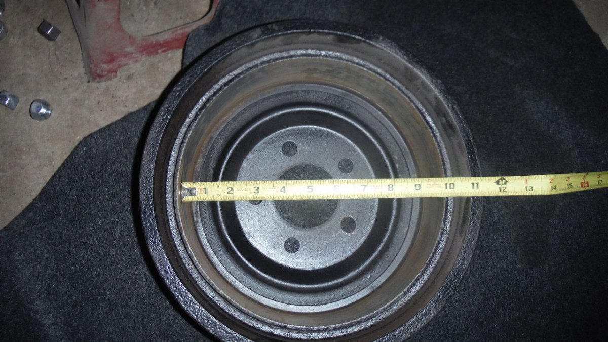

    The brakes on the 67 Coronet rear are 10"

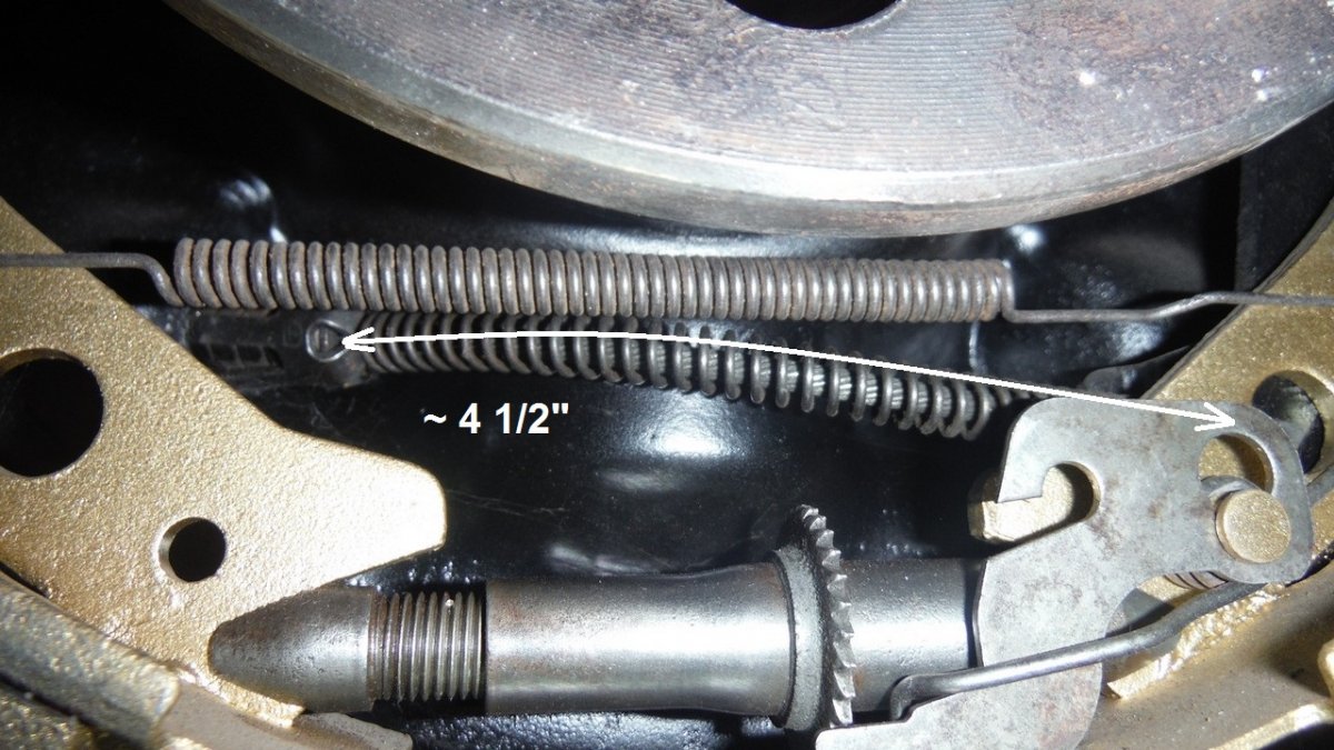

    and, as near as I can tell using a bent wire, the spring is approx 4 1/2" installed.
    So, it may be 5" or more in the relaxed state
    I'm just wondering if the cables would be the same for an 11" drum.

    Gatz, thanks for checking. Those are the short springs. The longer ones are about 6".
