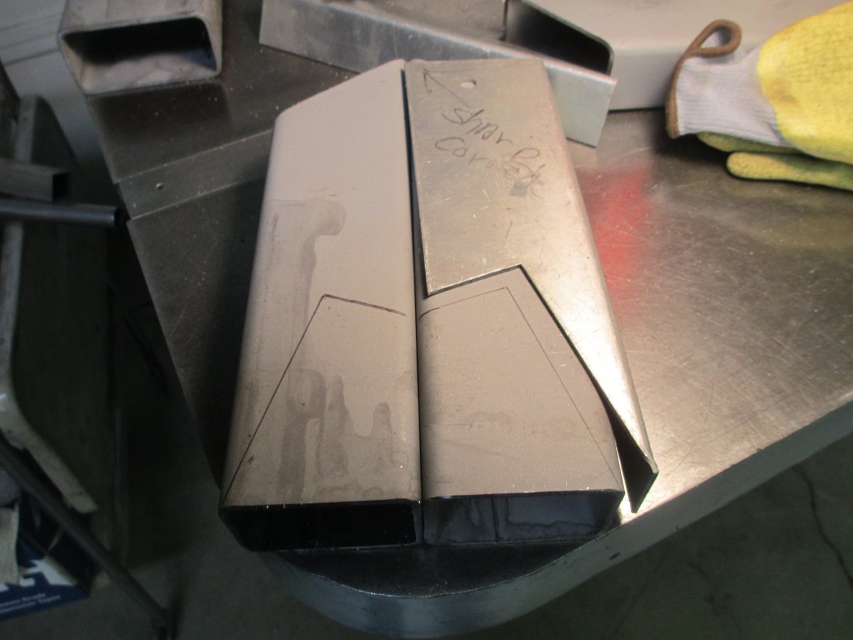

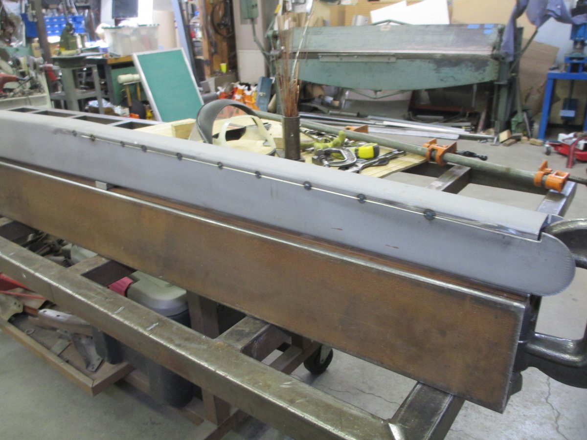

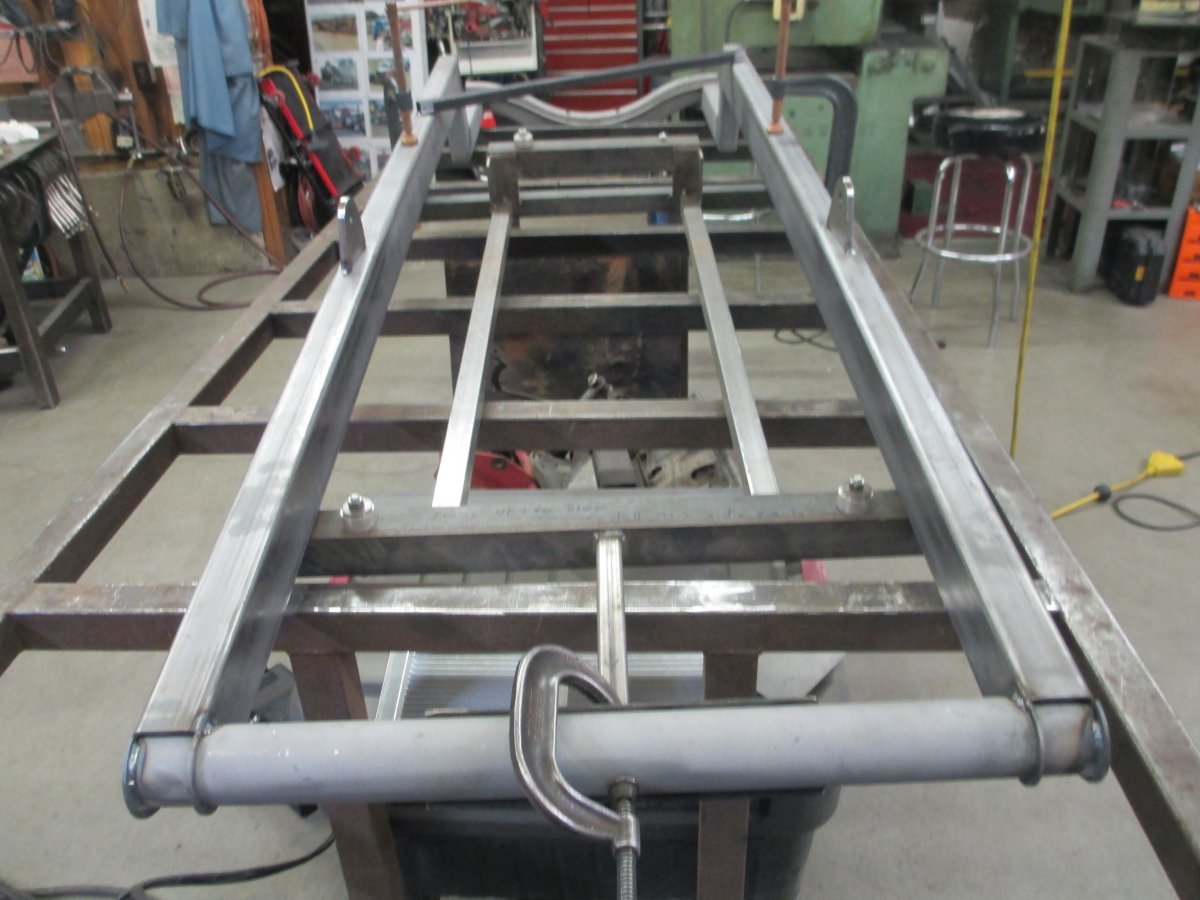

    It all starts with my last pair of laser cut frame rails. When I weld the tapers, I clamp them down to a 6"X 6" square tube, putting a back bow in the front section. The reason is, welding that 3' front section will cause quite an arch to the rail, I only want a slight arch when fully welded. The 7th picture shows all of the templates I used to replicate all of the previous cars. As we progress, it will show all of the fixtures I developed for setup and welding of the rest of the build. More pics to follow shortly. IMG_3792.JPG IMG_3794.JPG IMG_3800.JPG IMG_3818.JPG IMG_3819.JPG IMG_3822.JPG IMG_3836.JPG IMG_3838.JPG IMG_3842.JPG IMG_3851.JPG IMG_3846.JPG

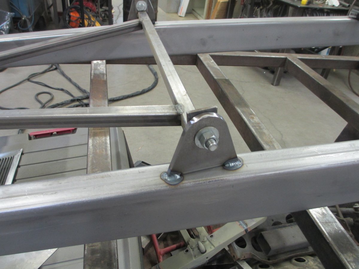

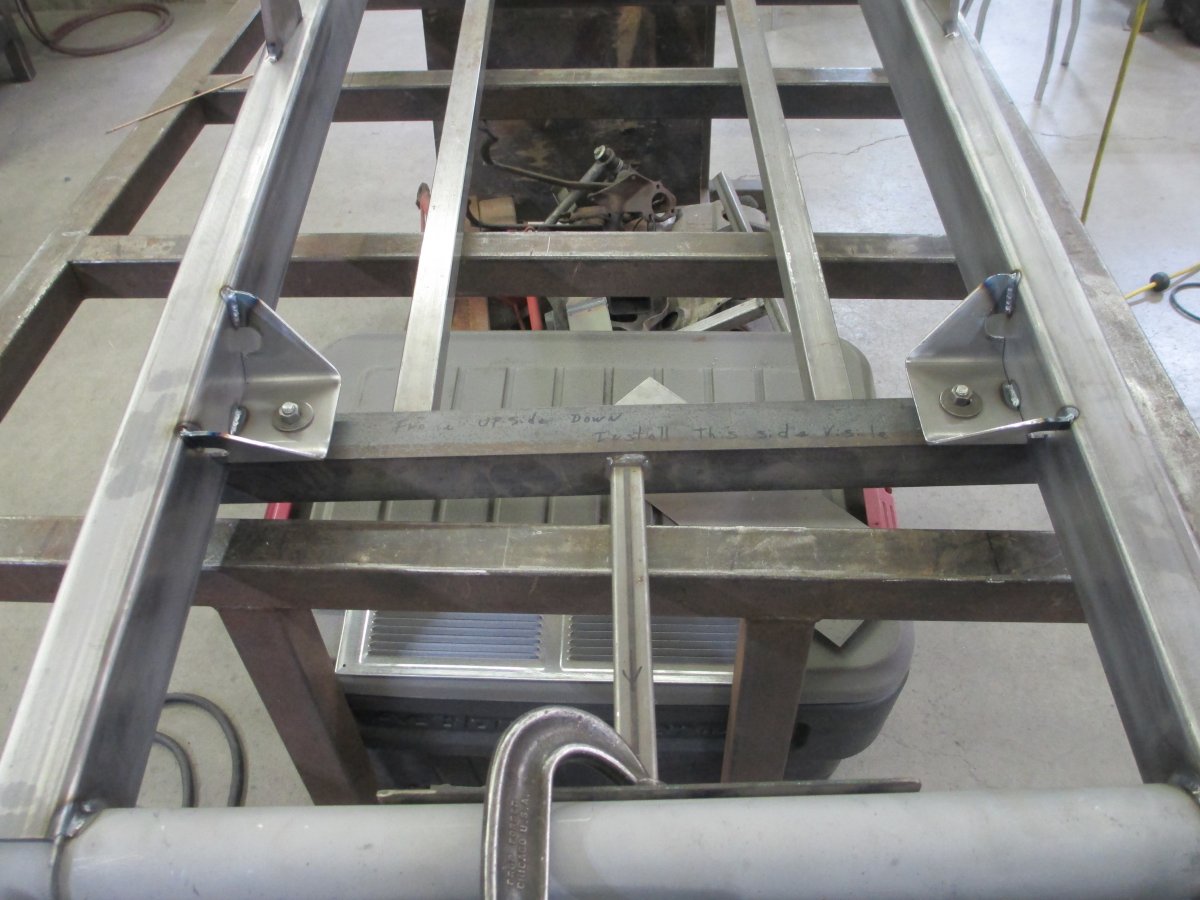

    Moving along, this covers the assembly of the perimeter frame using a stock Model A rear crossmember and the installation of the front radius rod mounts. The last shot is the fixture for the front engine mounts, which will be next. IMG_3853.JPG IMG_3854.JPG IMG_3849.JPG IMG_3855.JPG IMG_3856.JPG IMG_3866.JPG IMG_3867.JPG IMG_3871.JPG

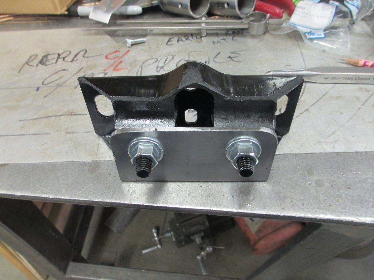

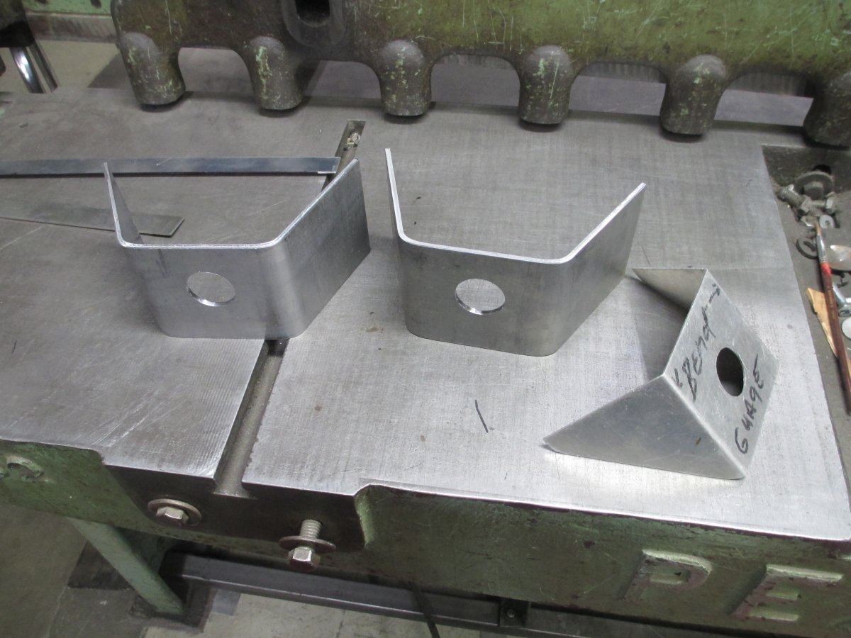

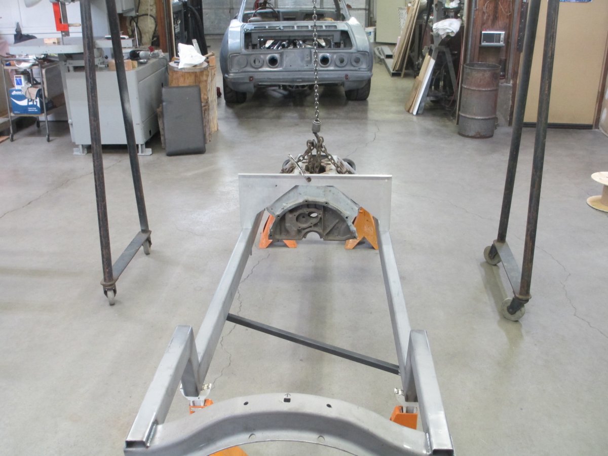

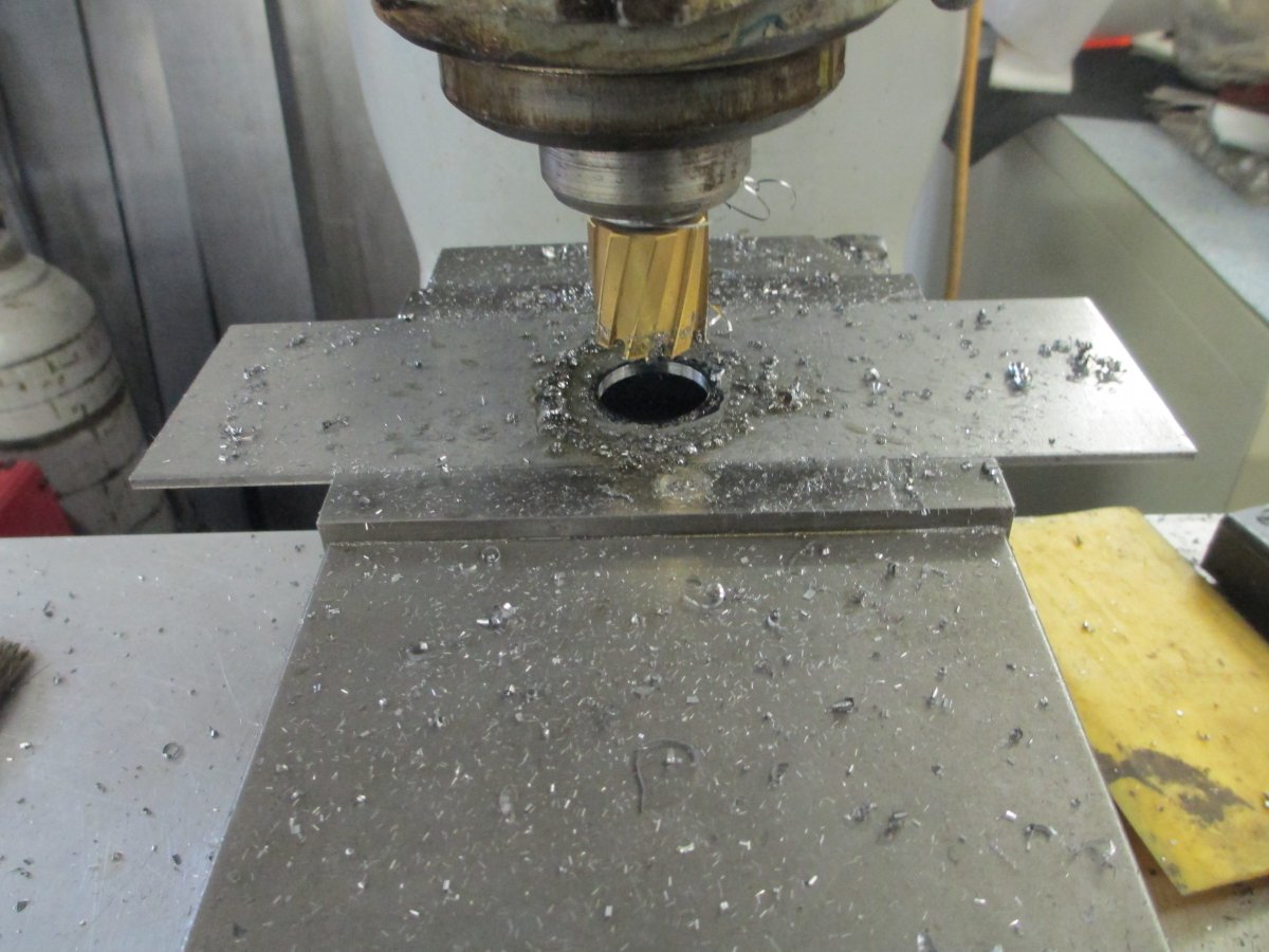

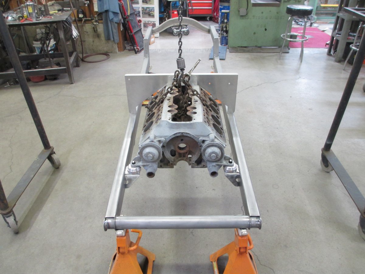

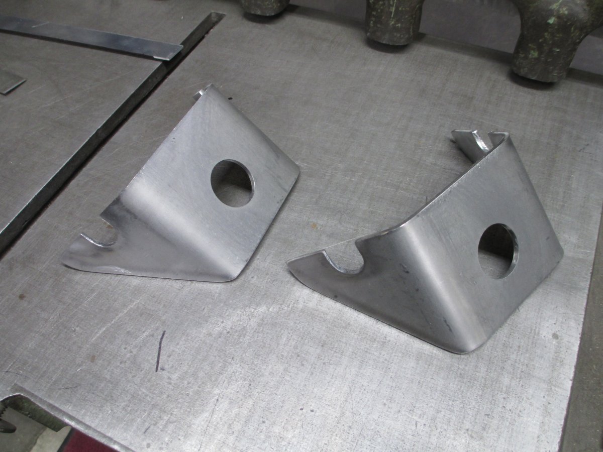

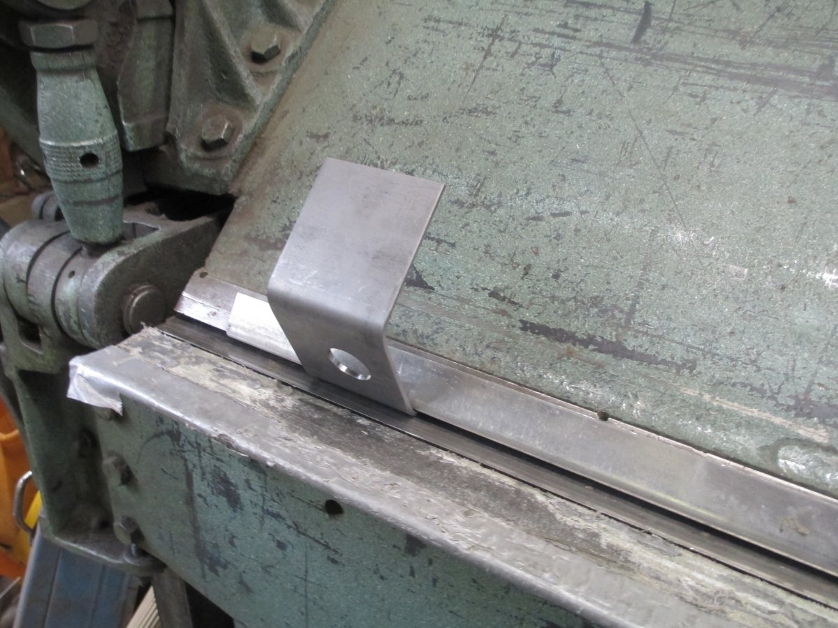

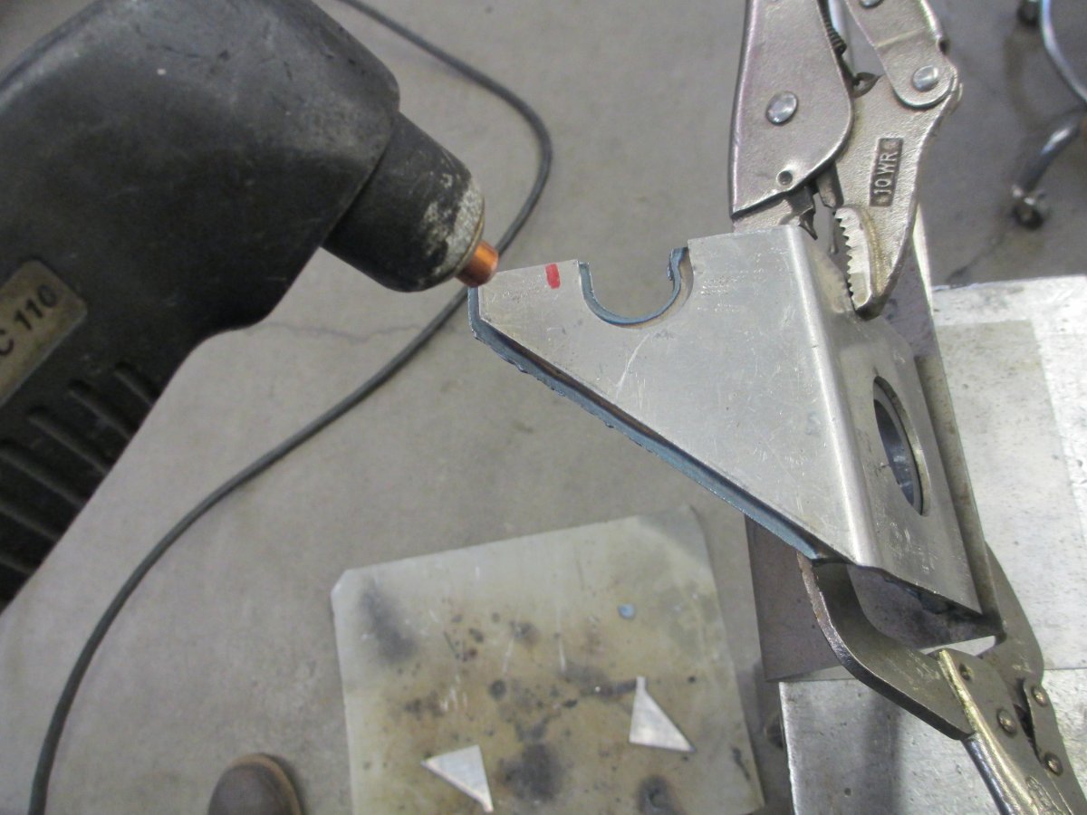

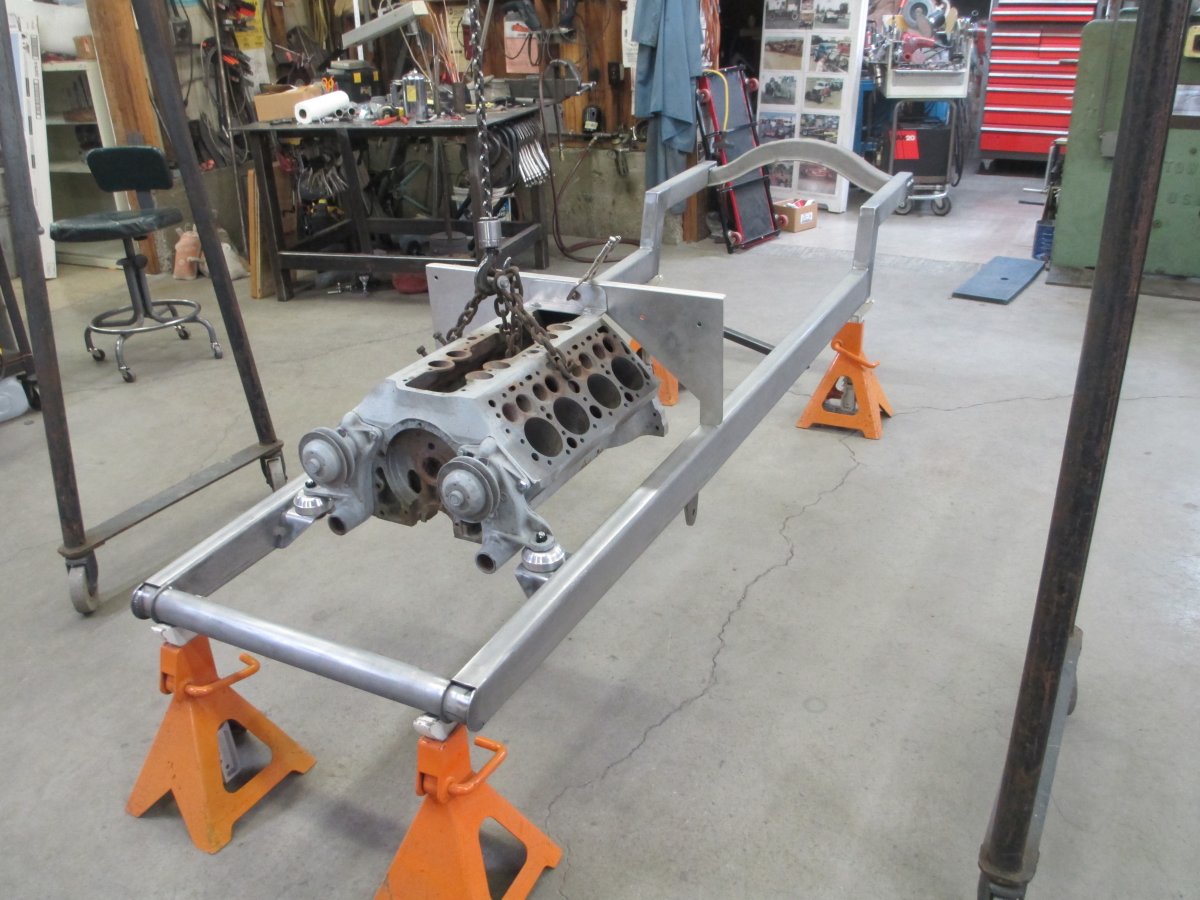

    Engine mounts for 8 BA Flathead are fabricated from 10 ga P&O steel. I machined up a pair of aluminum biscuits for setup purposes, as they hold engines solid, and it will utilize Bob Drake mount cushions. That's it for today, as I need to dig out a bell housing and trans to install tomorrow. IMG_3873.JPG IMG_3874.JPG IMG_3877.JPG IMG_3875.JPG IMG_3878.JPG IMG_3879.JPG IMG_3880.JPG IMG_3881.JPG IMG_3882.JPG

    I'm trying to understand the laser cut frame rail bit. Is the starting point a piece of a rectangular tube? The laser part is the vee cut? Held apart by the wood blocks because?
    The drawing looks like the rails might taper on both ends, more at the front and just a bit at the rear. Or, is that just an optical illusion?
    If a guy was just going to build a one off, would it be more cost effective just to cut the wedge out with a jig saw?
    Damn, you weld good!
    Be ready for more questions from here. I want a track roadster REAL bad!!!!!:D And I got a torch and a hammer! :eek:

    Thanks for the rapid replies ! Bruce, if you want one, build it no matter what you have for equipment. As far as the laser cut rails, I had 6 sets done a the same time, and it really saved me a lot of time. If you have a saws all or jig saw, clamp a piece of 1/4" flat bar to the tube to act as a fence, and get after it ! The one thing about a Track Roadster that is appealing, is they are labor intensive, but materials are relatively cheap,and front and rear axles can be hand me down old Ford parts. No better thrill for the dollar.

    Bruce, the reason for the wood blocks, is to hold it apart while grinding a weld prep on the joint, for proper penetration. The split bones up front, requires the frame to have torsional rigidity.

    I bought a very nice stamped steel, 49-51 passenger car bellhousing from my pal Ernie. The key is to have all the correct clutch fork assembly and starter plate for this unit, and he had it all. I had to borrow a transmission for set up, as the only 3 speeds that I have, are the RAT heavy duty ones, that will not work with the T-150 Jeep top shifter. I remove the outside/top ears from the trans as pictured in the last pic, because the trans is exposed. IMG_3883.JPG IMG_3885.JPG IMG_3886.JPG IMG_3887.JPG IMG_0672.JPG

    Trans mount crossmember bent, fit and tacked in place. Center gussets and diagonal tube "K" braces are next. Can't wait to remove the 1" square tube temporary brace. IMG_3888.JPG IMG_3891.JPG IMG_3893.JPG IMG_3894.JPG IMG_3895.JPG IMG_3896.JPG IMG_3897.JPG

    King, P&O stands for "Pickled and Oiled". It's "Hot Rolled" steel, that has gone through a chemical process to remove the blue mill scale from the surface, then oiled to preserve the clean exterior. It makes it nice to mark on, bend, and especially clean for Tig welding. Did you notice how clean the frame rails were ? I had them sandblasted to achieve the same result.
