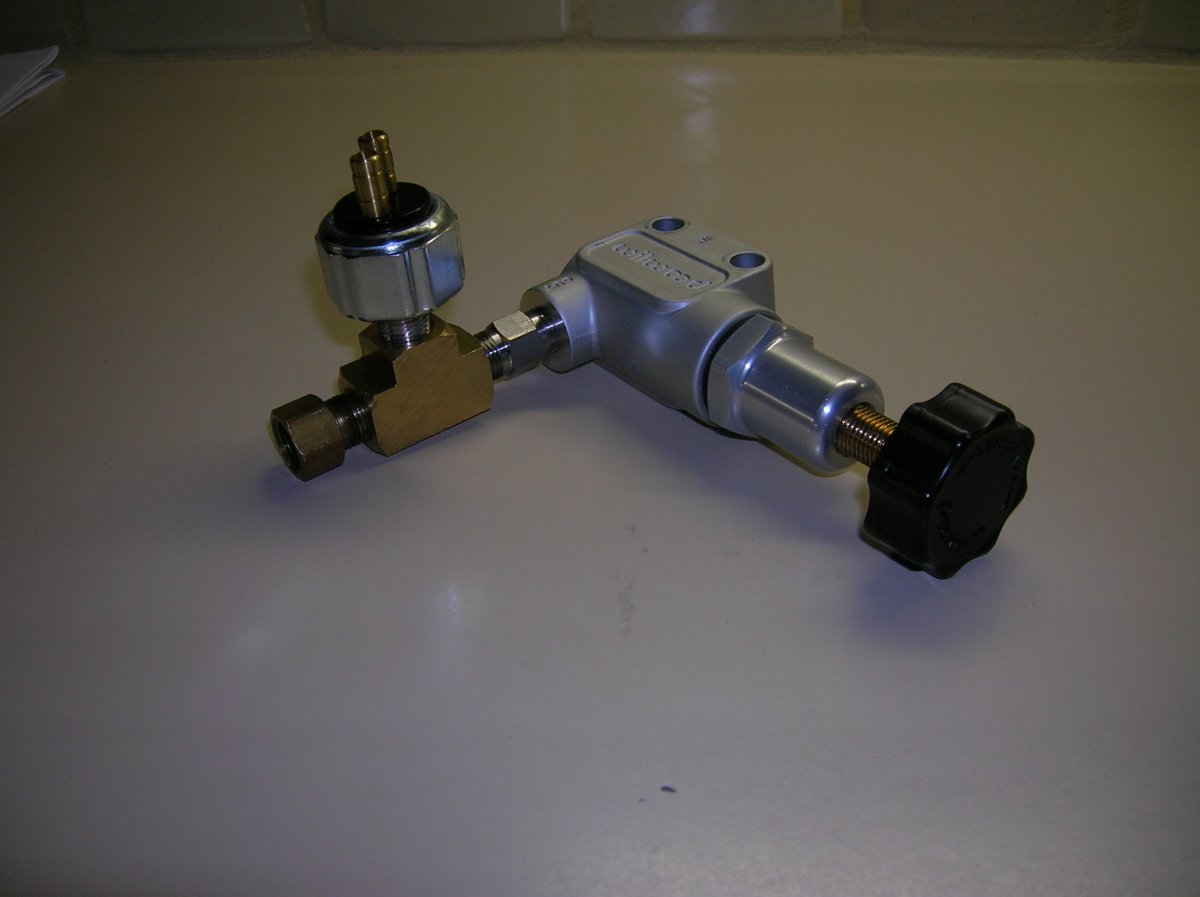

    The 1/8 npt brass tee fitting in the photo looks like it should work? I've have seen similar fittings on brake systems. The stainless hex nipple is rated for 9,100 psi., but the brass Tees are only rated for 1000 psi. I'm guessing this may not be safe? Anyone know for sure? DSCN2466.JPG

    Should be just fine. Seen it in use many times without any problems.

    You’re all good

    That's exactly what I used. The original brass junction block in my Bronco has been there for 54 years with no problem.

    There were three in my 56 Ford from the factory..
  6. Use a good brand of brass like Edelman.I once picked up a piece of brass at a hardware store that leaked brakefluid right through the wall of the fitting.Seems hardware fittings are made from pressed cindered brass so it looks solid,but isnt.

    Get it at at napa or your favorite auto supply not Lowe’s or Ace

  8. Street tee would eliminate using the extra nipple.

    Parker or Sweglock has what you need in steel or stainless steel . My old Harley has 2 in the brake system . If I trust them on 2 wheels 4 should be no issue what so ever .

    The street tee is Weatherhead 3750X2.

    How much pressure do you think you can generate with your right foot?
    Sure as hell isint 5000 psi. It will be fine. Most automotive brakes systems before 1980 use brass parts. They went to coated steel because its cheaper, not better.

  13. Often an inverted flair is what gets used, but NPT also is used on brake systems. The edge that @Steve Lowe has here is that he used a hydraulic fitting as opposed to a water fitting. That is the biggest mistake that I see most people make is that they got to the hardware store and walk out with a water fitting, which works but is not correct/
    OK I said all that to say this, yes it'll work fine and I agree with @BJR 100% ;)

    No problem with the fitting you are using, to use less fittings & cleaner look , you could get a male pipe with a female inverted with female pipe T .
    Some brass fittings are getting hard to source,
    About a mouth ago , I was looking for a inverted 3/8 tube female to male #6 Jic , called weather head and , Parker & few othe company's, No one made it I was told, So last week I was getting ready to Machine a few , then seen that Earl's makes it in steel , $8 each versus few hours worth of tooling ,I Purchased six of them.
    The pressure switch,, I know alot of people use it , But I will not use one ,Specially on a single Reservoir Master cylinder. I have had a few people ask me to install one . I have seen 2 out of waybe around 50 blow out over last 30 yr . & HD uses them on there Bikes.
