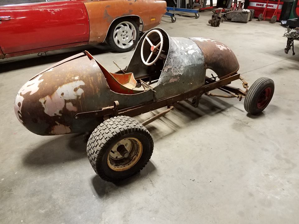

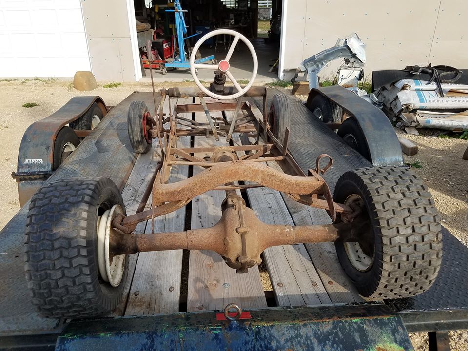

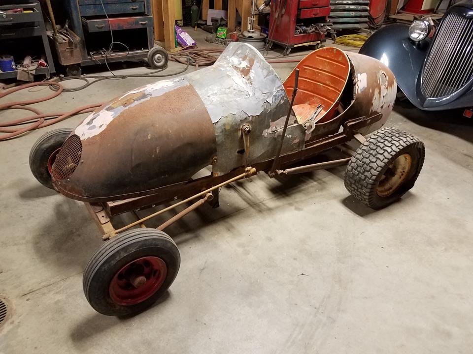

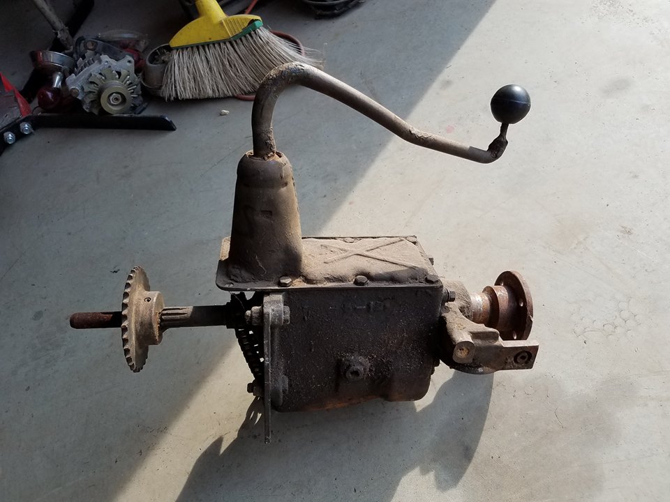

    I picked this up today. It has a narrowed Model T front and rear axle, early 30's Dodge or Plymouth 3 speed manual trans. Model T brake lever but not sure what it was connected to. No motor. Motor was mounted up front and seems to have been connected to the trans with a sprocket and chain. Is this a very early 1/2 or 3/4 midget??? midget1.jpg midget2.jpg midget2.jpg midget5.jpg midget3.jpg midget4.jpg

  3. That's neat!
  4. Looking at the sprocket on the input shaft, I'd say some sort of motorcycle engine powered it. And when you open up the trans you will probably see it was just used as an in and out box.

    alchemy that is the same seat I have. I know it didn't come with my little race car. The guy I got it from said he picked it up at a swap meet to use in the car. I know nothing more on the seats origin
