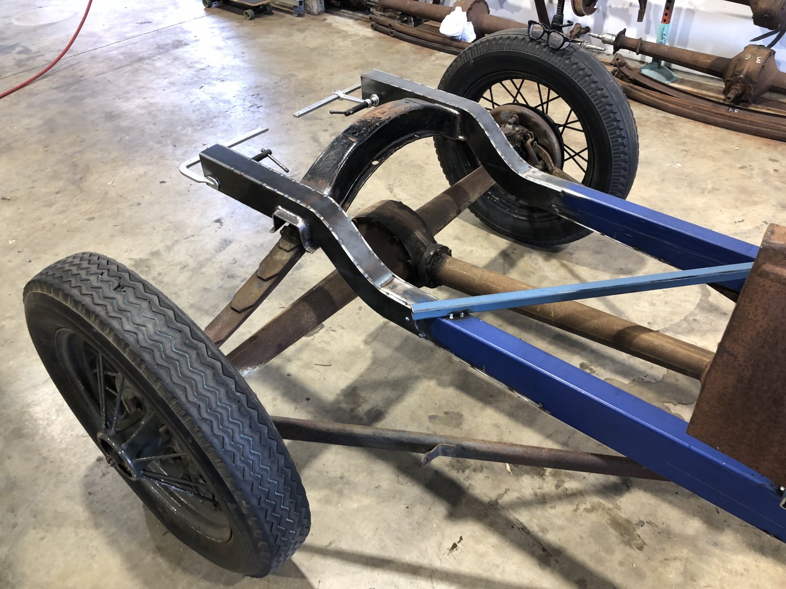

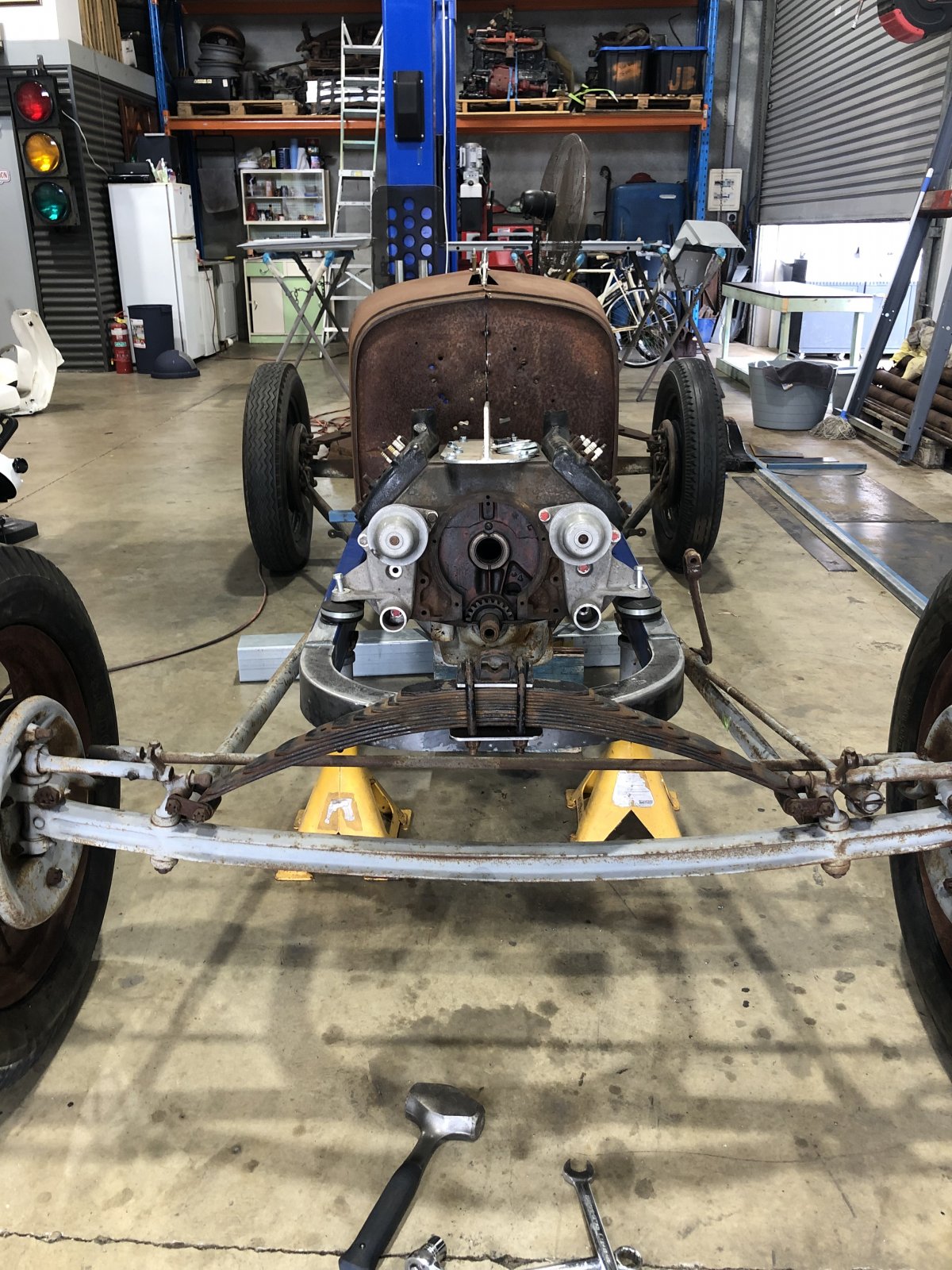

    I’ve spent only just 3 days so far but feel I’ve made some progress.

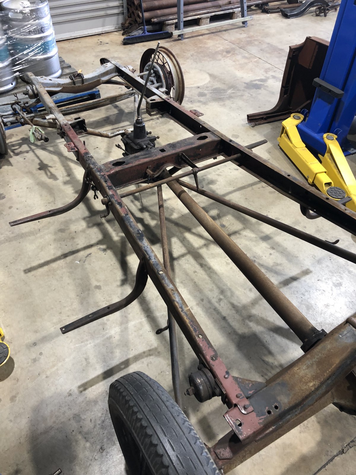

    I picked up a rolling model a chassis. Sold the frame to a good mate. And will use the front and rear axles and wheels etc.

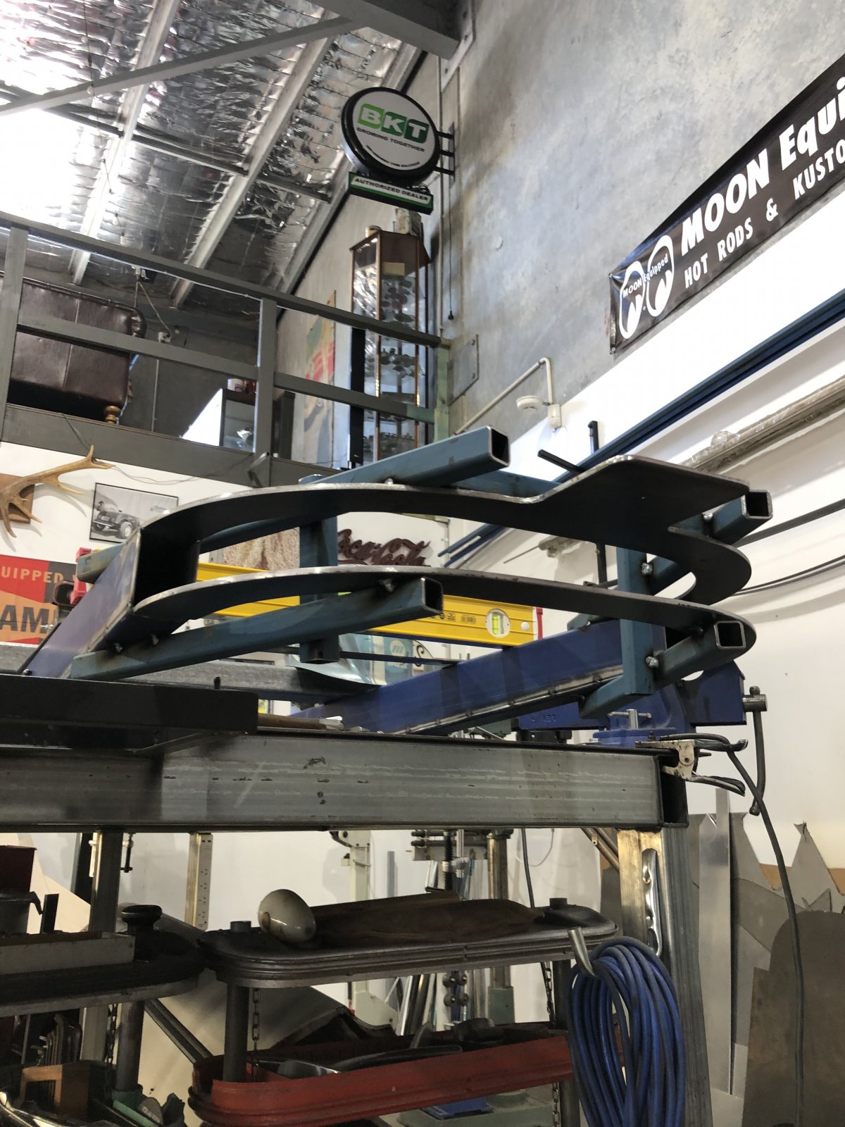

    The frame rails are box tubing that will have oval sections taken out at a later time. Wheelbase is 94” and frame width for outside is 24”
    I will finish off the frame over the next few days tweaking the springs and getting the ride height where I want it, it will be flathead powered with a 39 box (maybe an early overdrive)
    I’ve sectioned, trimmed and cut a cowl (can anyone identify it) to suit the 24” wide frame and will fabricate the rear section as I go and make a nose and grill setup as well.
    Here’s how I’m going so far:

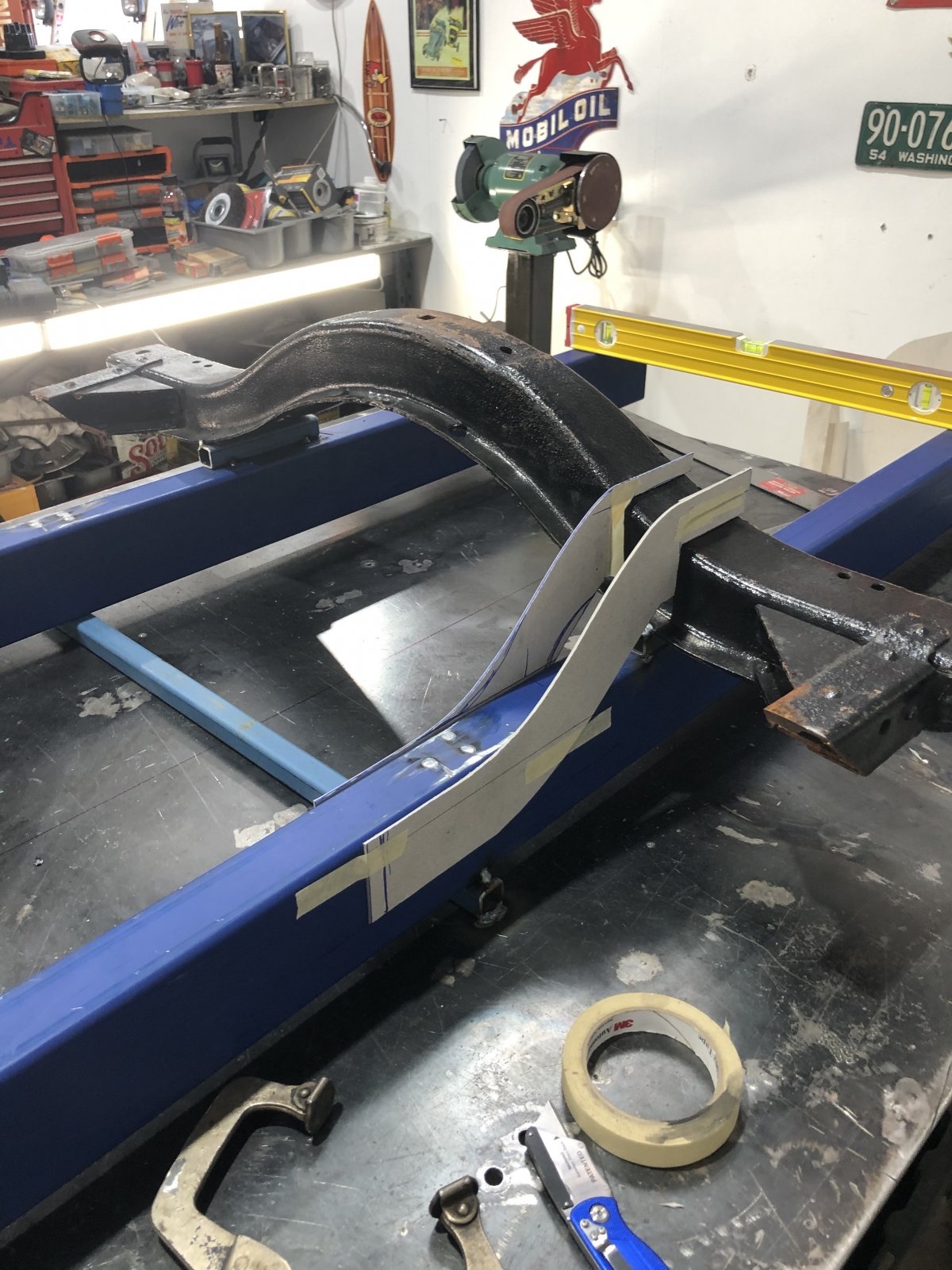

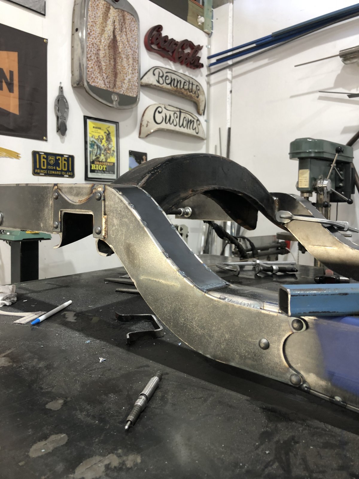

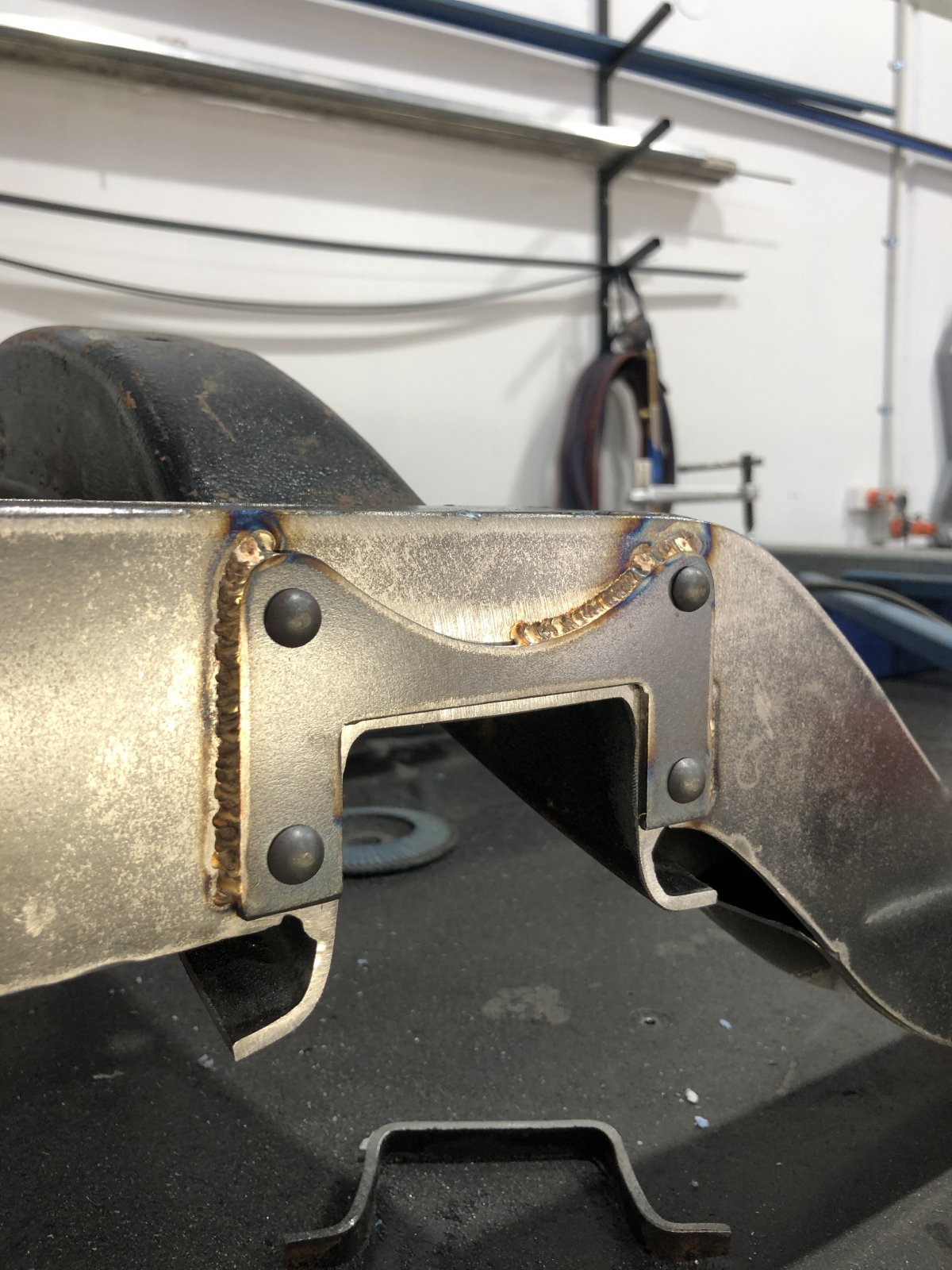

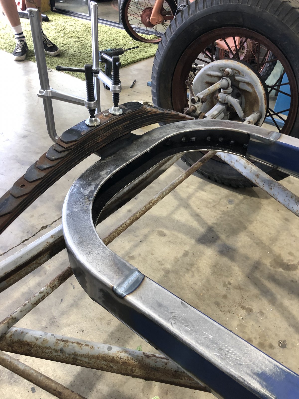

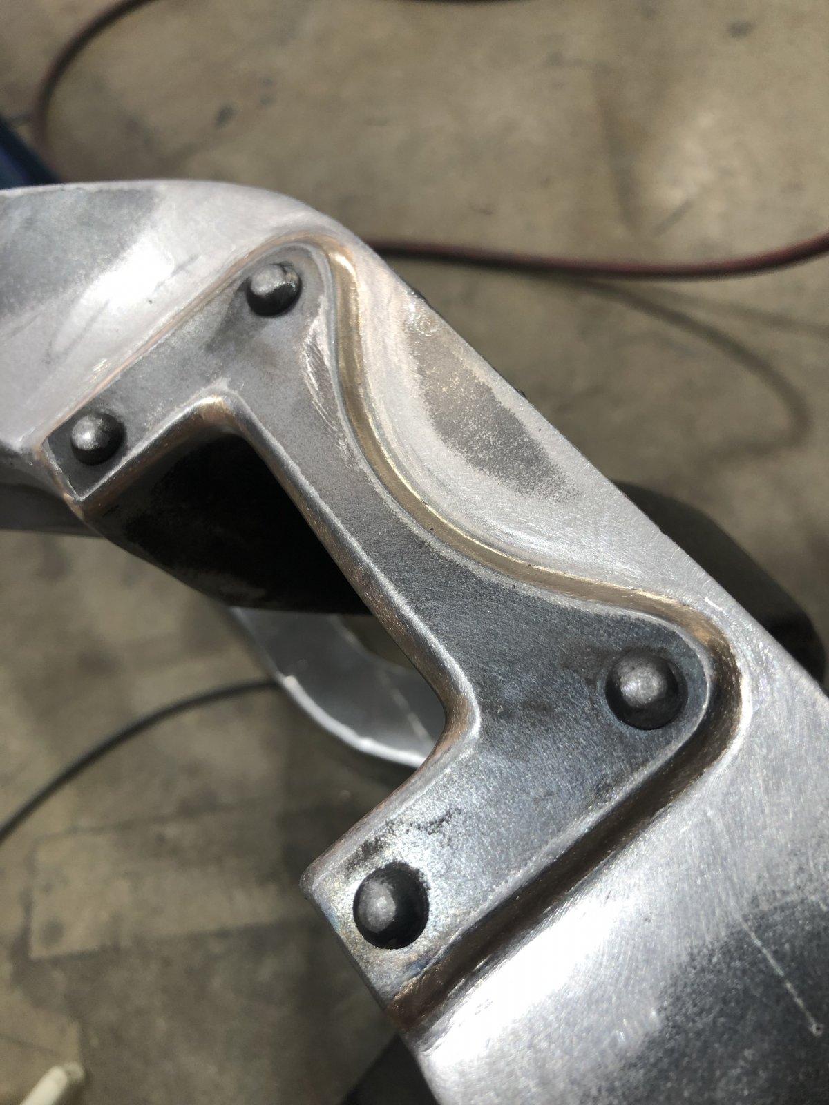

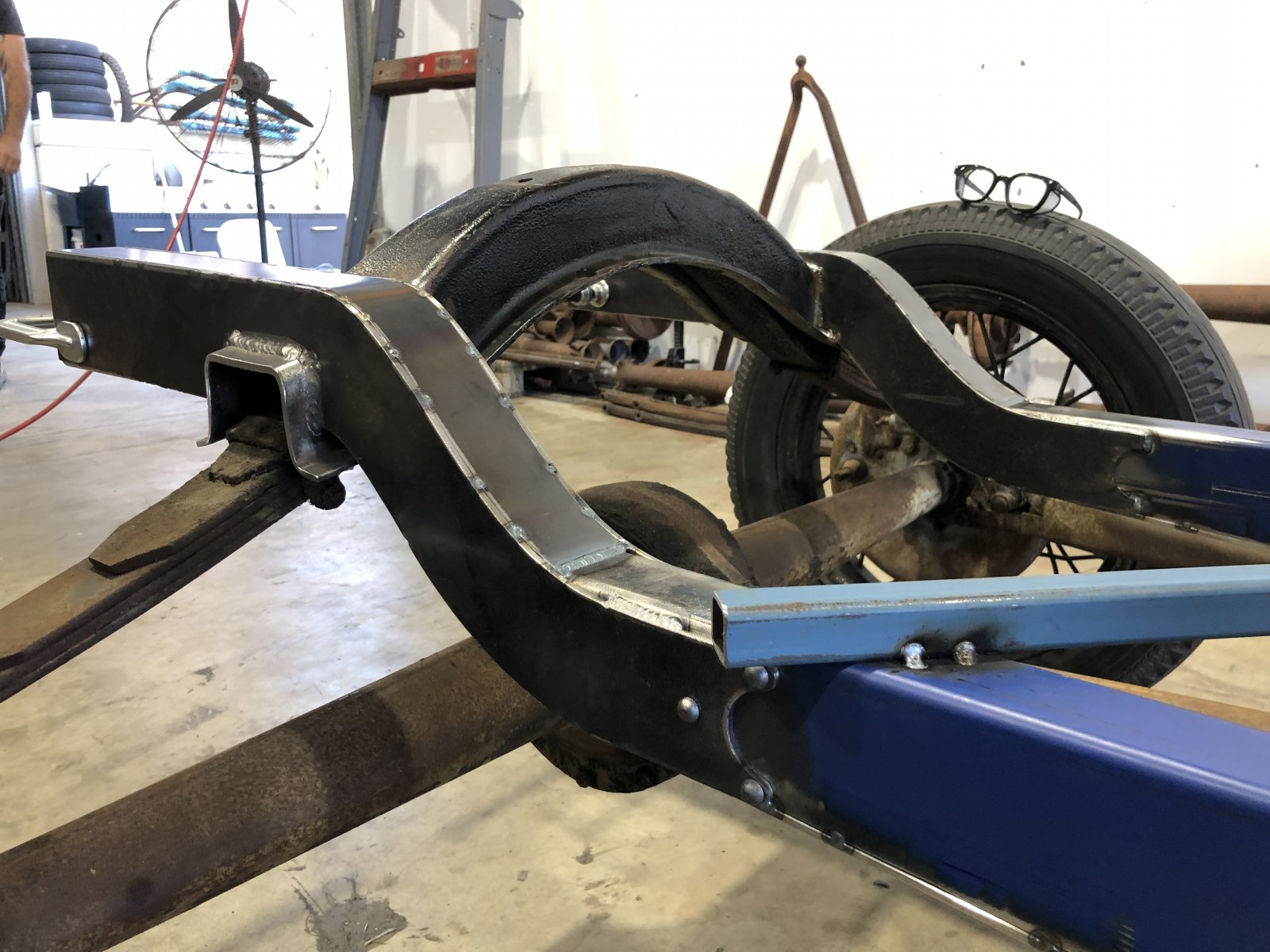

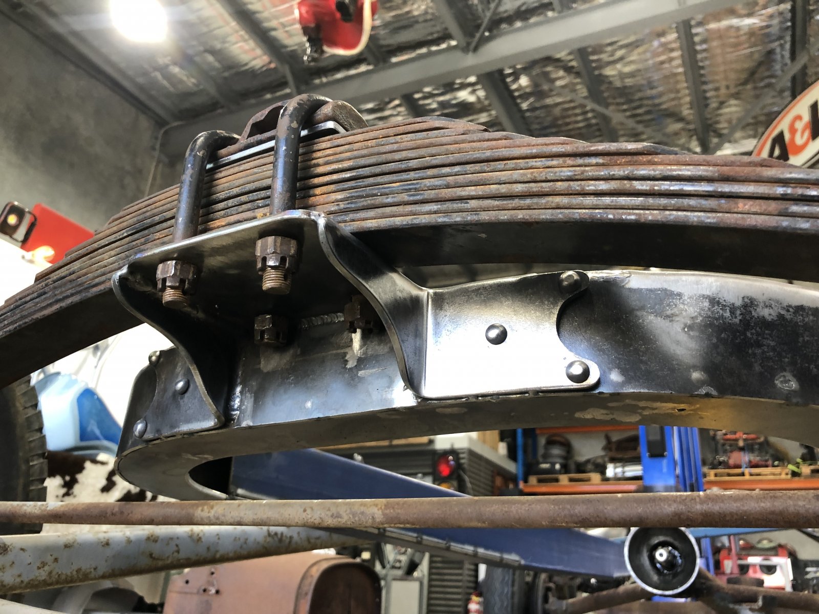

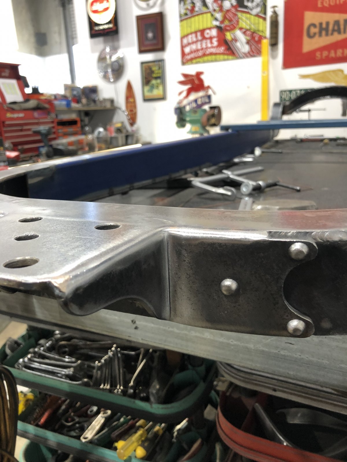

  4. Today I managed to get a bit more done, I cut the rear model a crossmember flush and added a plate that’s welded in with silicone bronze to finish off the out side frame rail, I welded in the lower portion of the the kick ups and blended them in. I also added some gussets that play a role in the look of the frame I’m going for. Here’s some shots 8BF12DFE-6457-4DD4-98BB-61697B772078.jpeg 45DF4B9E-D197-4C4D-B87A-9A94725CADE1.jpeg F7BF54FD-3478-4EB4-84FD-BEA427C05BEF.jpeg C9F549C2-486B-4009-95F2-CD1069523079.jpeg B4526BF1-F93B-4118-A20B-8C00B1AA53D0.jpeg C5863513-F418-42AC-AEDB-89485E1DD66D.jpeg 564307C1-3C66-4F85-B2FA-1F66FB361938.jpeg 607C8DBA-FD88-4F2E-B417-DFDA12D350C9.jpeg 07AC8312-32D0-4557-A9BA-43357EA74C6D.jpeg

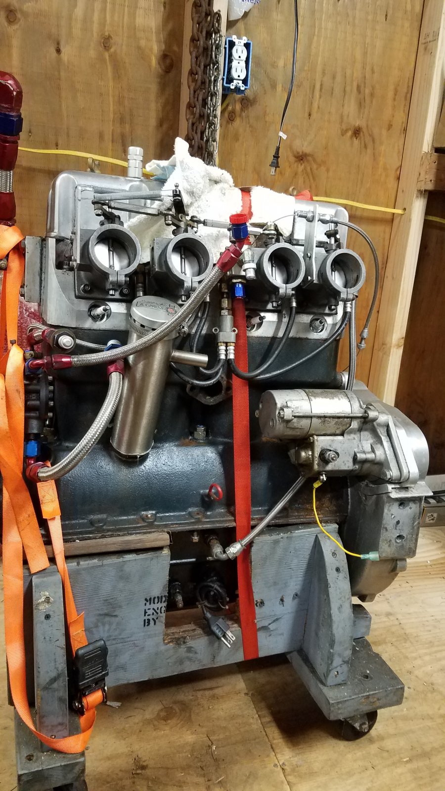

  6. I really like the uniqueness of what your building. Craftsmanship shows it's not your first go round. My first thought seeing it with just another Flathead was "and then another Flathead". Not knocking a Flathead, God knows I have some of my own. What your package needs is more true Vintage Race H.P. to stand out amongst the rest. How about a Race Ready O.H.V. (Drake) B Banger. Ready to bolt in add fuel and a Kill Switch. This is a B-Ville record setting motor that would be right at home between your Rails.

  11. I should get out my B-Ville rule book. I believe other than braded steel lines, high torque starter and the throttle cable the motor fits the pre 39 mark. It will take a stock A trans, (that's what was behind it) stock A starter and the Pump isn't high pressure. Pretty sure Rubber hose would do the job as well. The class it ran in is Stock Body Vintage Model A. We couldn't even remove or drill holes in the Visor or change the Cloth top insert. The only upgrades were Safty Related.

  13. I know when people see his motor they think "That's a lot of $$$". And they are right if you're building through a Machine Shop. I also know what it takes to build a Flathead 8 through a Machine Shop. We also never brake even when they go to a new home. If you still have to buy over the counter everything for the inside and pay for any kind of machine work I can soften the Hit and save you a ton of time. That little Motor red lines at 5960 rpm's and at 5500 rpm makes 218 ft lbs torque max of 232 and 231 Hp. You'd be showing a lot of the V-8's the Ass end of your little skinny butt.

  17. 054C9C9D-8D67-4059-B484-725809E630A9.jpeg 96628518-D62B-42B2-B782-B600B6EE82D1.jpeg 3FB57525-E22C-481C-85D5-0783DDA007E6.jpeg 7AA7F277-8CE4-4E80-AA01-F6F6984B8149.jpeg Finished off a few plates and blending. The frame should look nice once painted black

    Can you show us your riveting tech please? When your plates are welded, it doesn't seem thar the rivets do much of anything but it sure looks good.

    Of course they add something...its now an absolute brick shithouse and then some...and yes it adds some vintage ambience...
    It also seems these are the real deal and added prior to the welding commencing...
    The late Hamber Langy used to add rivet like caps or reworked fasteners in his framework for the factory look...
    Like you I'd like to see the method Jorda uses...I wonder if Henry waffled the frame rivets?
