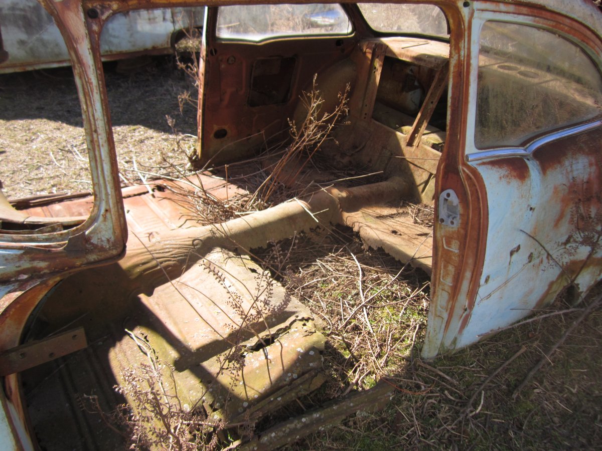

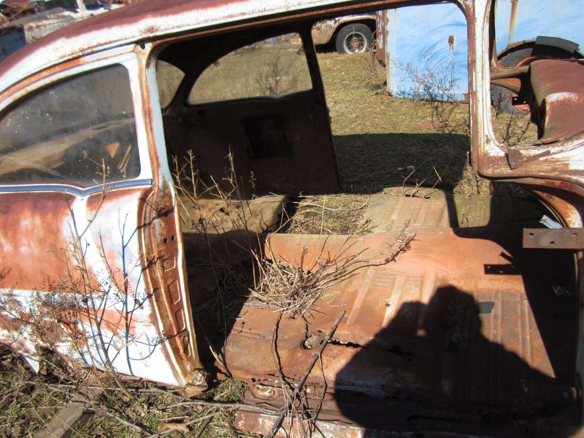

  12. I have a Ok 55 2 dr wagon. and around back have a 55 2 dr sedan. and two 56 2 dr sedans and three 4 door 55,s. and a 4dr 55 wagon. However those 2 drs I have would be more work to fix them than to convert the solid 56 four door I have. there dosent seem to be any ready willing and able buyers for the 56 more door? Rusty Chevrolet 010.JPG Rusty Chevrolet 009.JPG Rusty Chevrolet 011.JPG Rusty Chevrolet 001.JPG 56 chev Bel Air 004.JPG 56 chev 4 door 034.JPG

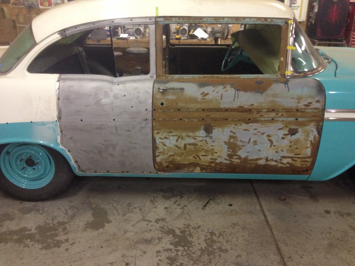

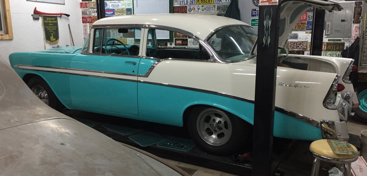

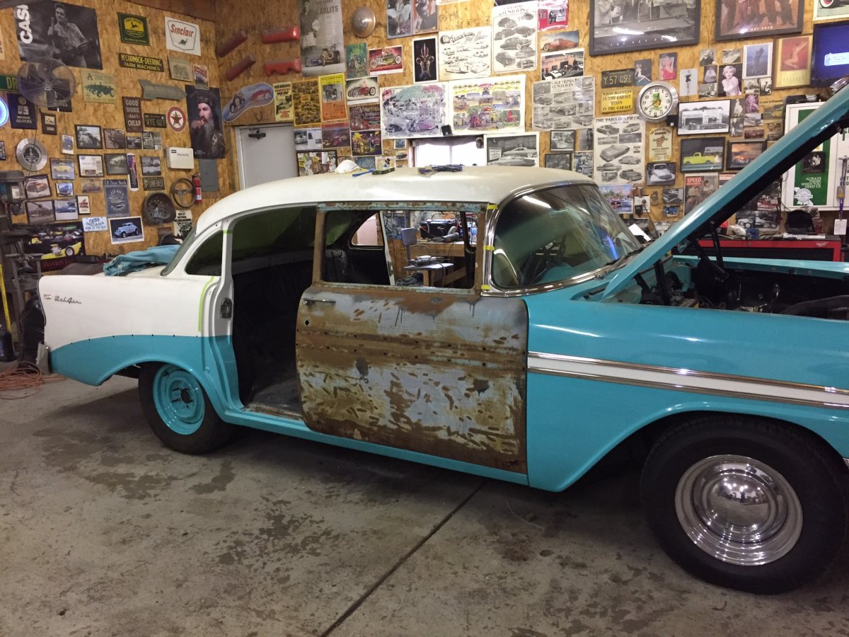

  15. You can do it!!
    9577242B-E056-49CB-9CC1-6BF9444EF154.jpeg 3300BA02-79EF-4F5A-BDED-DDAD1E472B85.jpeg 9C3C83D2-1DBF-4751-AC13-238AA0412E6D.jpeg
  16. Wow!!
    That makes it look relatively "easy"...
    Any more pics, Scotty T?

  18. I can’t take credit for the work, I dropped off a nice quad cab and a two door carcass. And picked up a painted two door. I don’t have any more pics that are any better than these.

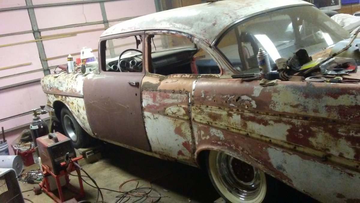

    I've done a bunch of these and I'm working on a '57 right now that is using '55 doors and donor sections. You don't end up using any of the rocker panel anyway, and the wheel opening areas are different but again, if you make a filler panel none of that is going to matter. Here's some poor pics of my '57, one with the '55 quarter chunk in place and another with the filler panel made from the old back door skin. It'll work fine. I have detailed pics of where to make all the cuts and what pieces to use, was going to write a build thread at some point but I can share them with you.
    It's not all that difficult. Time consuming maybe, but not that hard. I figure this one will take me about 100 hours to do, and that's including a lot of work on the bottoms of the doors that I'm using (they're rough) and welding up a bunch of unused '55 trim holes.
