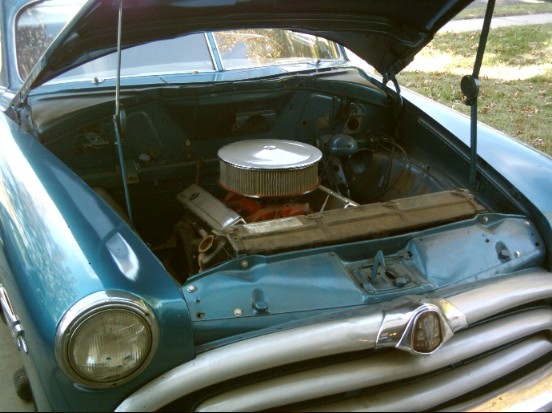

  8. My 389 isn't slammed into an engine compartment yet but I' workin on getting it to look right first. I found a pair of original 55-56 valve covers that had been chrome plated back in "the day" at last years' swap meet. I got an extra strato-streak plate from Injected A and I think they look marvy!
    I bought a nice pair of chrome air cleaners for the dual AFB's at the HAMB drags last year. I think a pair of dog-dish caps will look great for air cleaner tops. I have a pair like the ones pictured at the beginning of this thread and some earleir ones with big block letters and and some killer 49 Pontiac caps with script lettering!
