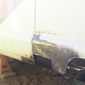

Three of the four rocker corners are goint to undergo this. Floors got the worst of it. Leaky windshield gasket (in Washington, no less) caused most of the rust damage.

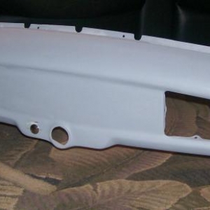

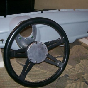

Dashboard filled and smoothed w/handmade speedo bezel. Steering wheel hub is also handmade from a stock Met wheel center.

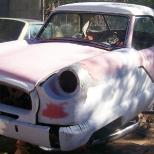

This side is very close to a finished product. Headlight scoops are from a '64 MGB. The stock side trim will need to be shortened about 6". Bumpers will have to be reshaped to follow the new contour on the front pan. I started to mark a new wheel opening contours, but my wife caught me!

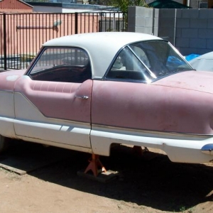

It's actually not in bad shape considering it lived its first 43 years in the Pacific Northwest.
