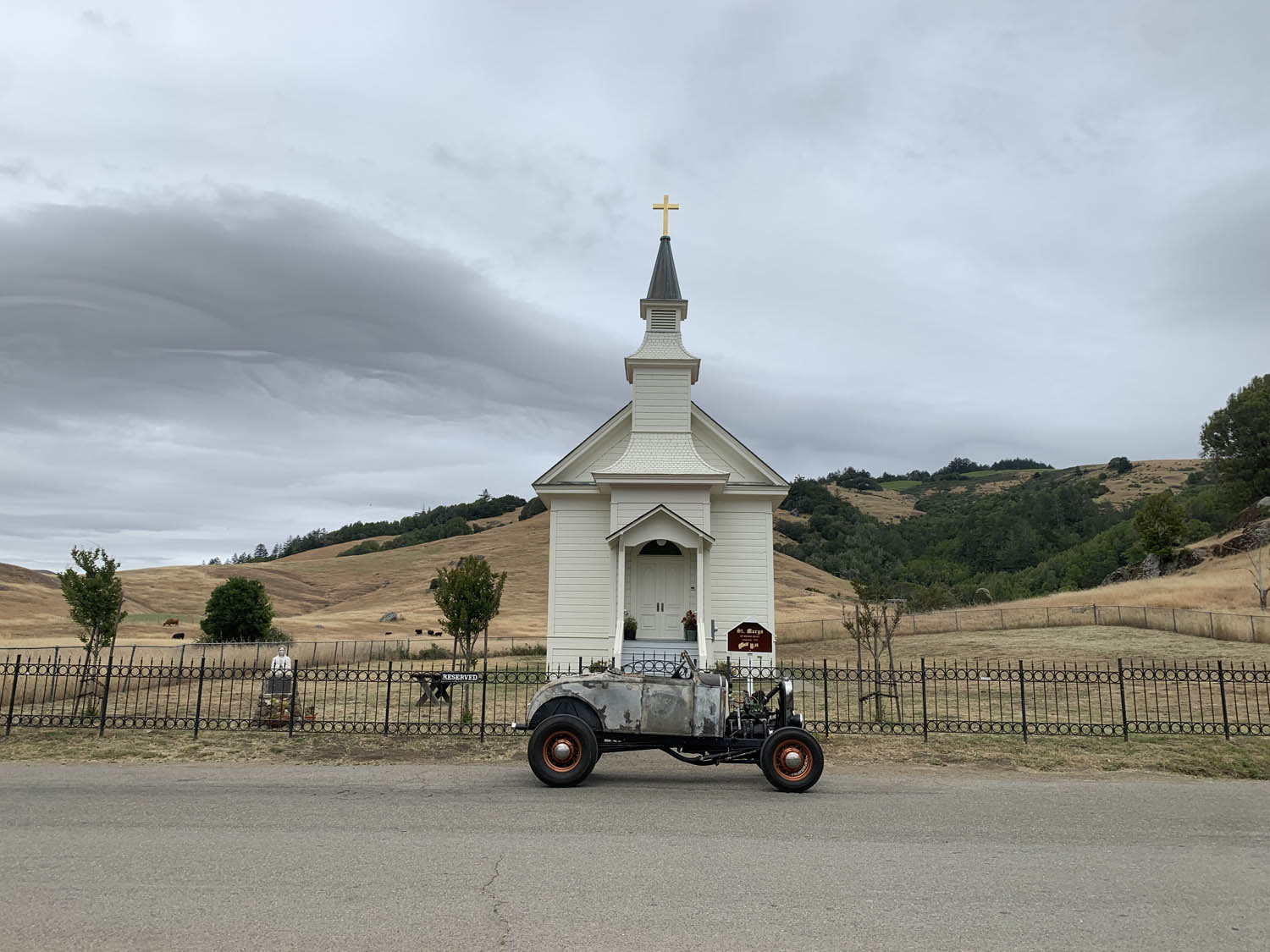

I planned to take a less direct route, hitting the scenic highways and winding byways of Northern California. At that point, 90 percent of my car’s use had been within the city limits. With a warmed-over ’banger, stock trans and 3.78 gears, it did just fine in town. But I knew it had more in it. Using what I had learned in the motorcycle world, I decided it needed a full-length exhaust system.

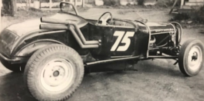

There were a few problems, though. I didn’t have access to a tubing bender or welding equipment—and the show was only a couple weeks away. So, I hit my library to see how the early hot rodders solved the problem. The solution was so archaic—and so painfully simple—that I just had to do it. The answer? Flex pipe, with a twist.
