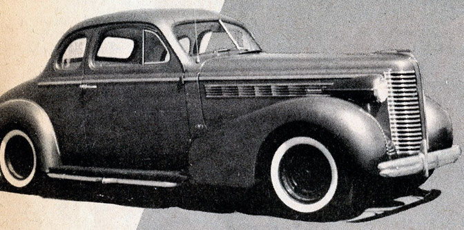

I have a feeling that for Steve Pettygrove of York, Nebraska, it was a combination of all of the above. You see, his hot rod was no Deuce. It was no A. Instead, it was a 1938 Buick. He didn’t set out to do anything too radical, and that’s what made it just right. Some shaving and some lowering helped extenuate the lines and curves of the big ol’ Buick, while double-double lakes pipes added an extra degree of visual variety to the flanks.
Since he already had a Buick, Steve opted for a Buick powerplant to stuff beneath that loooong hood. The ’54 nailhead was bored 0.030-over, outfitted with a Wilson cam, dual-point distributor and crowned with a quartet of Holley 94s on a homemade log manifold. Power was transmitted through a ’37 Buick trans to a stock rear end equipped with 4.44 gears.
In the detailing department, Mr. Pettygrove decided to have the car painted in Bimmie Blue/Green metallic lacquer. The inside was trimmed to match in turquoise and white Naugahyde.
When it was all said and done Steve had the ’38 looking great. He drove the car on the street, raced at the local drags—turning 84mph—and even netted a three-page feature in the November/December 1960 issue of Custom Craft. Steve’s Buick is part rod, part custom and certainly completely different.
