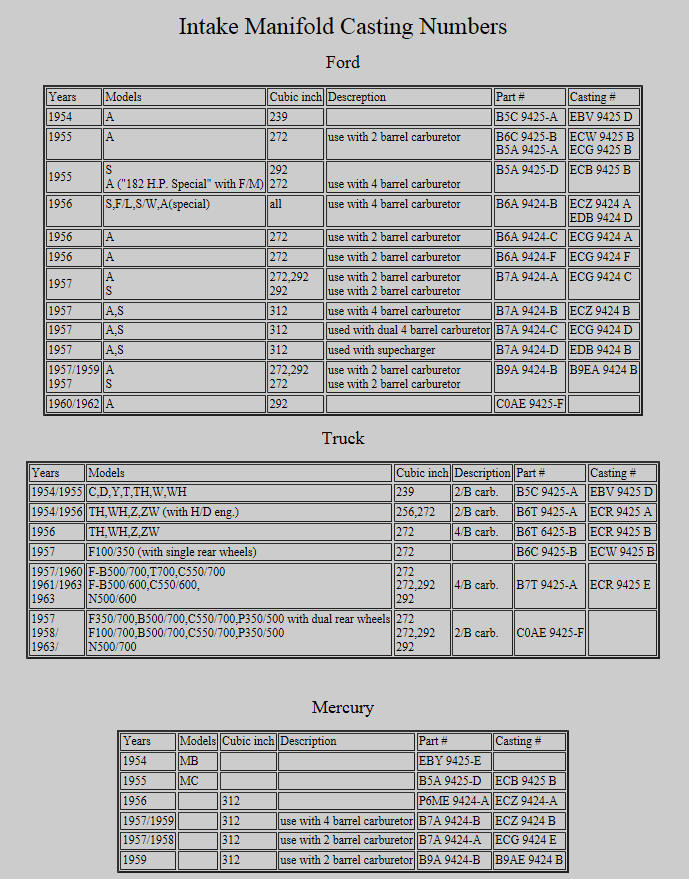

    I was at a swap meet last fall [2014] and found a 9425-B but it had the smaller [tea-pot] carb bolt pattern, so I thought.
    Did I miss the boat and walk away from a deal or is there more than one style of "B" intake and one is more valuable than another???

    You need the whole casting number to tell what you have got so the short answer to your question is yes, there are several different 9425-B intake manifolds. Regarding manifold numbers, here is a chart from the Y-Block-Info website listing intake manifold numbers for the small Y-Block engine family (239-312):
    (remember anything 4 barrel 56 and earlier is a "Teapot" base, and 57 up is "Holley" base)
