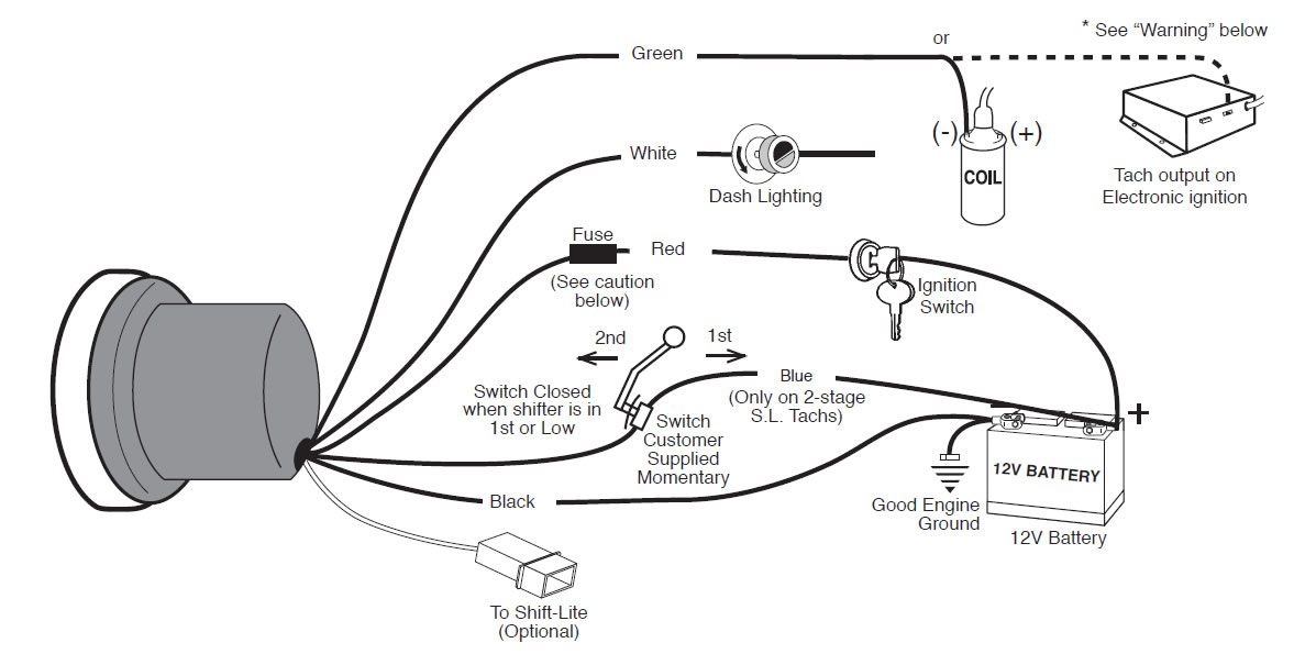

    HERE IS A UNIVERSAL ONE
    THE KNIGHT UNIT WAS A KIT, YOU WILL HAVE TO TRUST THE PERSON THAT PUT IT TOGETHER. CANNOT FIND A SCHEMATIC FOR ONE, ONLY THE AD YOU POSTED.

    I know this is an old thread but it comes up when one googles the Kinghtkit Electronic Tachometer, so might be the best place to post the connection instructions:
    Note: I believe there is a typo in the white wire, it should say attach to the positive terminal.
  7. Doublepumper
    Joined: Jun 26, 2016
    Posts: 1,556
    Doublepumper
    from WA-OR, USA
    ^ Instructions describe a positive ground hookup. Diagram shows a negative ground hookup.
