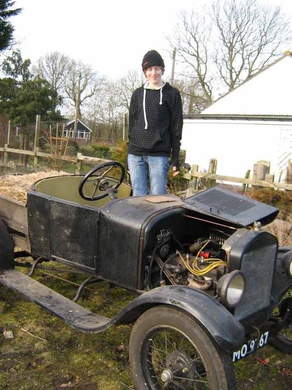

    Recently I started collecting parts again and I bought a flathead, model A front axle and wishbones, 48 rear axle and torque tube. I had wheels and a gearbox (trans) lined up along with some other stuff. Then the oportunity came up to buy a complete Donor car.
    Here is what I bought...
    http://www.jalopyjournal.com/forum/media/lowrusty1-1.297564/full
    I am intending to use as much of this car as possible. This will cut down on the work and the searching for parts.
    Despite appearances most of the parts have been rebuilt and are in good order. the flathead has had a lot of work done to it it's an 8ba block with a 3,3/4 crank bored to 3,3/8 fully Ported and polished large valves isky Springs high volume oil pump one off Flywheel revs to 6500. Toploader three Speed 'box which has been rebuilt .
    The car has done the quarter in the 13s.

    Yes I like the donor car and in a way its a shame but its not what I want and the look of it scares me as far as attracting the wrong type of attention from the cops.
    Davey the guy who built and owned it drove it for a few years and never got pulled!.
    It has deteriorated since that photo was taken. nothing will be wasted and anything I don't use will be passed on. Here is a link to the car being driven...
