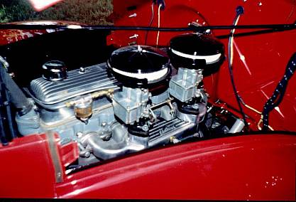

    You gotta love the first photo of the mechanic mounting a portable boring machine on an engine with the crankshaft still in place.
    A coupla carbs,848 head ,blocked decked about .030,3/4 cam,Fenton headers,180 hp,what else is there to know? :D

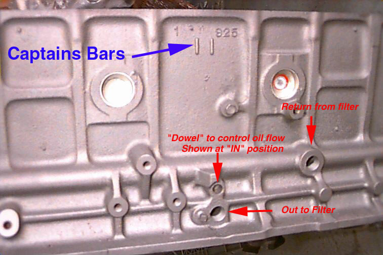

    Watch for the "Captain's Bars!" The 261 has two pairs of parallel raised 3/4 inch long bars cast in the block. This is not seen on a 235 except 1954. One pair is above the starter and the second pair is at the top middle of the left side of the block very close to the head. See photos below. The one exception is the early 261 produced in 1954 to mid 1955. It has only one "Captain Bar" above the starter but keeps the pair on the left side.
    Most used 261 blocks are rebuildable, however often their cylinder heads will have a few very small cracks in the combustion chamber. This is typical due to occasional abuse of over heating in past years. If you choose not to add to your expense by having the cracks repaired, an alternative exists. The more common 235 head is the same except for the three pair of internal steam holes. These can be manually drilled to make the water flow just like in the 261! Sorry, but some 235 heads can be cracked even more than the 261 because they lack heat releasing steam holes.
    "Warning" When Installing a 261!
    The stock remote filter system has two very visible 3/4" lines threaded into the block. One is from the pump to the filter and the other from the filter back to the block. Oil must leave and return to the engine by these lines (even if the filter is eliminated) or the engine will fail from lack of lubricant. Many 261 engines have been quickly seized after persons plugged the two oil line holes. They had many years experience on Chevrolet engines without the full flow oil system. Some thought it was an easy fix to just remove the 3/4" lines if one was leaking and cap the holes. This procedure was acceptable on the older 216 and 235 but never on the 1958-1962 261 truck engine.
