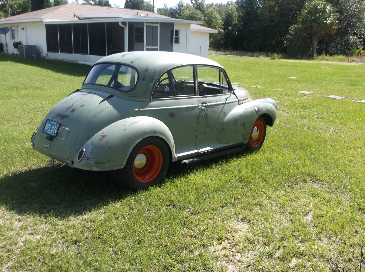

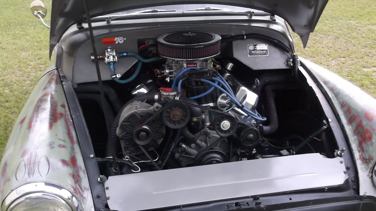

    Built this from 4 chalk marks on the floor with a Hobart 140 110 volt machine. Put over 10,000 miles on it . Nothing fell off, no cracks in the frame or the headers or anything I welded on the car. DSCF0956.JPG DSCF0936.JPG
    El Caballo, clunker and LostBoy like this.

  8. LostBoy
    Joined: Mar 16, 2016
    Posts: 217
    LostBoy
    That thing looks like a wheelie machine. Very cool.
