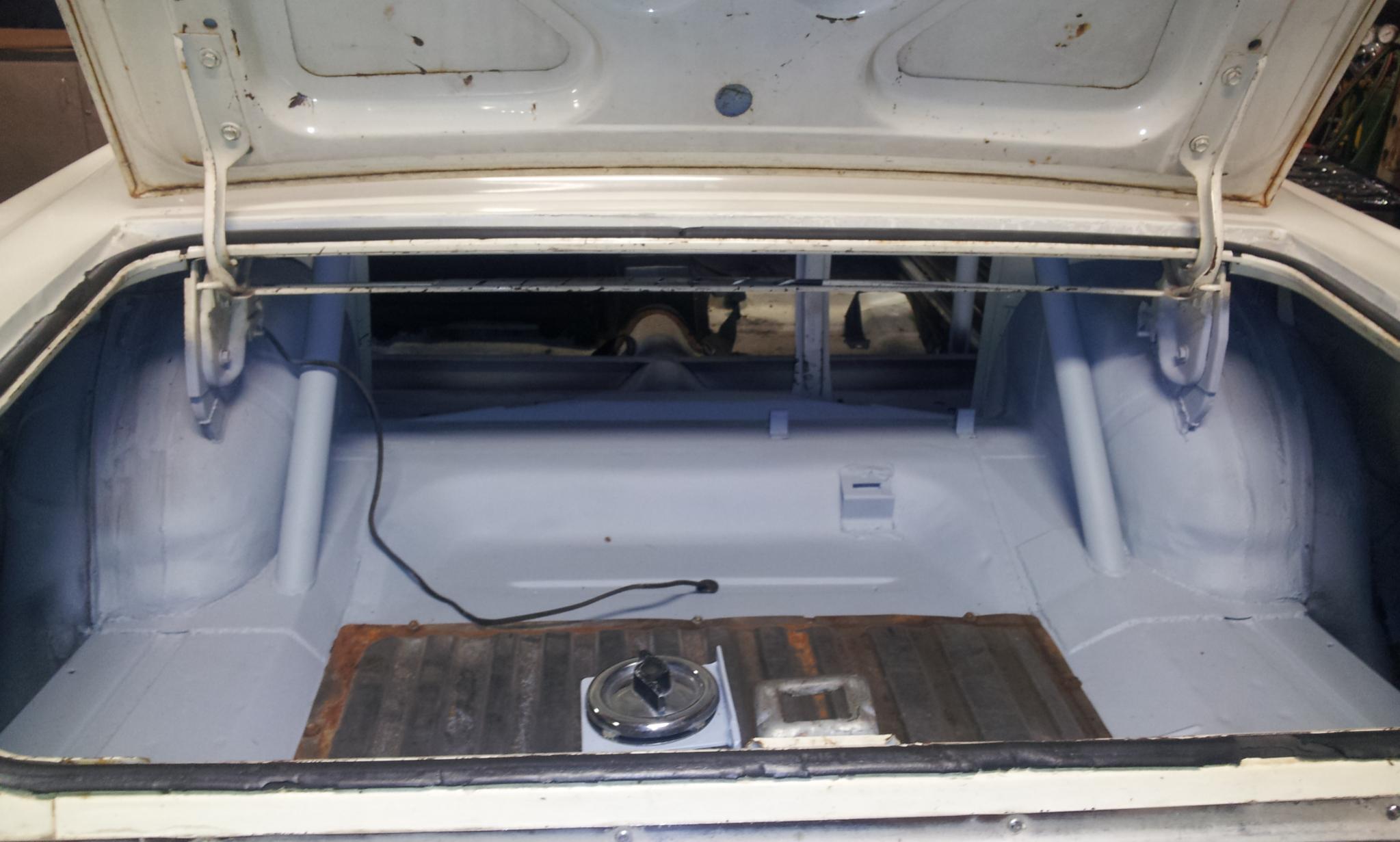

    I really need to start posting up some pictures of my current A/FX altered wheelbase Falcon I'm building, now that it is actually starting to look like a car. Here is a shot from what I was working out today. I've yet to see this done, but thought it would really follow the vibe of the "match bash street afx" theme. Look under the bumper, it appears to be a bone stock fuel tank, when it actually is the bottom portion of the the tank (well, actually two tanks put together to fill in the almost 11 inch wheelbase mod!) turned into a trunk floor !!! This way, there is more than ample room to tuck in the Aeromotive 20- gallon in tank pump and fuel cell!

    Mondo mini-tub. A Firestone 10.50-15x30 tire will now rest inside these, unstretched!!!! Actually, I think I can fit a 12.50 tire in here, and will make the attempt!!

    Looks good! looks same width and location I widened mine, but I'm using 29.5x10.5. I know a W tire will fit with current rims, chassis guy figures with different off-set a 31x10.5 will fit although we took some off front of qtr. at bottom and rolled the lip, tubs went unstretched also. Did I read Roy correct a FE will be fitted too?.....Al

    I'm thinking you guys did something like this?:
    I grabbed onto the two inches or so that was tucked in behind the lip, and this is what gives full use of the tub. Its always tricky to blend the lines in with the fender lip, almost to make it look like it never happened. This one turned out pretty smooth.

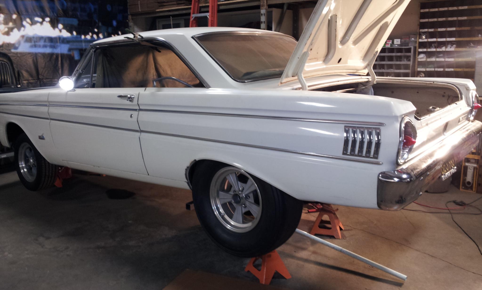

  24. nuts4fords
    Joined: Apr 16, 2011
    Posts: 26
    nuts4fords
    Here is another 64 Falcon that Mr. Snokes worked on. Minitub, subframes and 4 pt. cage. It will be a BFX theme build with a 331 stroker, 4 spd top loader and 9" (3.89). Painted wimbledon white with black interior.
    Dale is a very gifted fabricator! Thanks Dale for the awesome work.

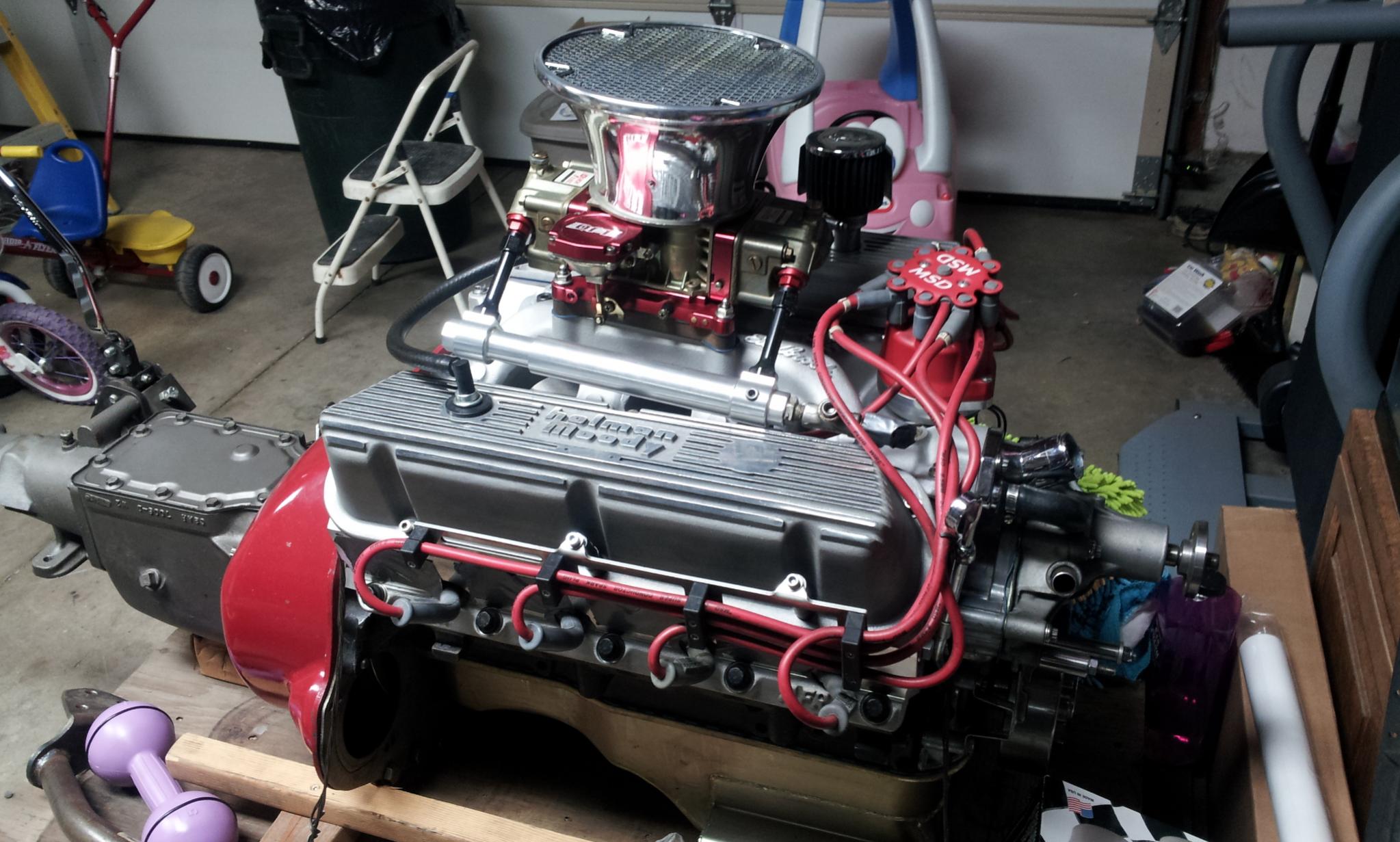

  27. Nuts4fords your car looks great, but I am kinda partial to a bfx falcon. If you plan on making it a racecar you may want a higher rear gear, I have 4.30s and could use 4.56s probably. Also, on the shifter, I had a hurst comp plus, but the throw is really long. I went to a supershifter 3, which has a much better throw and reverse lockout. The bellhousing I will be getting next is a QuickTime, the McLeod or lack wood style you (and I have) is a pain to fit in the engine compartment and I had to "modify" it to fit headers. Let me know if I can help on anything, hopefully can can avoid some of the hiccups I had. Mike
  28. nuts4fords
    Posts: 26
    nuts4fords
    Fiveoh108,
    That would be great! I would like to get advice from you from what you have experienced.
    I went with a 3.80 gear because I intend to use the Falcon on the streets a lot more than the strip. But, I may go with a 4.11 later depending how it works out.
    I am considering using Dougs tri-y headers because they seem to be the best fitting. They fit perfect on a 64 Comet Cyclone I once had. However, I would really like to have some long tubes headers for better exhaust flow over the tri-y design. Do you happen to know one that fits well in the Falcons? I may go hydraulic to avoid all the mechanical linkage stuff and will be using the 65 falcon manual steering.
    Thanks for the Quick Time bellhousing advice. I was not aware of this difference. I will definetly consider this. I purchased the engine and transmission as a complete setup. It was on a AC Cobra. It was too wild for the owner who swapped it out for a FI 5.0 and 5 speed. It has a McLeod bellhousing and hydraulic clutch. Cool that it has the front shift location which is perfect for the Falcon :)
    As for motor mounts, I am hesitant to use the factory stuff. I dont think it will hold up. I have seen a set from Total Control that looks much more beefier. What are your thoughts on motor mounts?
    Super thanks man!
