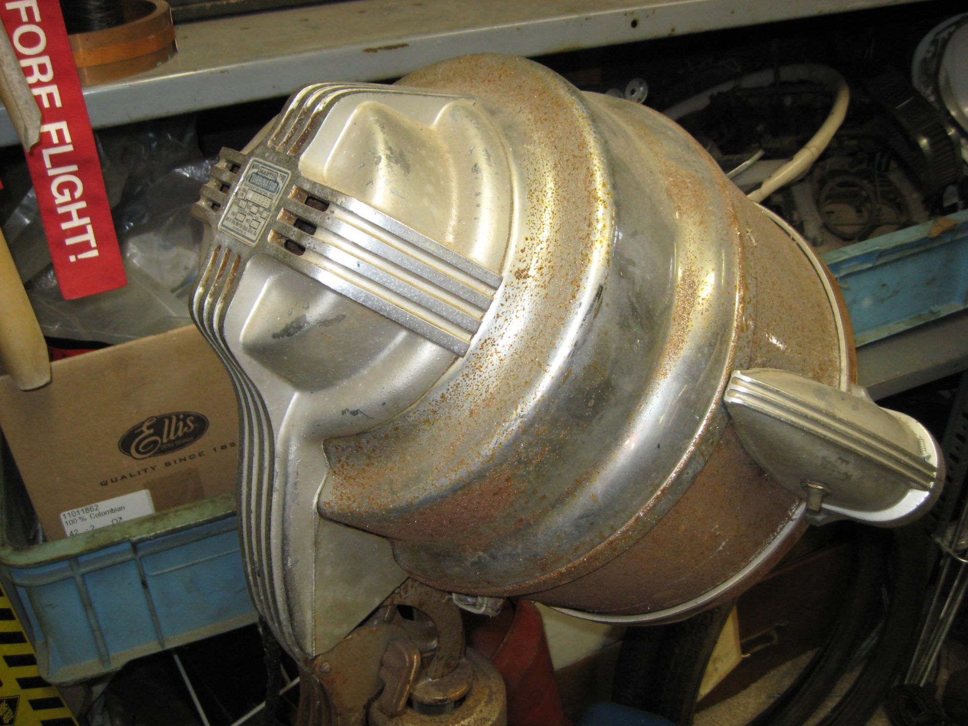

    I’m cutting down this old beauty shop hair dryer that I found on the curb to use as an air filter housing. It says TURBINATOR on the tag! That oughta make people scratch their heads...

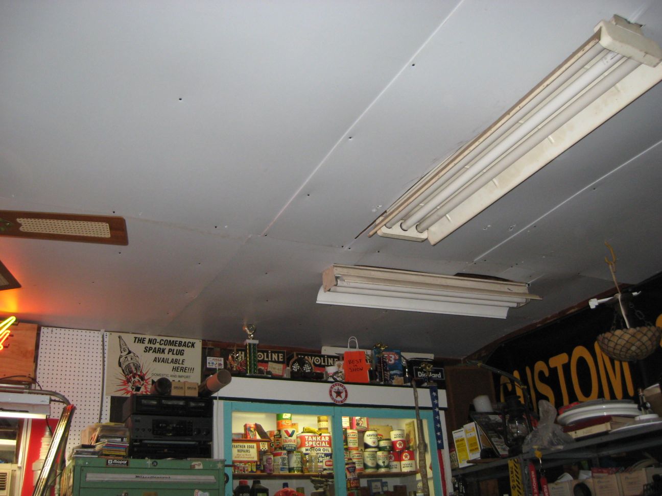

    For the garage:
    I used election signs & drywall screws for ceiling covering in the garage: Those 4’ x 9’ sheets of Coroplast are light enough that you can hold the whole sheet up with one hand to align it, the drywall screw stays put when you screw it in by hand to start it, and then a quick blast with the cordless screwdriver holds it there forever. It insulates, makes it brighter in there, keeps the dust from the parts in the attic from falling down onto the cars, AND it’s FREE. But DON’T take them until after the polls close on election night! It’s actually against the law to “tamper with the election process” and they DO take that stuff pretty seriously! Be quick though because the RC airplane guys also like this stuff to build planes out of and they’ll snag as much as they can carry too. It’s also GREAT stuff for making templates & patterns out of because it is dimensionally the same as cardboard but a LOT more durable.

    Love the hair dryer.
    I hope you incorporate the "Remove Before Flight" pin as well.
