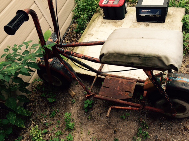

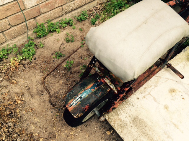

    Can anyone ID this mini bike frame I just got. A dear friend passed away last week aged 92 and we have been clearing out the junk. This was on his junk pile. It looks like it was originally metallic blue with white pin striping. Thanks.

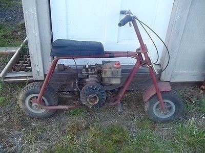

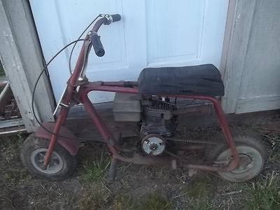

  12. image.jpg image.jpg image.jpg Anyone know what brand this one is? Bought it off EBay yesterday and drove 3 hours both ways this morning to pick it up in N.C.. Can't find any I.D on it yet. Got a lot of good stuff on it as far as aluminum hubs and big brakes. What brand of motor is it?

  14. image.jpg Just found out mine is a Bird Engineering brand. Lots of cool sites about minis.
    It's a Bird 'Sprite'.

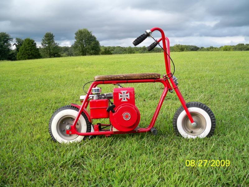

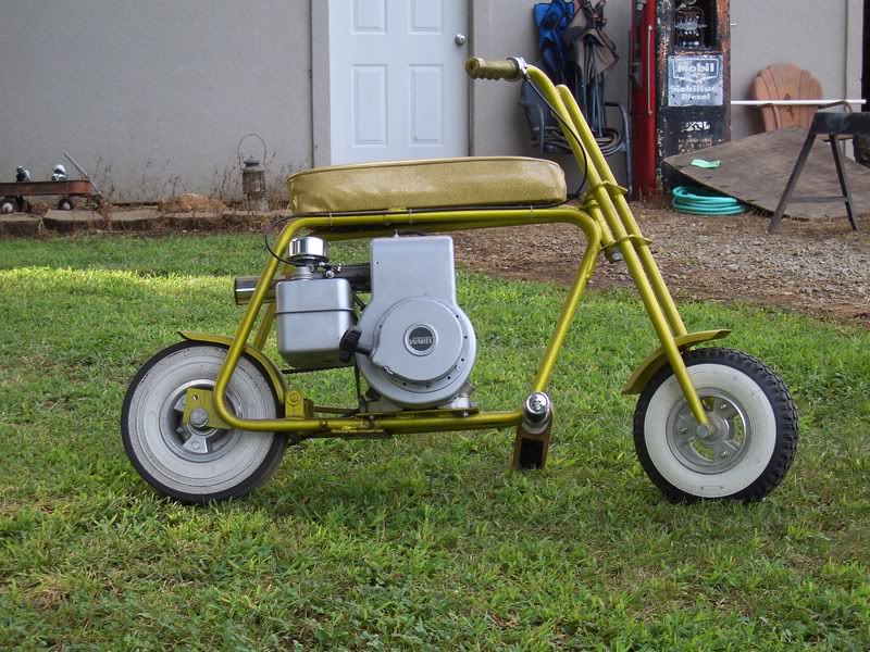

  15. Yours is a bird Engineering Mini Bike. I have two. Notice the location of the rear axle on the red one. I moved it up to lower the Mini Bike, I also Shortened the front forks. The gold one is getting redone, and it has the same modifications now. Here's some sites to look at.
    http://jleibovitch.tripod.com/id205.htm
    http://www.gokartsusa.com/classic.html
    http://www.oldminibikes.com/forum/content.html
  16. I like the lowering idea. Did these come with Tecumseh engines? I guess that's what this one is, but all the covers are gone along with the carb. Does have the original seat and muffler, also been converted from the scrub brake to a hub brake. Also missing the cool kickstand. Is there a source for those?
    That red one of yours almost matches my truck.
  17. How's that lowered rig work/ride/turn?
    Appears that the pegs are into the dirt with just a slight turn/lean.

    It's a Tecumseh.
    Send a picture of the intake/exhaust/carb area for better I.D.

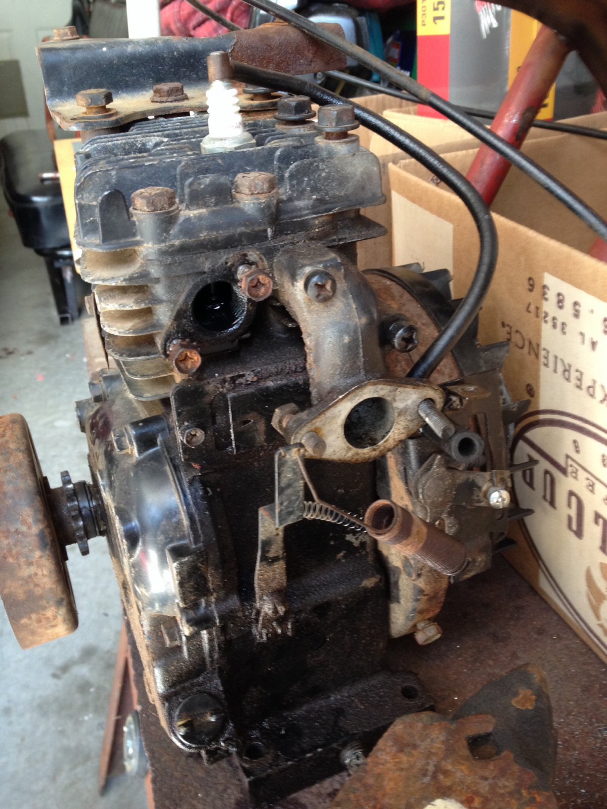

    Your engine appears to be an H30 of H35. (3 or 3.5HP).
    The only way to distinguish between those without the numbers is to measure
    the cylinder bore. Since your cylinder head bolts are loose you likely won't be
    running that engine again without a new gasket. So when you have the head off
    you can measure the bore with a ruler. Going from memory, the bore of the
    3.5 HP engine is 2-1/2".
    The reason I asked to see that side of the engine is because the HS40 (4 HP)
    engines which were common on minibikes of that vintage have the intake
    and exhaust ports swapped around with the intake on the PTO side.
