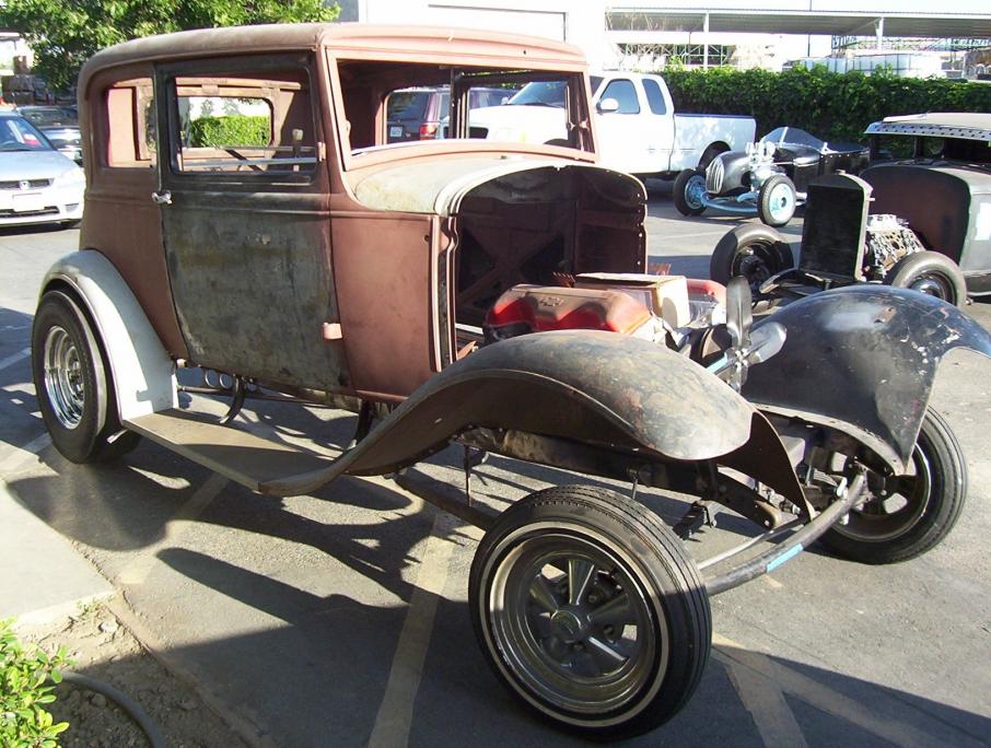

    Like the I-beam axle, the tube axle was never designed to twist in Henry's original application, the front suspension was mounted to the chassis at only two locations, the spring mount and the "ball joint" (the big ball at the end of a unsplit wishbone),....... This would effectively give almost full travel and motion to the suspension with very few bind points ( with the exception to the spring and shackles).
    Like I said in my first point "In Theory" the tube axle and split wishbone mounted outboard on the frame shouldn't work without fatigue and or failure. I have had a friend that snapped a spring perch while turning into a steep driveway with this set up,........ But for that one incident there are hundreds of other examples that have never had a problem. I was a close friend of Frank Mack that had set up on his roadster,.. and it was never a issue, And Frank drove the daylights out of that car.
    Here's a dumb little experiment for you, take a pen or a pencil and hold it between your index and middle finger in both hands, and hold the sides of your hands flat on your desk or table,... now rotate your right wrist up and keep your left hand/wrist flat on the table,....... the pencil wants to twist between your fingers,.. When you do the same thing with your arms on the table and bend your right arm up at the elbow,.... the twist on the pencil is still there but greatly reduced,...... this is how the "Theory" works.
    So like I said, "In Theory" it should not work,.... however it usually does, probably because of the minimal arch of travel verses the slip fit of the parts and elasticity of the components,....... this is just my humble opinion, now I'll let all you experts fight it out,........:D
    Here's Frank's car,....
