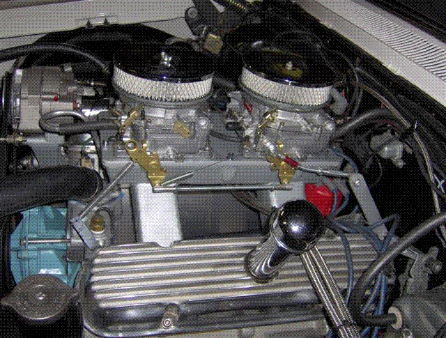

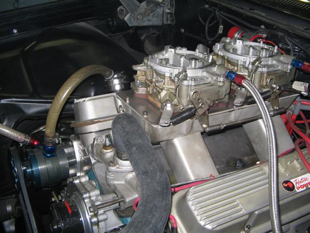

  7. 60man
    Joined: Jan 1, 2007
    Posts: 148
    60man
    I always thought T-rams robbed low end performance too. Boy...was I wrong. Granted my set up is on a race car/508CI Pontiac..;) I have to run Carter AFB's per class rules. They have a secondary air valve. I tried removing air valves and it did stumble off idle. It very responsive off idle and my motor only has 5.5"hg of vacuum at idle. The T-ram was worth 53HP on dyno over Offie 2X4 with no other changes/same carbs...surprised me !! I made a top plate out of 1/4" aluminum plate to get more hood clearane so I guess I'm guilty of reducing area under carbs..:rolleyes: My carbs are Comp 750's per class rules. A buddy of mine has a street/strip 63 GP and put a T-ram on his. Had to have it.:D He wound up using Edelbrook 600's...He says he can smoke the hides (MT Drag Radials)very easy and lights them up on 2nd gear change.He's chomping at the bit to go to track.His motor is street/strip 462 Pontiac with Hyd roller cam and Aluminum heads..
    With a smaller motor I wouldn't go with overly big carbs..
    Pics are of our cars, GP has air cleaners.

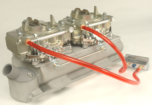

  15. Tech @ BG
    Joined: Nov 18, 2005
    Posts: 319
    Tech @ BG
    There are a few differences in the sideways mounted tunnel ram carburetors vs the one mounted in line.With the sideways mounted tunnel ram carburetors you gain the metering block on the rear which allows you the ability to jet all 4 corners. You also now have the larger center hung float bowls and with our tunnel ram calibrated stuff we use a special cut float in them that allows the fuel to still slosh back but not cut the needle and seat off when this occurs.
  16. Tech @ BG
    Posts: 319
    Tech @ BG
    I noticed several of you were discussing the hot vs cold and awhile back we had posted some pics of our new Pro Twins which uses our new AeroRam intake which is a warm design vs the cold design of some of the taller tunnel rams. With this set up we are using the 2 carburetors in line and one of them has a choke for easier start ups when cold. These are both vacuum secondary carburetors which are fine for street use. I'll look and see if I have any individual pics of it but it is in the center back row of this one.
    magster65 likes this.
