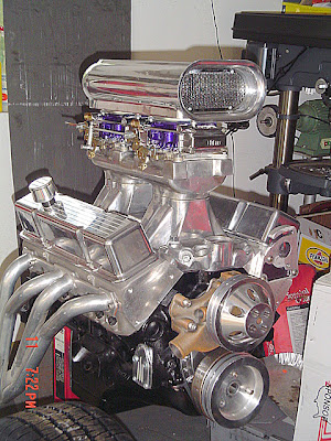

    I run a single 600 cfm with electric choke on my 55 chevy,(355,480 lift 292duration 7 degree lobe center cam, 9.5/1 comp. 882 heads with 202/194 valves and a home port job.hooker supercomps 1 7/8" primary into a 3" collecter, 3" pipes all the way back to a set of flowmasters. 350 turbo trans. 3000 stall/soon to be 4 speed, 9" ford with 4:11 gears) seems to work good. I had two 450 cfm on a basicly stock 350 back in high school. It was ok, but the throttle respose was a littly soggy of idle.
    The 55
    excuse the pic. it was from when she was first going together.
