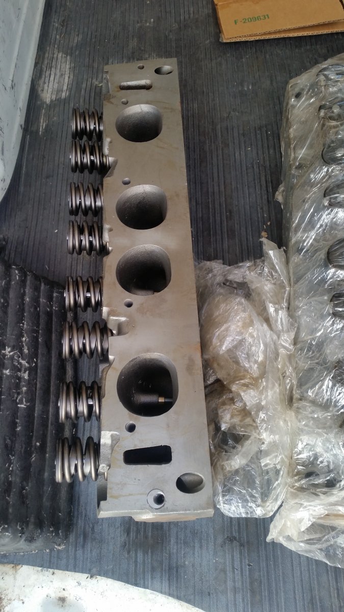

    I just picked up a '67 sideoiler block with two crank shafts (stock and an Eagle stroker), a pair of reworked Tunnel Port heads and the dual 4V dual plane intake. Seems like a fitting setup to replace the 390 in the '55 Crown Victoria. Or is it...
    Would love to hear from anyone who has run a Tunnel Port in a street car, especially if it was/is stroked.
    I fear those ports will be lousy for torque, but the cool factor makes it tough to resist. What was your experience with a street car running a Tunnel Port?
    tmp_29813-20150728_163840-1162148410.jpg tmp_29813-20150728_1639241495420405.jpg tmp_29813-20150728_164026-610224305.jpg tmp_29813-20150728_165756-1885664809.jpg tmp_29813-20150728_163938-682533262.jpg

    4 speed with enough rear gear, it'll work great. Don't worry about it. Build it, have fun!

    Be sure to replace the sodium filled exhaust valves with heavier solid stemmed valves. Sodium filled exhaust valves will erode from the inside if they are not heated daily. There are horror stories of 427 Ford engines destroyed by sodium filled exhaust valves that broke when engine was started after a long period of sitting.

    I'd replace the valves too, all of them. I had a customer that wouldn't listen to us and he paid for it, dropped a valve and broke his shit, bad.

    How can I tell if these are sodium filled? There's a chance I can track down the builder...if so I'd guess it's the only tunnel port set he's done recently.

    You are not going to find much in the way of meaningful feedback here, you could try Jay Browns FE Power forum, and when you go there, post a pic of the face of the exhaust valves. I'm a member there, I find the format more user friendly than the other FE forum. Speedtalk may be worth a shot as well, but doesn't have as high a concentration of FE builders.
    FWIW, if that stuff was built recently, it will almost certainly not have the sodium filled exhausts.

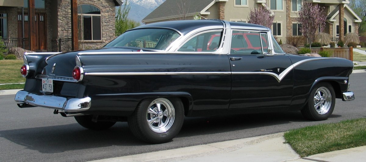

    Thanks guys, all of this is helpful. There's a lot of ways to go wrong and a narrow path to get it right. The more I think about it I'm leaning towards a true period build, using a Toploader, etc. Essentially the car any of you might have built or raced against in 1969. I seriously considered going straight axle on this prior because I couldn't imagine fitting headers any other way, but now that I know shorty units exist it will maintain this stance.

    that car is stunning, PLEASE don't put a straight axle in it!! Toploader and tunnel wedge would be killer. I just have a ho-hum 428, so no first hand experience with sodium valves.

    That's a very nice Crown; don't street freak it!

    That Crown Vic is a beauty.
