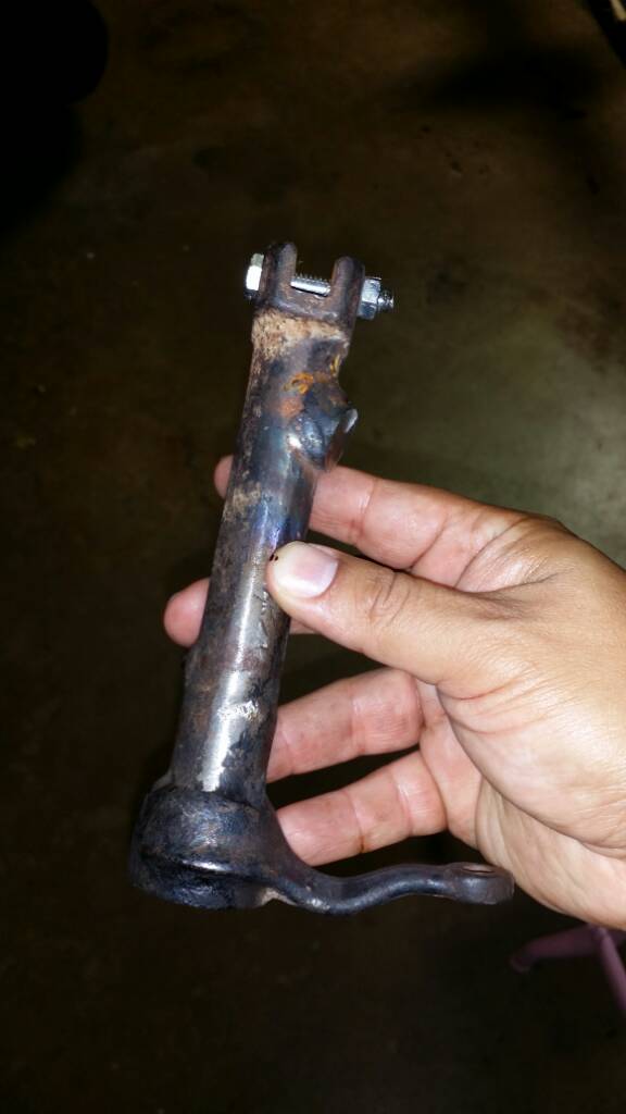

    Actually i just got it out last night and made my own tool as well. I was going to scrap the torque tube until i saw your post. Thanks man

    ^^^Yup, that's exactly what the remains of my seal looked like when I got it out. Here's another tip for you. I went to the local plumbing supply house and picked up a long handled gas furnace venturi brush. Looks like a big bottle brush for baby bottles. A nice fat one. I used it with some brakleen to clean out the inside of the torque tube of all the ancient gear oil, grease and crap before putting it all back together. It worked really good and the inside of the torque tube was hospital clean in no time.
