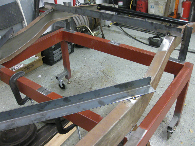

  20. Tommy R
    Joined: May 18, 2004
    Posts: 717
    Tommy R

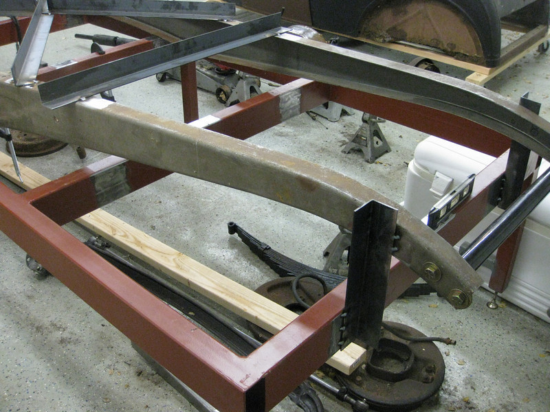

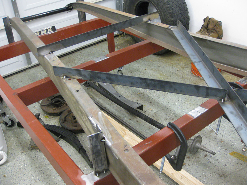

    Well, it may not look like much, but a friend came by today and we made some good progress on the chassis. We got it all squared up, level, true, braced, and tack-welded to the frame table. The next step is to weld in the front cross member and start boxing the frame rails. I'll be installing the rear cross member soon, too.
    I'd like some input. Are these tack welds strong enough and frequent enough to secure everything while I box the rails? I think so, but would like some more opinions. Of course, I'll just tack the plates in position and use lots of small stitch welds to keep warping to a minimum. Here's some shots...
    A few bits of information about the chassis. As is sits now, it's square/level/true within about 1/16" in pretty much any dimension. I'm pretty happy with that! Also, while taking measurements and comparing them to the numbers for a stock Deuce frame, it appears my frame may be pinched for a Model A. The reason I say this is because the front and rear of the chassis are about 1/4" narrower than a stock Deuce, but around the cowl, it's close to 1" narrower. And FYI, I decided to keep the front and rear 1/4" narrower. I don't imagine that will cause any problems and figured it would help narrow the frame since I'm not pinching it further.
    Does that sound reasonable?
    Oh yeah, it was a brisk upper 60's/low 70's today in Austin. :D
