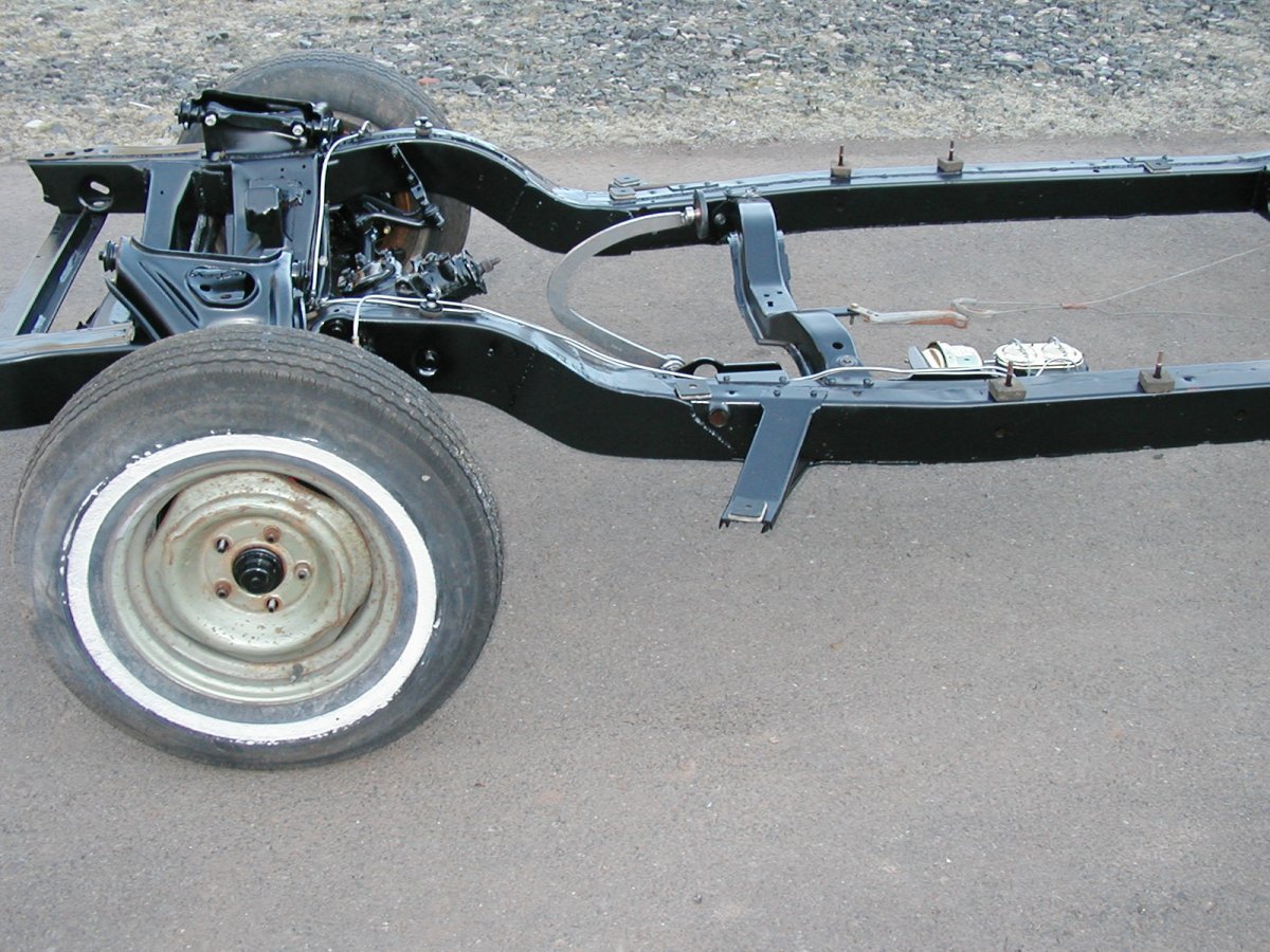

  9. 51 Project 005.jpg I don't have any wood or wood screws in my 51. There are 4 3/8" studs in my frame coming up through the floor and nuts and washers on them holding my rails to the floor. A simple 9/16 socket and a 3/8" ratchet removes them very easily without removing the skirts or anything. Any time I need to work under the dash I take the seat loose and slide it back against the rear seat so I have plenty of room. It shouldn't be a big deal. You can see the factory studs and rubber spacers in this photo.

    He was kidding about the screws..My 51 did not have rubber blocks, the seat mounts were all so body mounts, 49 and 50 were not..
