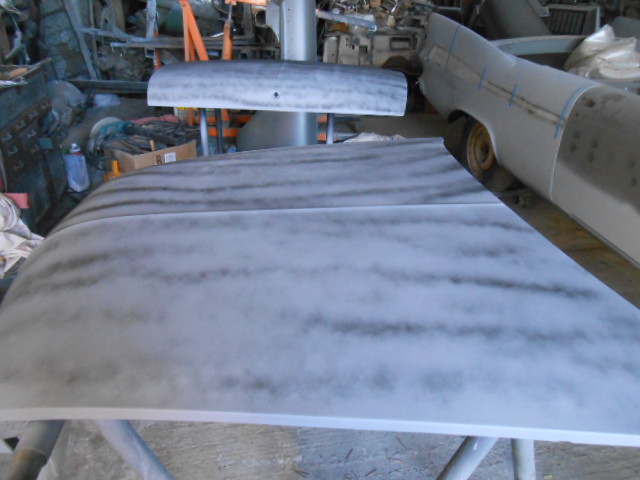

    There were numerous small dents over the top of the lid, from heavy objects being set on top, or a heavy hand when closing the lid. Also, one very large low spot directly in the center, where someone had climbed on top. I used a stud gun on most of these, as many were not accessible from the bottom, and tapped the high spots down while keeping upward pressure on the low areas.
    Next, was to lay a heavy coat of primer on the lid, then block sand. I sprayed a guide coat to find any flaws, luckily just minor, and used 'Red Lead' [spot putty] on them. After sanding the excess off, I then primed and block sanded the lid again, and finding no variances, I wet sanded with 400 grit.

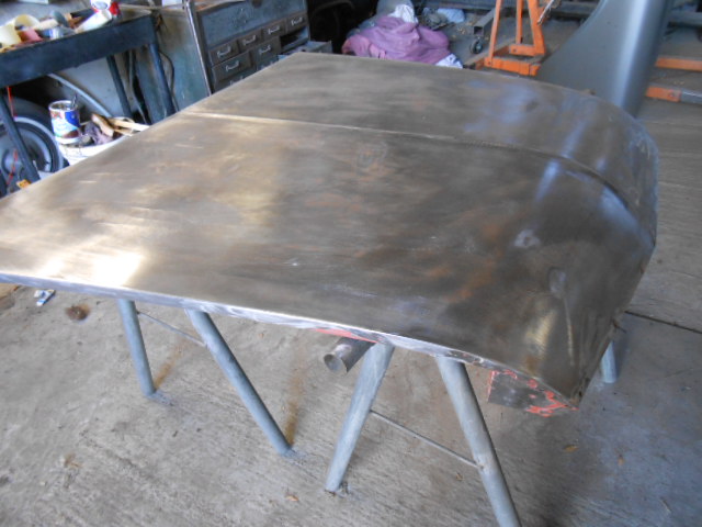

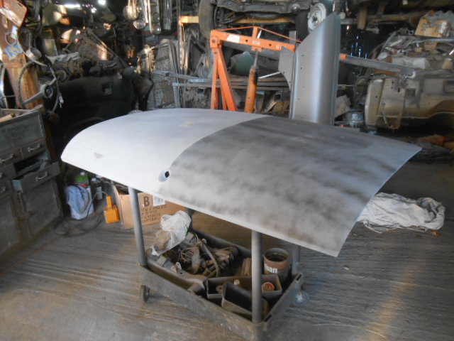

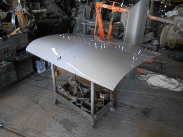

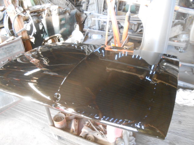

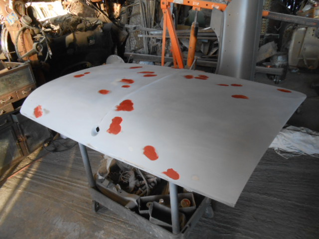

    On to the hood-

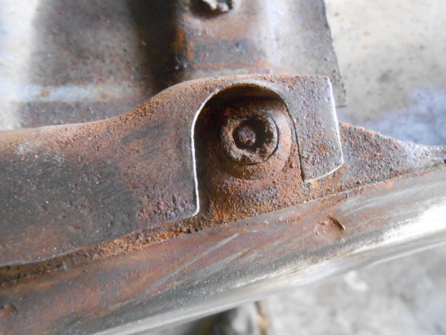

    I found the straightest hood I had, then went to the task or removing the heavy surface rust from the top, lightly sandblasted the underside, then acid-etched it with phosphoric acid. Although appearing straight, there were a few dents and low spots to deal with. Also, nearly all the bolts to fasten to the hood hinges had been snapped off years ago, and the rear brace spot welds had quit doing their job. I re-welded the brace, and then removed the broken, rusty bolt remains by setting a small nut over the broken studs and welding them together. All came out easily then.
    I then did the necessary bodywork and block sanding to get the surface nice and straight.
  10. big M
    Joined: Mar 22, 2010
    Posts: 709
    big M
    Out comes the black paint-
    I will paint everything separately, then assemble when the body is completed.

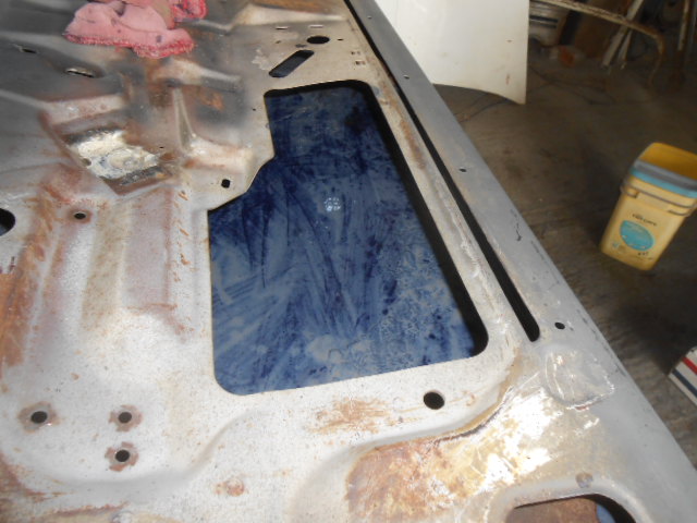

    On to the doors- they were pretty straight to start with, although the one had some rust coming through where the weatherstripping held moisture, and the other had what looked like a bullet hole on the bottom surface. Most likely, it was a previous owner's attempt at adding a water drain hole. These I welded up, and smoothed out. Lots of block sanding followed.

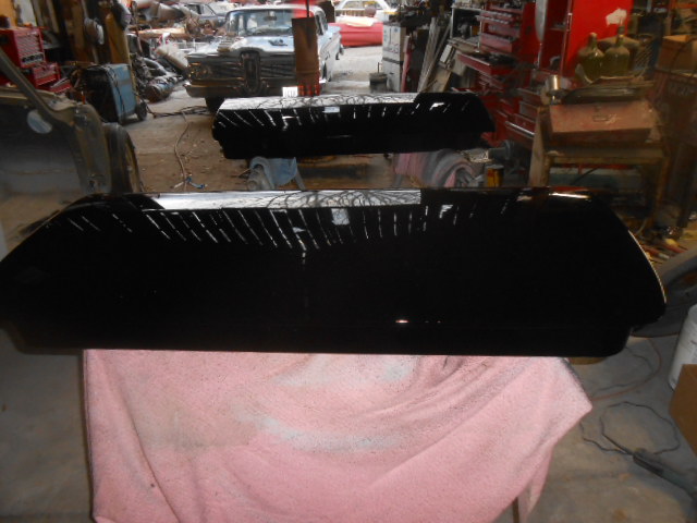

  21. big M
    Posts: 709
    big M

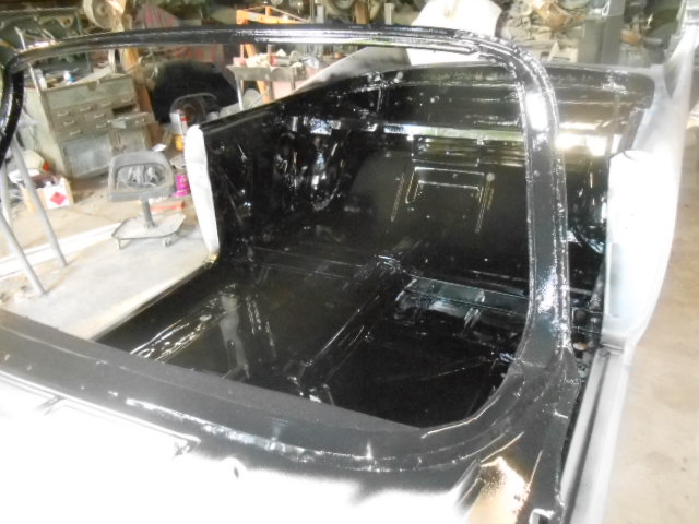

    Painted the inner quarter panels, underside of the dash, trunk and cabin floor.
  22. big M
    Posts: 709
    big M

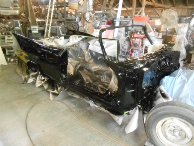

    Weather was 82 degrees with no wind yesterday, so I painted the remainder of the body. Came out pretty good, but I will cut and buff the paint before installing any trim.
