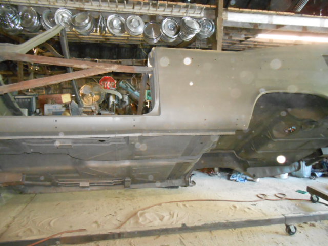

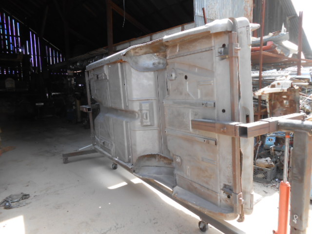

    After all the work I have done, I didn't want to risk screw-ups or damage by hauling the body to a blaster, so I bought a sandblast pot and wheeled the body outside. I blasted inside, outside, and anywhere I could see any rust, but carefully so as not to warp the metal. I did find a few pinhole areas, but none bad enough to make the metal weak. These will be leaded in when I resume with the body. I spent two full days doing this, not a pleasant job, but it's done.
    ---John
  12. big M
    Joined: Mar 22, 2010
    Posts: 709
    big M
    I spent nearly two hours blowing sand from crevices, and then shot a couple good coats of metal etching primer inside and out. The body was then wrapped in plastic to prevent humidity, bat guano, etc from reaching the surfaces. I will be working on the chassis now, and the final body work will be a ways down the road.

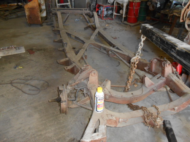

    Now moving on to the chassis. The original convertible frame was rusted through in places, not worth trying to save, although there were some convertible specific pieces that needed to be saved.
    I had another chassis from a coupe that had been blasted and painted gloss black years ago, perfect choice for this. I set the two side by side, noting any differences, and measuring any found.
  22. big M
    Posts: 709
    big M

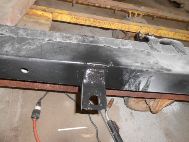

    I used a die grinder to remove the special convertible body mounts on each side, and sandblasted them clean. The donor frame was measured and marked for placement of these mount ears after cleaning the black paint off. Then, they were welded on.
    Convertibles also used their own specific torsion bars, longer to clear the X-frame, so I went ahead and snipped the torsion bar mounts from the frame.

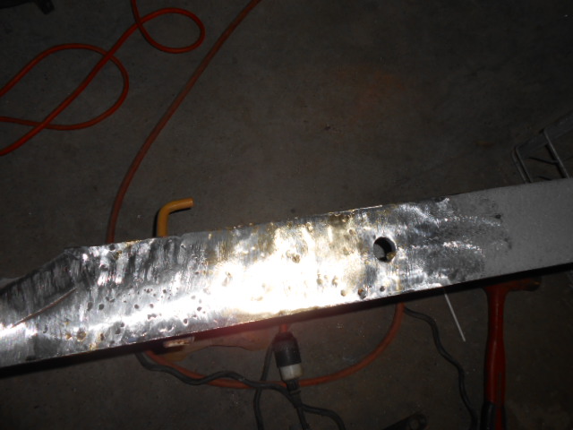

    I used a cutting torch to remove the X from the rusty frame, as well as the torsion bar mounts, as they nestle in the end of the X. I measured the torsion bar mounts I had cut out against the cleaner ones from the coupe frame, and found they were the same, so I welded these in place at the proper spots.
    Then I completely sandblasted the X member to remove the rust from the deep pits. One end of the X on the top side was badly pitted, so I decided to fill these with brass to make it look a bit better. I also removed the remainder of the attaching pieces for the top, these were too far gone to reuse.

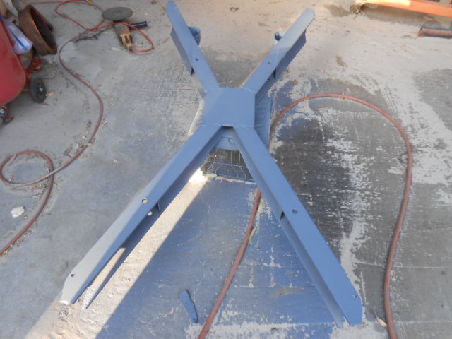

    The X is then primered to prevent flash rusting.

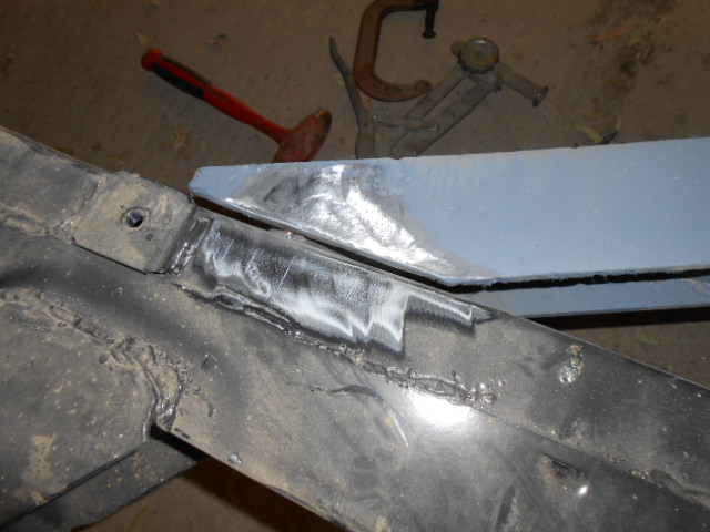

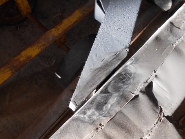

    Mating the convertible X to the frame-These are installed from the bottom of the frame at the factory, as the ends of the bars overlap the frame rails. After setting this in place, I mounted a lower A-arm to each side, and test fit each torsion bar. Looks good, so each weld was completed.
  28. big M
    Posts: 709
    big M

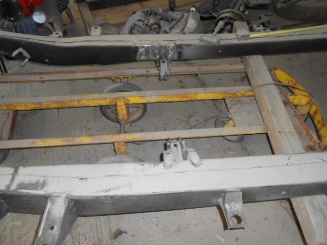

    I had a couple friends help flip the frame over, as now it's getting heavy! It has been in the 90's here for daily high temps, and welding in the heat is not the most fun you can have, but I wanted to press on.

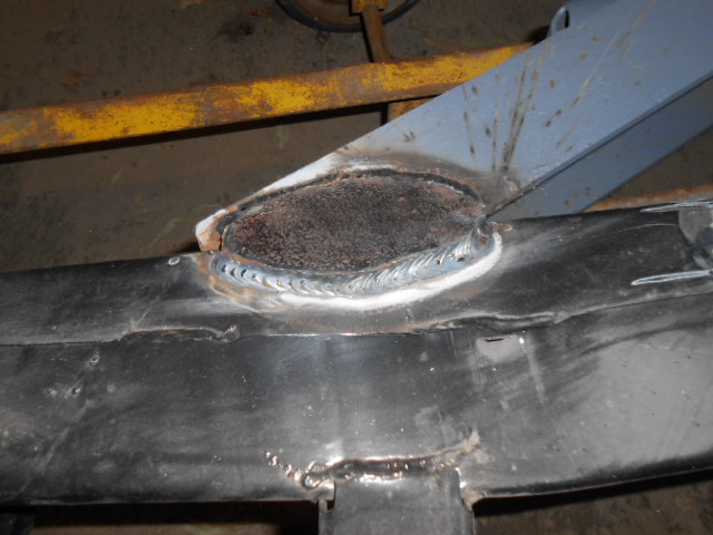

    As I stated earlier, the bottom of the X overlaps the frame, and the top has gaps on each corner for installation at the factory. Apparently, the factory just used nondescript pieces of scrap to join the X to the frame, there was no real common size or shape. I cut four eliptical pieces from a piece of steel the same thickness, and used them to join the frame to the X support. After tacking all four corners in place and making sure the fit was good, the pieces were welded completely. Voila! A convertible frame!
    ---John
