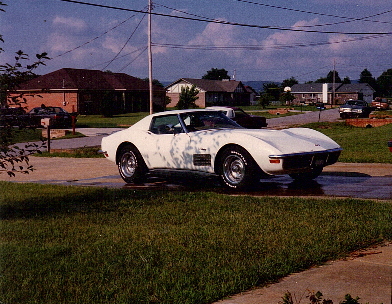

  3. All of these were painted at home in a garage. I used an old DeVillbis gun that my uncle had back in the 50s and 60s for the Vettes. Both Vettes are acrylic lacquer. Used a TIP HVLP spray system to paint the yellow 56. The 56 is single stage urethane. Painted several more in either the garage or the driveway years ago but have no pics of them.

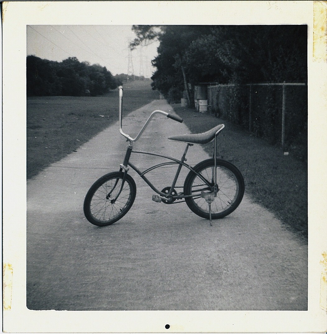

  6. does this count....early side walk to sting-ray build....painted with good old Western Auto rattle can....about 1967-68
