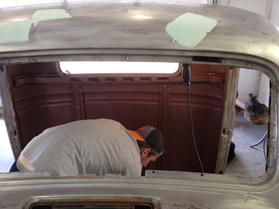

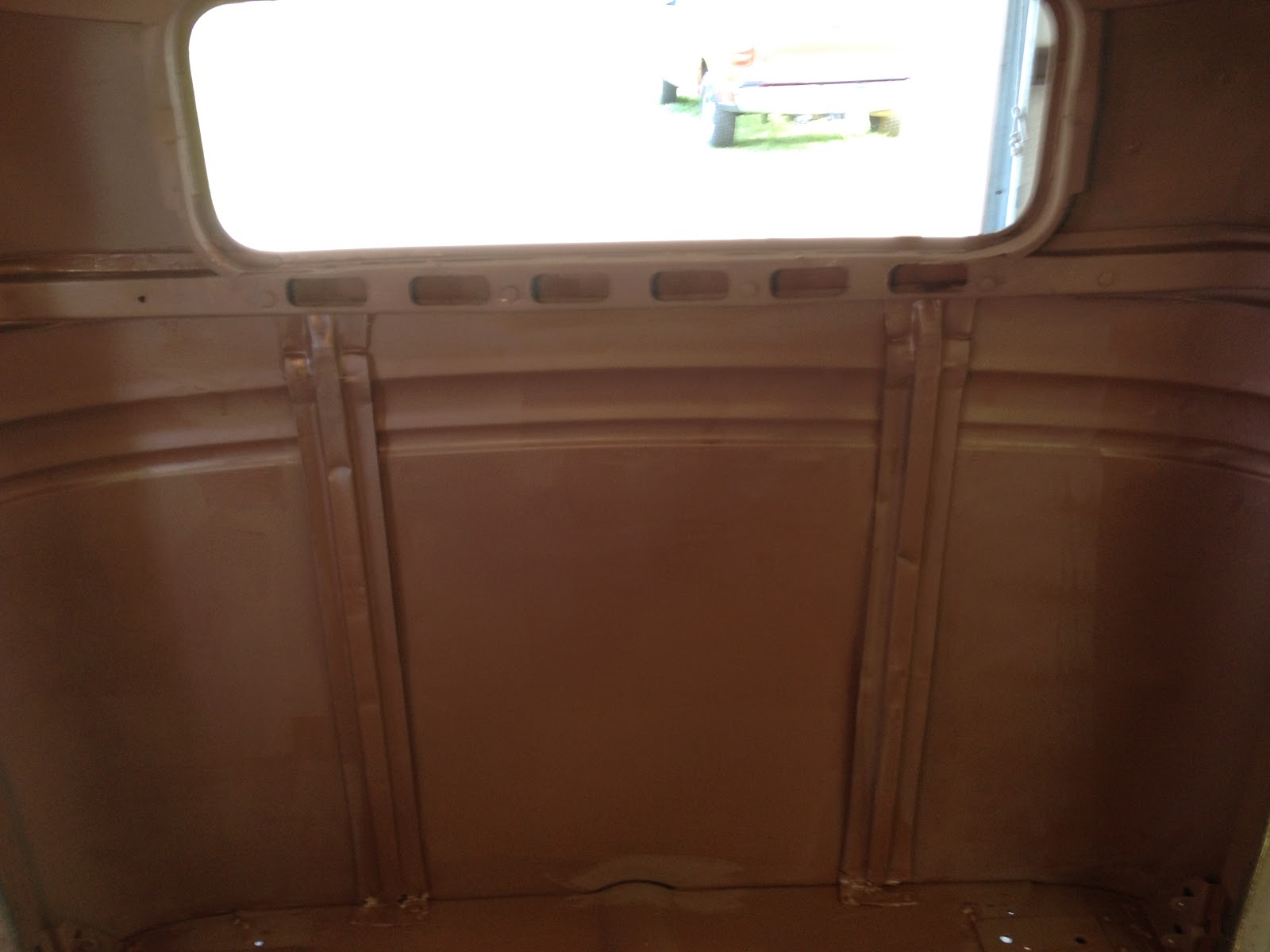

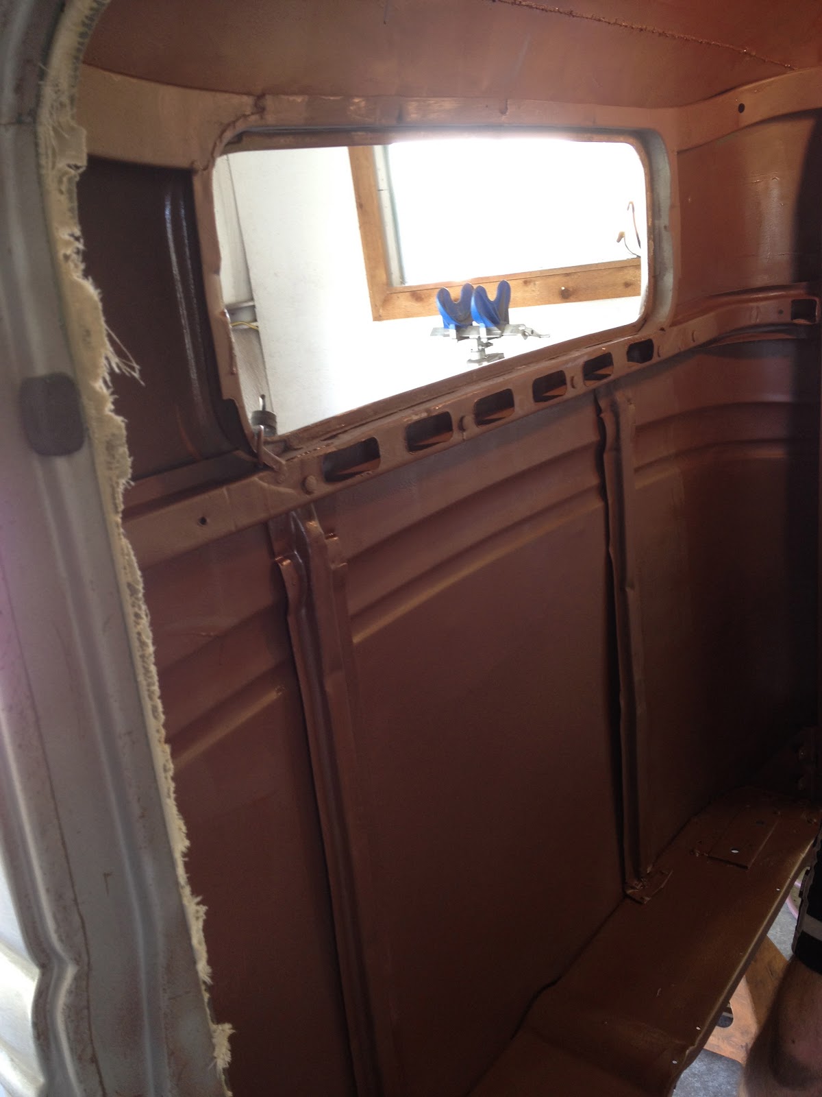

    So we decided to try something new. I have been doing some research on different rust primers etc. and so this truck is going to be a test bed to try several different things. The first is Rustoleum's rust primer. I have found that it shares the same base components as some of the other name brand "Rust Preventers" according to the MSDS sheets.
    The best thing it is $8 qt. at Wally World.
    The finish is a semi gloss and it lays down pretty smooth overall. It's good for interior stuff I suppose. This build is a budget build and I have to keep that in mind. As bad as I wanted to spray a high end primer and color inside, I have to refrain from this becoming a full on restoration. It needs to be drivable and affordable.
    Eventually I will spray the inside of the cab with a bed liner type material for sound deadening purposes.

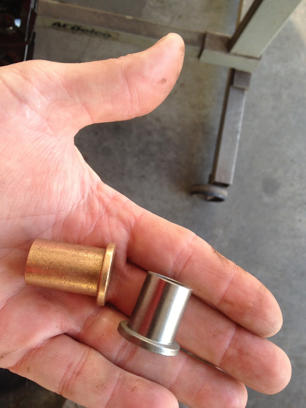

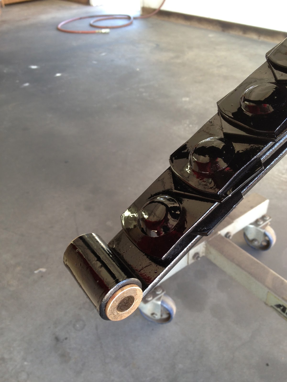

    I always hated those poly bushings that everyone sells for the front ends, so I started researching to see if there was anything better out there. That's when I stumbled across these on Limework's website.
    These were made from "Oilite" stock. They should hold up way better. They were cheap enough. I paid $25 for 8 bushings. That not much more than those el cheapo nylon bushings and they will live 10 times longer. Here is the link if you would like to order a set. http://limeworkspeedshop.com
    I always like to give credit when I buy something that is a good quality product. Everything I have ever gotten from Limeworks has been top shelf.
    Nice and tight. Should be a vast improvement.

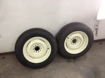

    I try to finish 2 or 3 things every time I go out to the shop. I figured this would be an easy one, so I had the tires mounted up. I wait for Summit to run free shipping for orders and then I order my heavy stuff. I ordered 2 ea 15"x6" and 2 ea 15"x7" Wheel Vintiques. I am planning on running 40 Ford caps.
    I picked up a color chart from my local aircraft paint supplier. They had a color that is called Cadet Tan. It's a single stage, polyurethane. I'm going to use the same color on the top and the other accents.
    15" tires are getting hard to find. I wanted WWW, but I plan on driving this daily and I found these online for about $50 each. I think they are pretty standard on Volkswagen Bugs. It is a 165 85 R15, if memory serves.
    I'll try and get more done in the future, but I am kinda slow.
