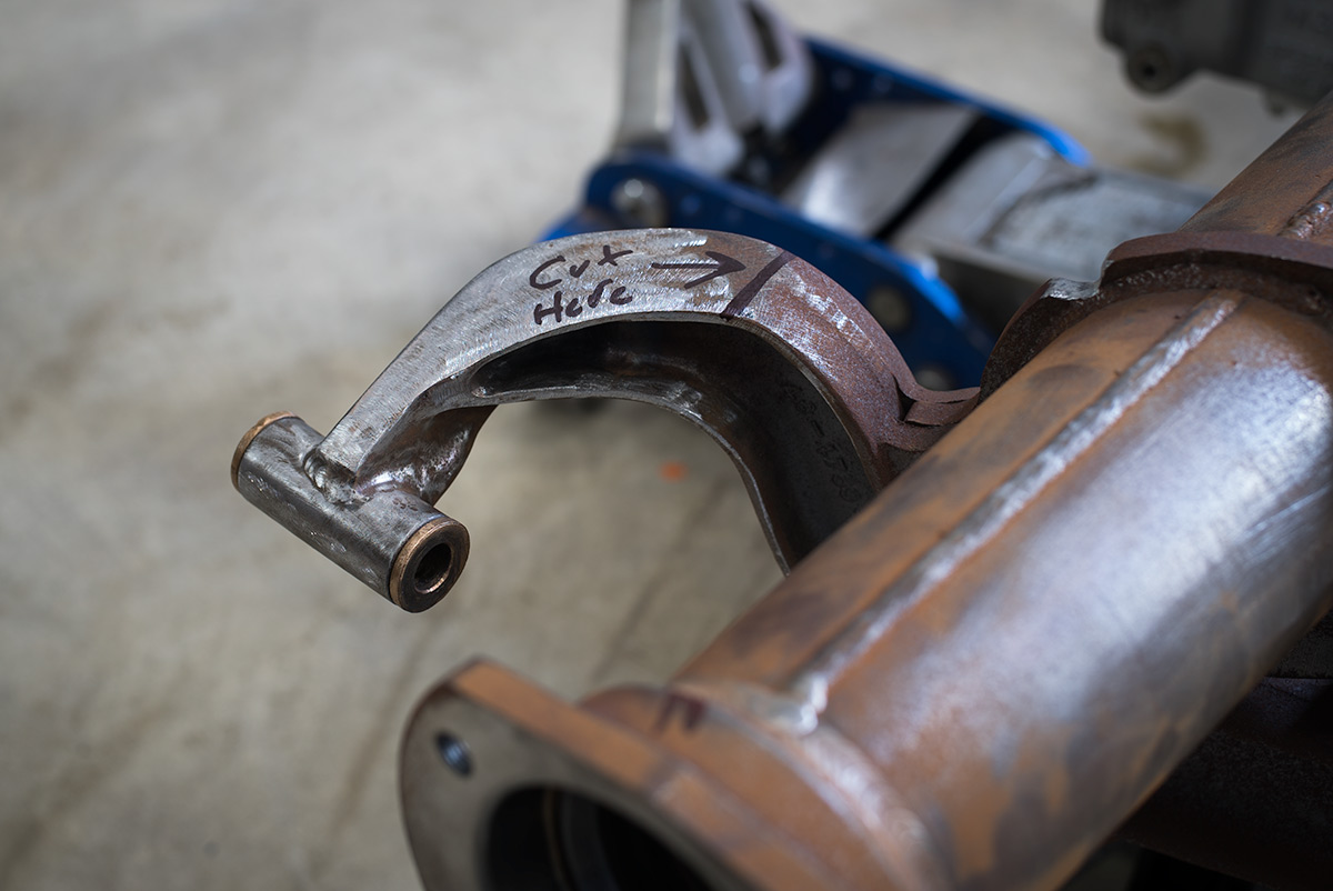

    In any case, today wasn't all that productive. The only bummer about working out in the country (and really, in Austin in general) is that getting steel is a serious pain in the ass. Today, Keith dealt with that pain... and got steel.

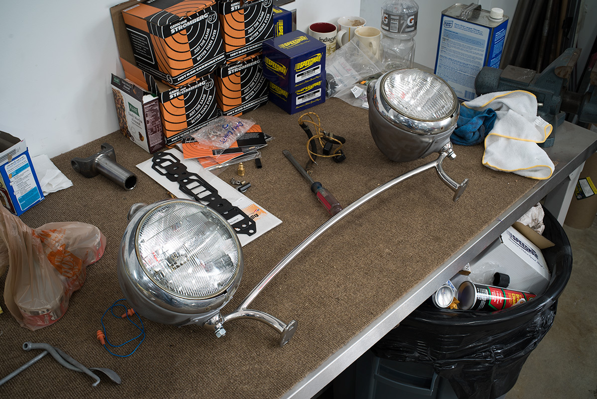

    In any case, John mentioned something about a headlight bar.

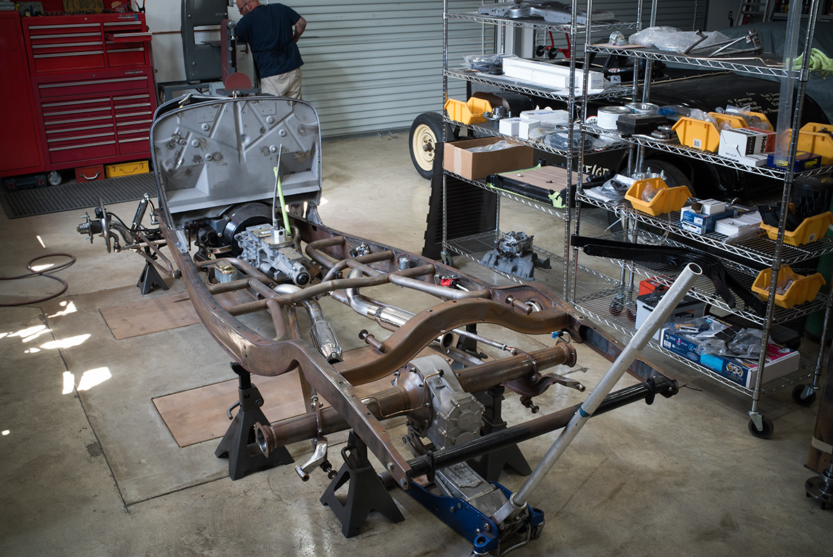

    Oh, and what about the rear spring hangers? These were one of my favorite parts of the chassis... But, some tests showed that the hangers were flexing if you put weight on them. That scared Keith, so they are gonna be cut off and replaced with something a little more conventional.
    In any case, this is how we stand right this very second:
    View attachment 2975573 [/QUOTE]
    What's the scoop on the headlight bar? Something Keith made?

  7. Acme Speed Shop
    Joined: Mar 31, 2007
    Posts: 1,755
    Acme Speed Shop
    MODERATOR
    from so cal
    The Headlight Bar is a SoCal Speed shop deal made from stainless. I think Keith made a few tweaks to it though.

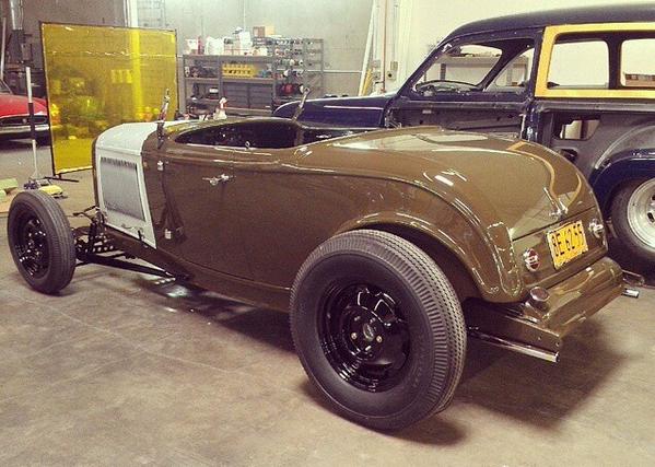

    The direction I'm leaning is this: body color will be a twist on Ford Winterleaf Brown but with a bit more green tone and the frame will be black. I'm still getting the color samples tweaked…..

    Honestly, my favorite color is on Darryl Hollenbeck's roadster. I asked him what it was and he told me it is a custom mix of his own making…something about eye of newt and dried witches tits mixed with lizard blood to get that special hue. At any rate he won't give it up so I'm trying to get my own color mix just right. I thought about stealing one of his painted bits off the car at the LSRU but every time I saw his car there was a crowd of people looking at it. (I would have returned it after matching the color).

    Something like this is what I'm aiming at.

    This is the color I'm pulling for too...
