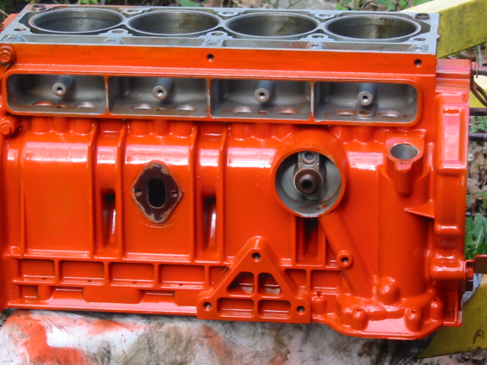

    The shape of the gasket is really the same as Ford 460.
    I am not worried i´am confused about the design.
    In your case it´s not a problem. In my case with 30 psi boost it might be a problem with pressure in the crankcase.
    Anyway It want be a problem. I was just wondering.
    I think I just machine a narrow slot on the block to get a edge for the seal to grip. I also think it will be a nice transition to the headgasket.
    again thank you Dennis // Johan

    Could one of you post a picture of the area you are talking about? I'm trying to understand.
    Thanx,
  3. Johan, you would be best off without much crankcase pressure, if it becomes a problem, you can increase the ventilation. Some older vehicles had a breather from the lifter gallery so pressure could be released directly there.
    Be careful about the water jacket sealing surface inboard from the one with no gasket as it is a known sealing problem area on these engines.
    I see no harm in grooving the outer surface, you could put "O" ring material into it for a gasket and I hear it is available by the meter for those making special "O" rings that are spliced to complete.
  4. It is the upper surface at the top outer edge of the block above the lifter gallery. My orange paint ends right there.
