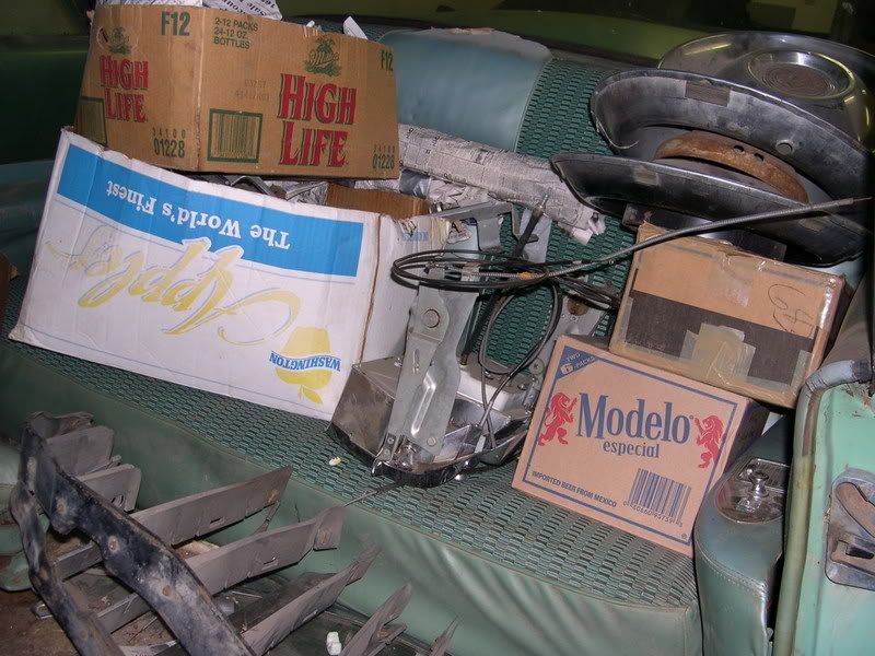

    A note here: when you don’t have every tool for every job, you make the best with what you’ve got…it worked. <br />
    <br />

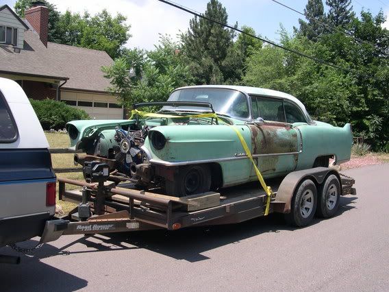

    Once the engine and tranny was out, I borrowed a trailer again, hauled the whole thing up to a sandblaster and let them go at the 50 year old crud…once back, I cleaned up the frame graft, ground off some of the crap, mig welded up some spots to add a bit more strength to it and then cut 1/8” plate in order to fish-plate the two frames together…and then TIG welded all of it together I might add… <br />
    <br />

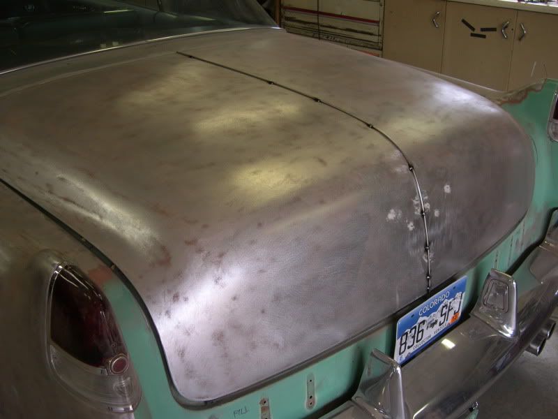

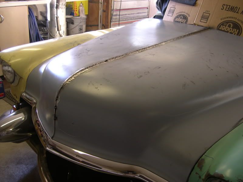

    I welded in new panels (allowing a ½” opening at the bottom of the firewall/air box -- each side) for the outside air ( as well as rain, wash water, snow, etc) to continue the flow in to and out of the openings under the windshield stainless. These opening were used to force outside air into the heaters (one on each side of the interior). Blocking these by welding them shut would result in rust, eventually – when -- not if -- they filled with water and debris. <br />
    <br />
    [​IMG]<br />
    <br />
    It took a couple weeks worth of welding, bondoing, sanding and priming to get it correct and flat…and then priming and painting it yellow (color choice at the time)…but I think I’ve since changed my mind!. I don’t think I can deal with that much chicken-fat yellow every day and all the time. This car is not small…it has acres of sheet metal. <br />

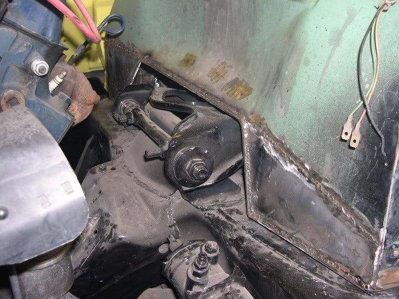

    As you can see, sliding the motor/tranny onto the ’78 Trans Am sub has the front of the car sitting a lot closer to the concrete…and that’s the way I like it. Wait til I get the front bumper brackets built and get that 200 pound Dagmar unit mounted…!!! <br />
    <br />
    [​IMG]<br />
    <br />
    After I was satisfied the firewall was “close enuff for the girls I go out with” (not that they’d care if it was off some anyway) and the body was mounted on the frame ‘close enuff,” I turned my attention to the “next” thing in line…Brakes. <br />

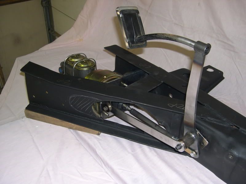

    Back to the problem at hand…I knew I wanted a power booster on the brakes…big cars need help stopping…in my crazy way of thinking and building a car, I went to the junkyard, had them cut part of the X-frame/main frame section out of a ‘55 four door and I built a dummy master cylinder/booster mount out of sheet metal (not shown) for the new 7” Master Power booster/Corvette master cylinder. The photo below is an “after” shot and that’s the stock Caddy pedal showing there. Having to NOT work on my back, under the car sure made building the dummy mount easy, and to be able to see exactly HOW it would work mounted to the frame… <br />
    <br />
    [​IMG]<br />
    <br />
    I then had it cut out of 3/16” plate, formed up, complete with stock brake pedal and had it all TIGed together, sent it out to be powder coated silver and hung it in the stock frame…under the floor of the Caddy…fits nice…hope it works as nice.<br />
    <br />

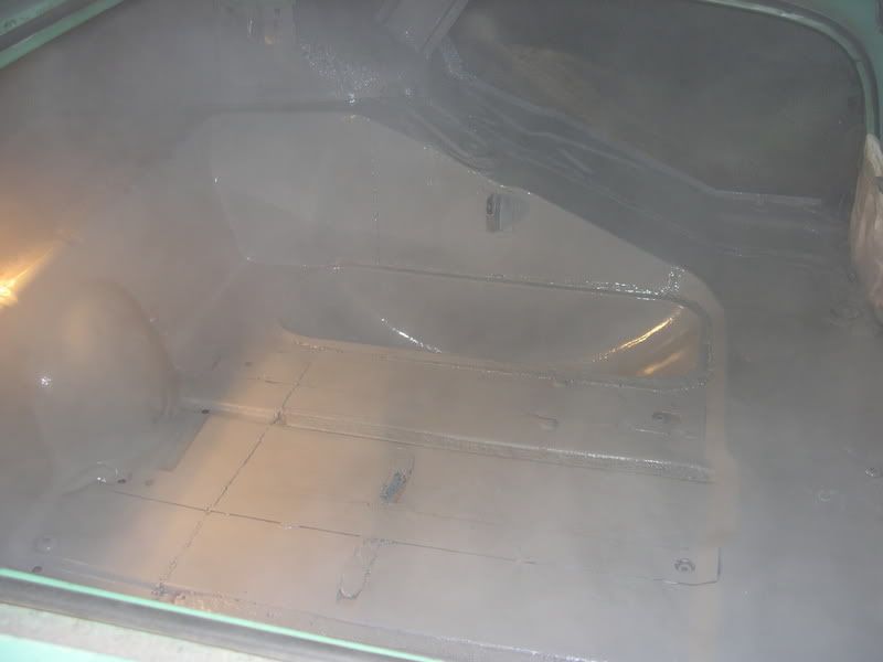

    Lizardskin is easy to spray, stick a heater hose tube in the 2-gallon bucket, attach the air hose to the gun and spray away (oh, you need to use a body schutz gun, tho)…credit card thickness is all you need. I used one 2-gallon bucket on the interior. Here I am shooting the roof of the Caddy…oh, and wear a cap and or glasses of some kind…the stuff goes all over.<br />
    <br />

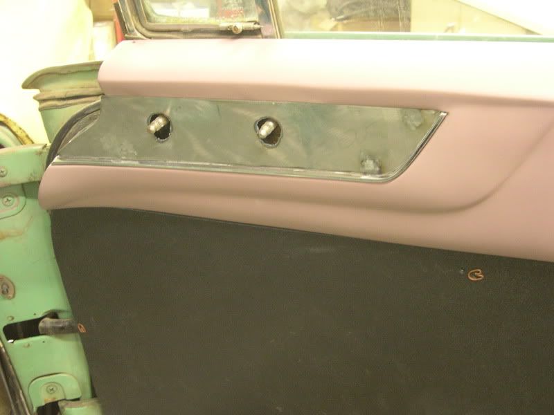

    I then sealed and primed the dash, and all the window trim and door panels…and painted everything white…the interior will be two-toned (and NOT chicken fat yellow it was decided -- for the final time), the bottom of the dash will be white and the top of the dash and most of the door panel trim will be another color (to be determined…!!!)<br />
    <br />

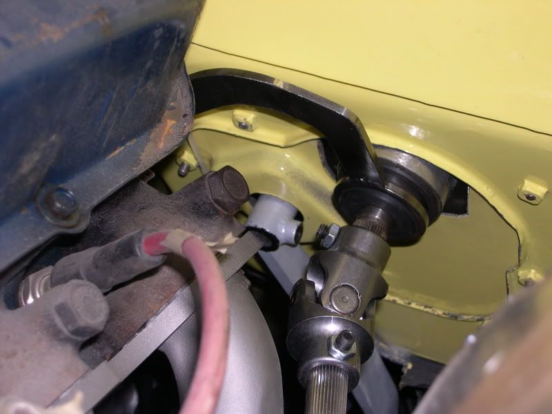

    Then I had to figure out how to mate the new steering column to the Trans Am power steering box. U-joints&#8230;yeah, Borgeson u-joints&#8230;the best there is&#8230;can&#8217;t take short cuts here, not with steering&#8230;so I spent some cash and got the right stuff&#8230;here you can see how I had to snake the u- joints around those headers. They work great and are smooth. It may look like they touch the headers &#8211; it&#8217;s close, but they do not touch.<br />
    <br />
    [​IMG]<br />
    <br />

    Here&#8217;s the woodgrain trim on the door panels&#8230;should be OK looking once I get the rest of the dash done.<br />
    <br />

    and then I moved to the trunk...I used 3/16" round rod for this...figured I'd just as well get this done too...<br />
    <br />

    Thanx VonBurke, I'm making minor progress...just working the body...got some minor dings and dents taken care of and in sealer, got that big "hole" in the driver's quarter filled with good metal (not much to see there so no pix of it). It took some work to rebuild the inside of the pillar and the hurt part of the pillar inside the door...but got 'er done...
    Also filled the license plate indent in the panel below the trunk and put it in sealer...
    And one of the skirts is all one color now...(that big hole is still shown in this photo....!!!)
    Door handles are off, peak of the trunk is done (you can see that in the first pic posted), took some half moon dents out of the top and I think it's all done now (not much to see there)...so I think it's ready for primer...
    I'm still working the bumper...trying to get that license plate box to look correct on the stock bumper...and that's taking some real work...!!!
    That's about it for now...
