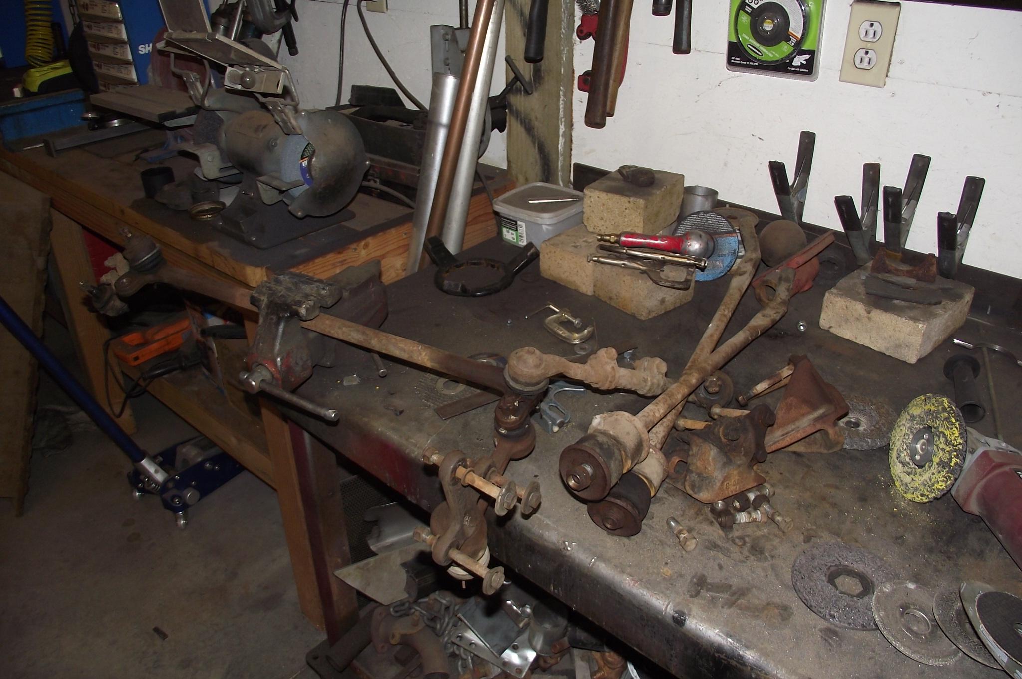

  16. Started surveying the car to compile a list of things to do on it, probably the first few things are to figure out where the P/O was going with the electrical, and clean up the engine bay. Looks like it still has the small springs in front and they are sagging, also I don't recognize some of the steering linkage. I do have a parts car with all the V8 stuff still intact so if need be I can just replace everything.

  23. I cleaned things up and gave the little car a good looking over. Lots to do mechanically and to the electrical, what the P/O did twenty six years ago doesn't quite work for me, so in to the shop comes the parts car, (over the years I've collected up quite a stash of 64/65 Ranchero parts) and off comes the front suspension and the engine compartment wire harnesses.
    The front suspension and steering linkage has a few pieces that I don't recognize to be for a V8 Falcon and the toe on the front wheels changes radically with the ride height so I will change out the cross link and tie rods to what should be under there and while I'm at it strip out all the good parts from the parts car's rusting hulk and dispose of the rest.

  27. It has taken a while, but I've got it cleaned up, stripped the wad of wire out of it and started putting the correct looms in, replaced the 8.8 rear axle with the proper axle for the car, and installed the correct steering gear and steering linkage along with new upper and lower control arns and ball joints.

  29. I know it was a while ago, but I don't see where it was mentioned/addressed. Post 16, the 3rd pic. The brake proportioning valve is higher than the master cylinder. I thought that was bad juju.
  30. Thanks for noticing. Everything about this car is juju, all that and much more has been or is in the process of being set back to stock. The brakes are drum/drum so that valve is really not needed, it's in my scrap pile now along with the too wide shoes and mismatched drums and all the six cylinder suspension parts.
