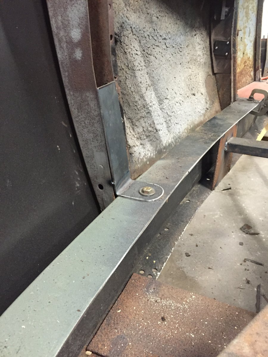

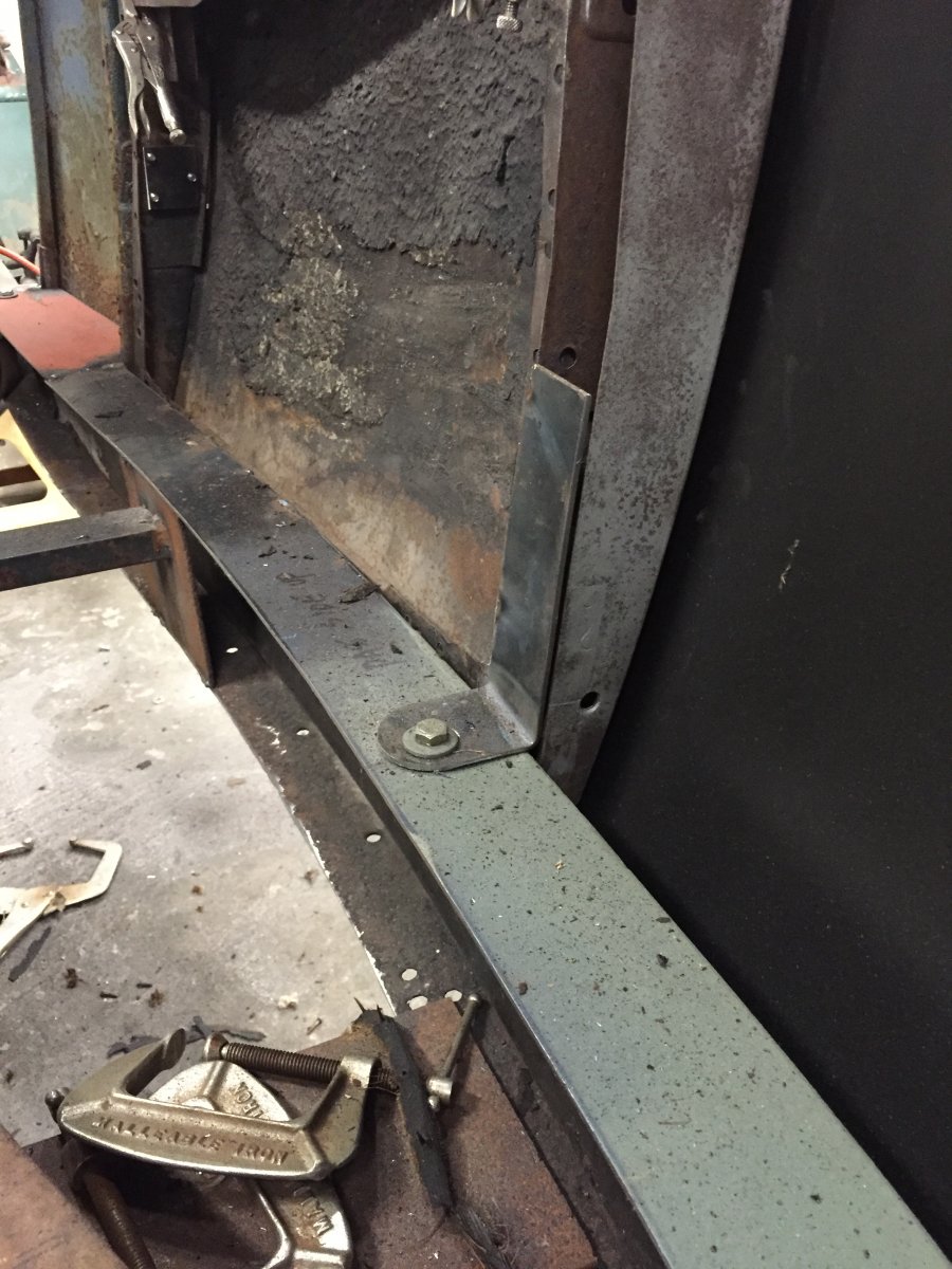

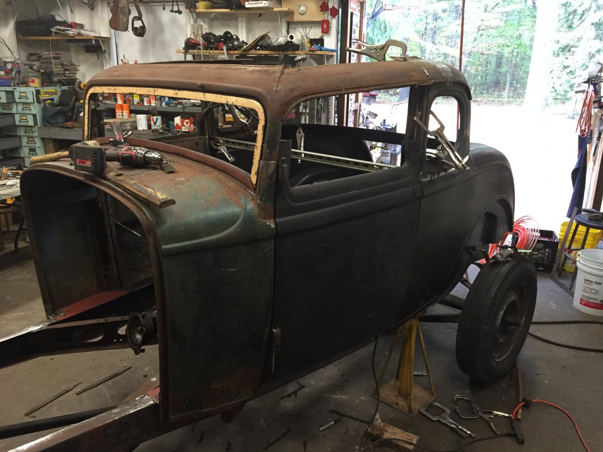

    image.jpeg image.jpeg Took advantage of the fantastic weather today. Was able to slip in to the shop for the day.
    First thing was to make some B-pillar feet and get them tacked into place. I hung the quarters than clamped them in place.... After hours of finagling I got them to a point I could live with.
    Since I had no idea where the tops of the pillars should be I called the '32 guru... Howard Towne of course......he supplied me with the correct width and I popped a few braces in to hold the pillars in place while I started trimming the roof and fitting the quarter Windows.

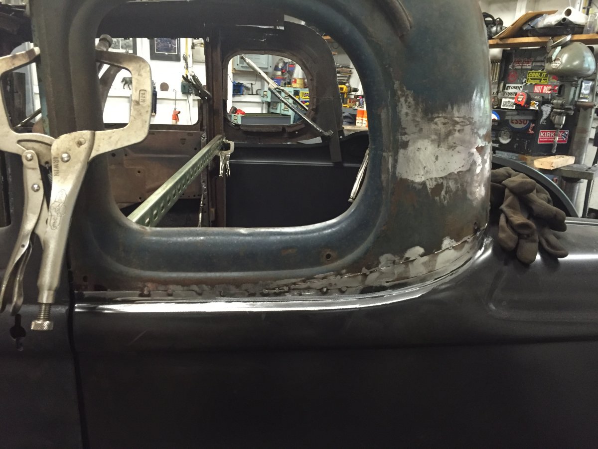

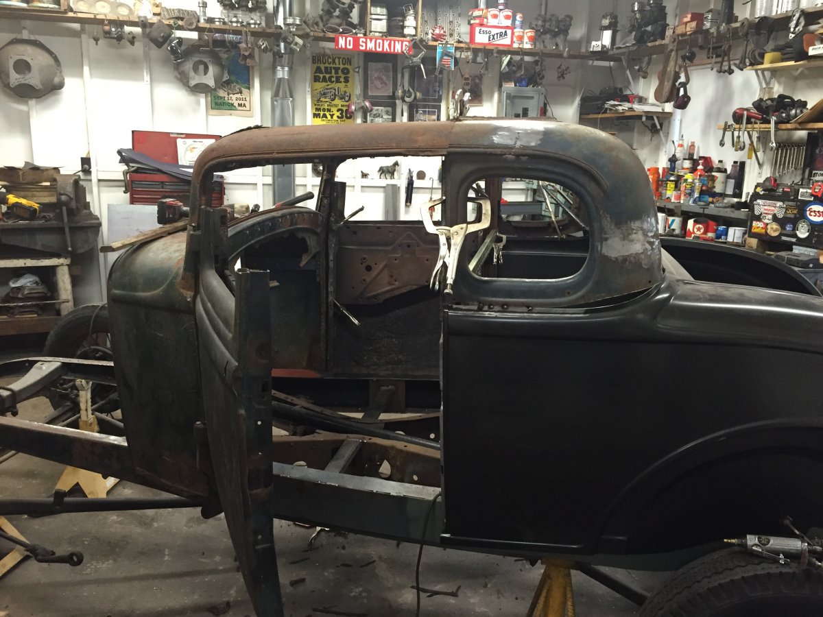

    This entire '32 roof was actually on a '34 roadster, don't ask why because I don't know.
    It was trimmed to fit the '34 so it's missing little slivers of metal here and there + it's had a very hard life. I'm just tacking everything in place for now, than I'll go back and finish weld later.
    image.jpeg image.jpeg image.jpeg Pics

  28. Nice work Pete, but why do the doors look so high?
  29. mike bowling
    Joined: Jan 1, 2013
    Posts: 3,560
    mike bowling
    Optical illusion- swing the door shut in your mind and it lines up perfectly- It's part of the Flaven Matrix
  30. Pete
    Joined: Mar 8, 2001
    Posts: 4,764
    Pete
    Yup, what mike said.
